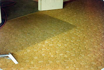

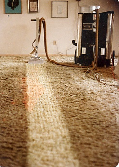

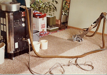

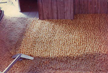

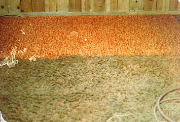

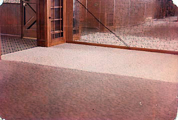

I have a similar experience. In 1970 I just used a carpet extraction chemical through the equipment. No pre-spray. These pictures are the results.
85EFD0B9-2D38-4BFC-A575-F21EC5AAFC4E.jpegE2037F25-5C89-452A-BDD9-33B0E6236C35.jpeg80D0B739-A0D8-4EB2-8949-8E5454461ADA.jpeg5C90CECB-A863-49D7-AFAD-E76F2B27F98F.jpeg

I'm really surprised you're able to clean after using that wand in the pictures 49 years ago. Hats off to you Loren
that Steamway flood jet wand had some warts, (jet distortion on some cut piles) but it was a flush monster that carried heat to the fiber better than any wand on the market
and really wasn't a "man killer" to push like an unglided Ti
