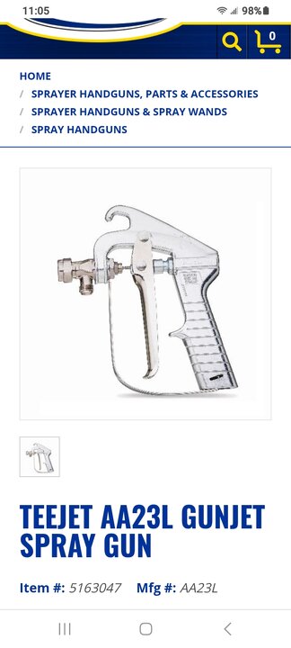

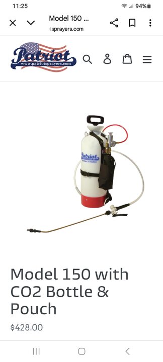

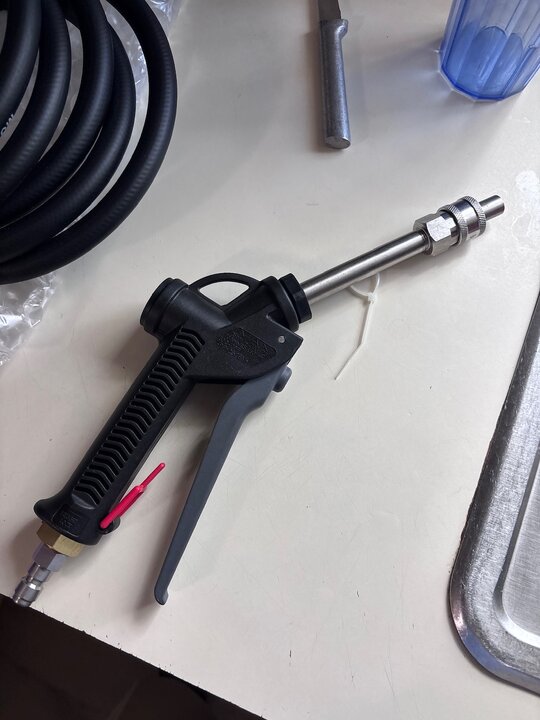

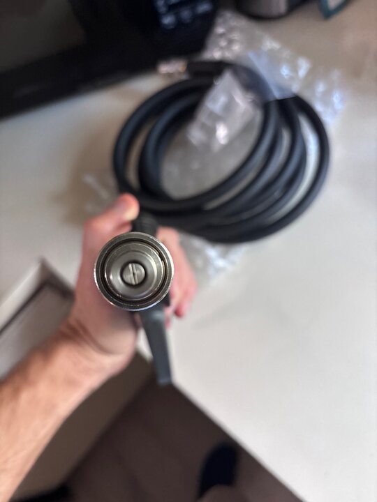

I only use an electric sprayer for upholstery cleaning. Im not happy with the cheap plastic crap that is on the market. So i made my own. First i started with a longgray 1.5 gallon pump up sprayer( they come in 1to 3 gallon sizes) . I used longray because of solid stainless construction (including the pump).and has a Schrader valve and a industrial pressure relief valve already installed . Then i wanted a professional gun with a long hose and a flat spray pattern ( not the crappy wands with short hoses found on most off the shelf)so i robbed a 10' ⅛"hose off an older hydraforce pump up and added a quick connect and a spraying systems teejet gun. For power i used a $48 rechargeable compact air compressor from Costco to hold the compressor security on the sprayer i bought a paint ball co2 tank holder off an patriot sprayer. I got a lay flat usb c charging cable so i could leave the compressor in the holder and with that i have a great sprayer it's been in use for 5 years trouble free so far. And should something happen to the compressor i can still use the hand pump as a backup.If you want a truly great off the shelf sprayer that maintains constant pressure and you don't mind spending 400.00 + and you have a paintball co2 refill store close. I would recommend looking in the patriot sprayers. They are used extensively by concrete dyeing companies because of there stout build and ability to apply a spray consistent and even. p.s. i also add a kleanrite inline quick connect filter for extremely easy cleaning and to keep the teejet from clogging.
Screenshot_20250926_105748_Amazon Shopping.jpg Screenshot_20250926_105803_Amazon Shopping.jpg Screenshot_20250926_110556_Chrome.jpg 20230117_103249.jpg 20230117_103131.jpg 20210120_093110.jpg 20210120_093127.jpg 20210120_093110.jpg Resized_20230117_102700.jpeg 20230117_102641.jpg Screenshot_20250926_112543_Chrome.jpg Screenshot_20250926_113642_eBay.jpg

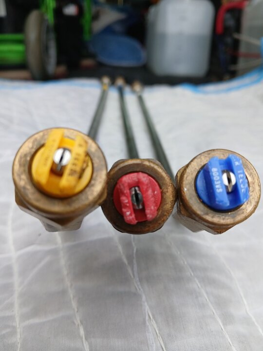

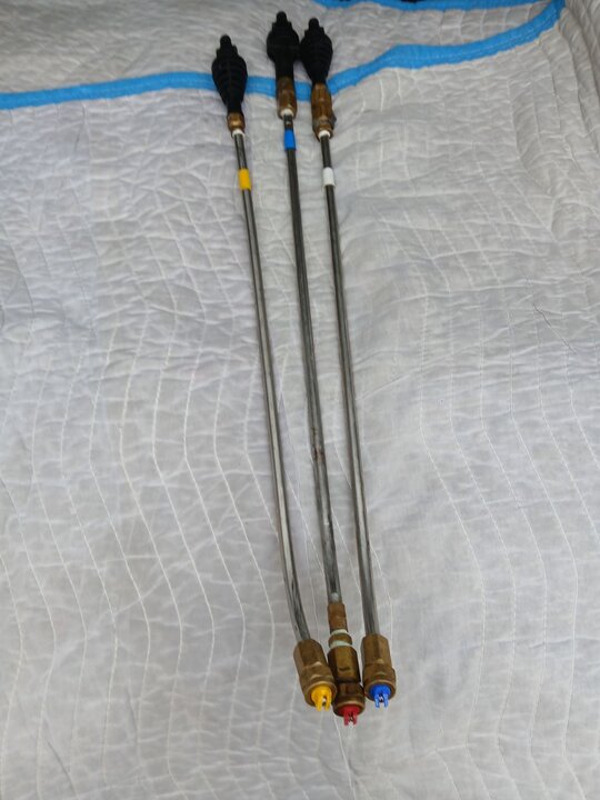

I've been using the WORX Sprayer for many years with the VLM Method. It does get more product up in the air that travels to adjacent rooms that can be a problem
WORX puts out more product so you can use a smaller jet
I rarely use 8004. You don't need a 8004 unless you move very fast. Only time I use 8004 is for HUGE rooms so I can move faster or sometimes on TRASHED carpet. It's way too big for steps. Your wetting the carpet too much
I use 8002 the most. 8002 for average size rooms doing one room at a time. You do need to move slow. I prefer to move slow and get less product up into the air especially in occupied homes.
8003 is for heavier soil or big rooms
Of course what encap your using also matters. Some encaps have more odor or bother people more than others

The 8004 does put out an amazing amount quickly. I just move fast. Takes just a few seconds to spray a flight of stairs from 3-2 or 2-1 compared to the Scott sprayer I was using. I find the 8004 atomizes less than the 8002 so you don't have as much in the air. I normally use my Hydro-force when doing hwe but am finding the WORX is even faster.
