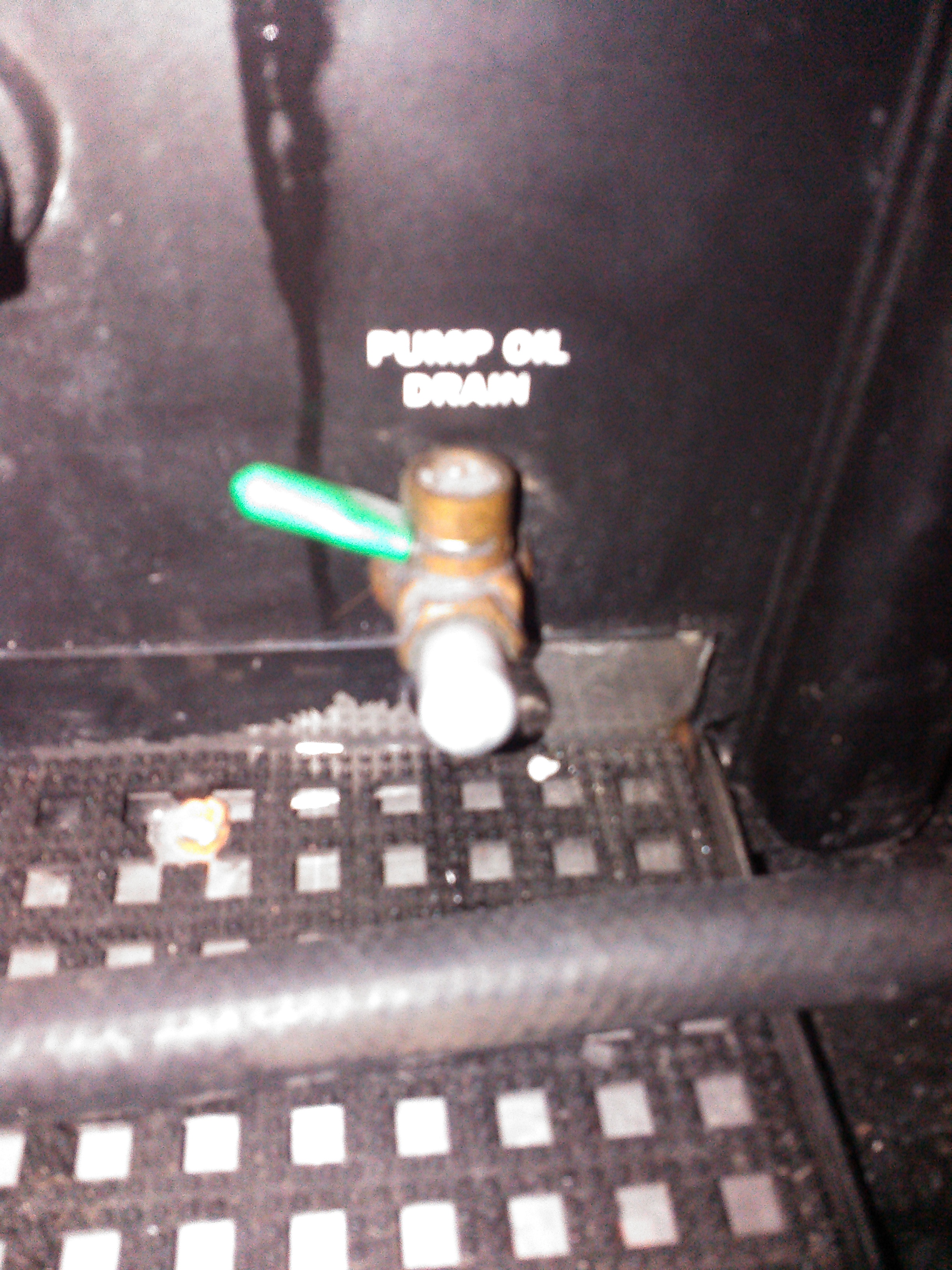

CDS units have drain hoses that exit behind the passenger seat. Anyone that has an older unit with a drain hose should check and replace if it gets stiff. It can crack and drain your blower while you're working.
