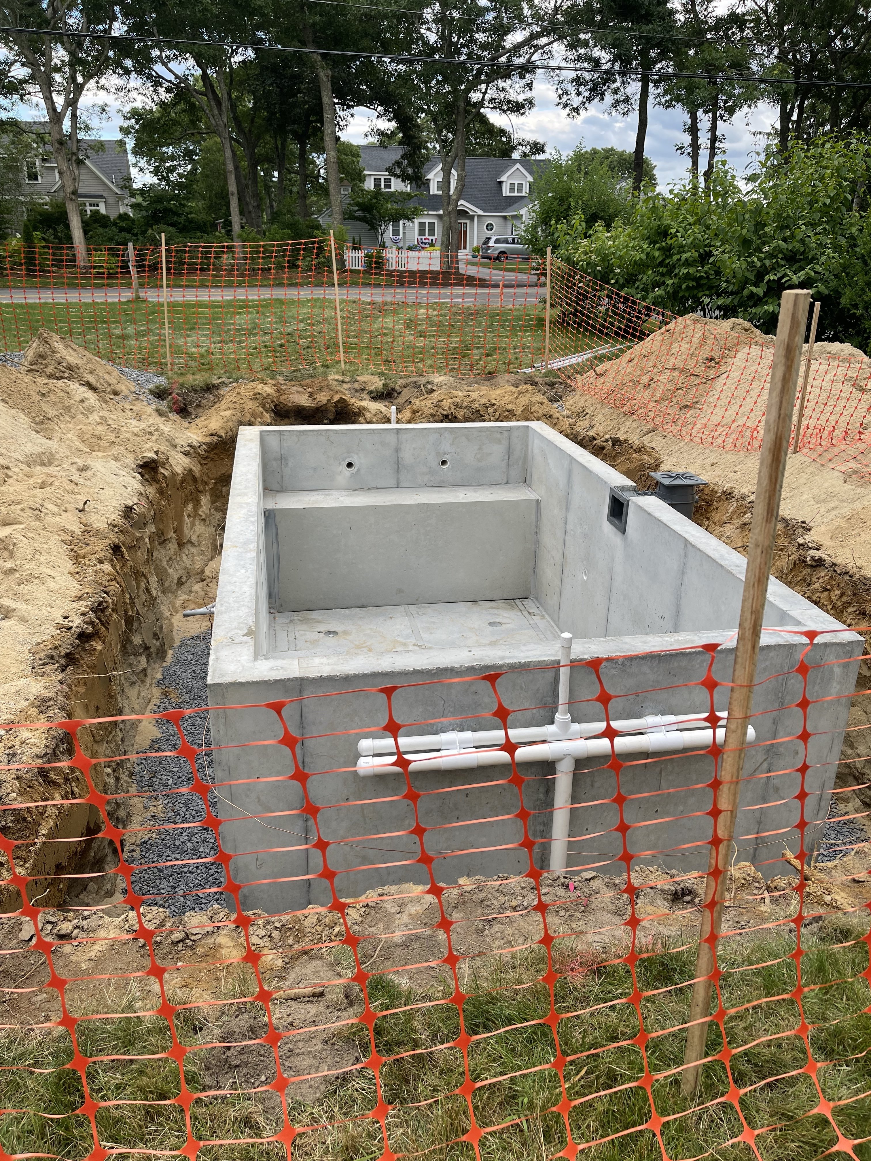

They installed my 7x13 heated jacuzzi today
I’m exhausted
