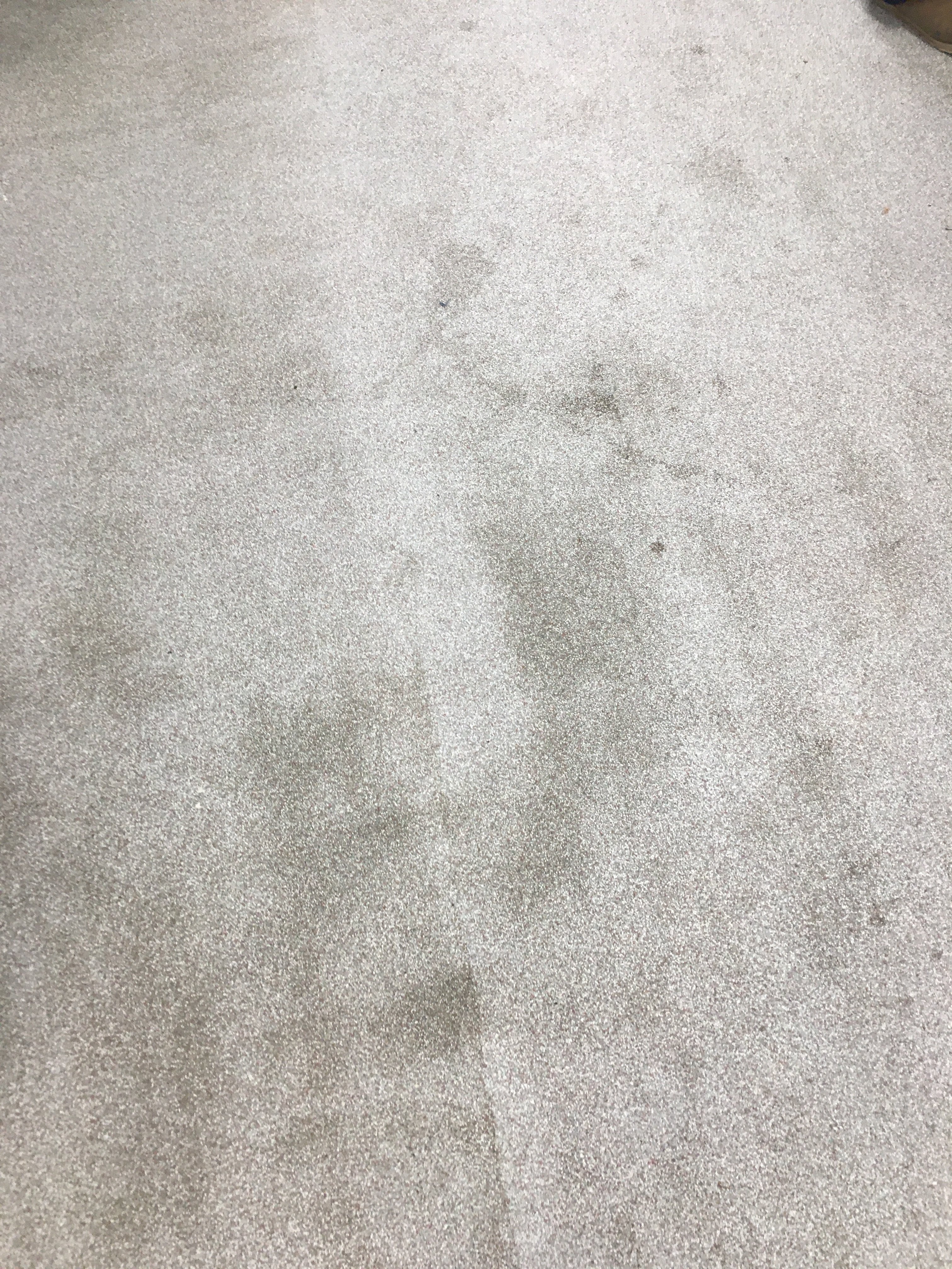

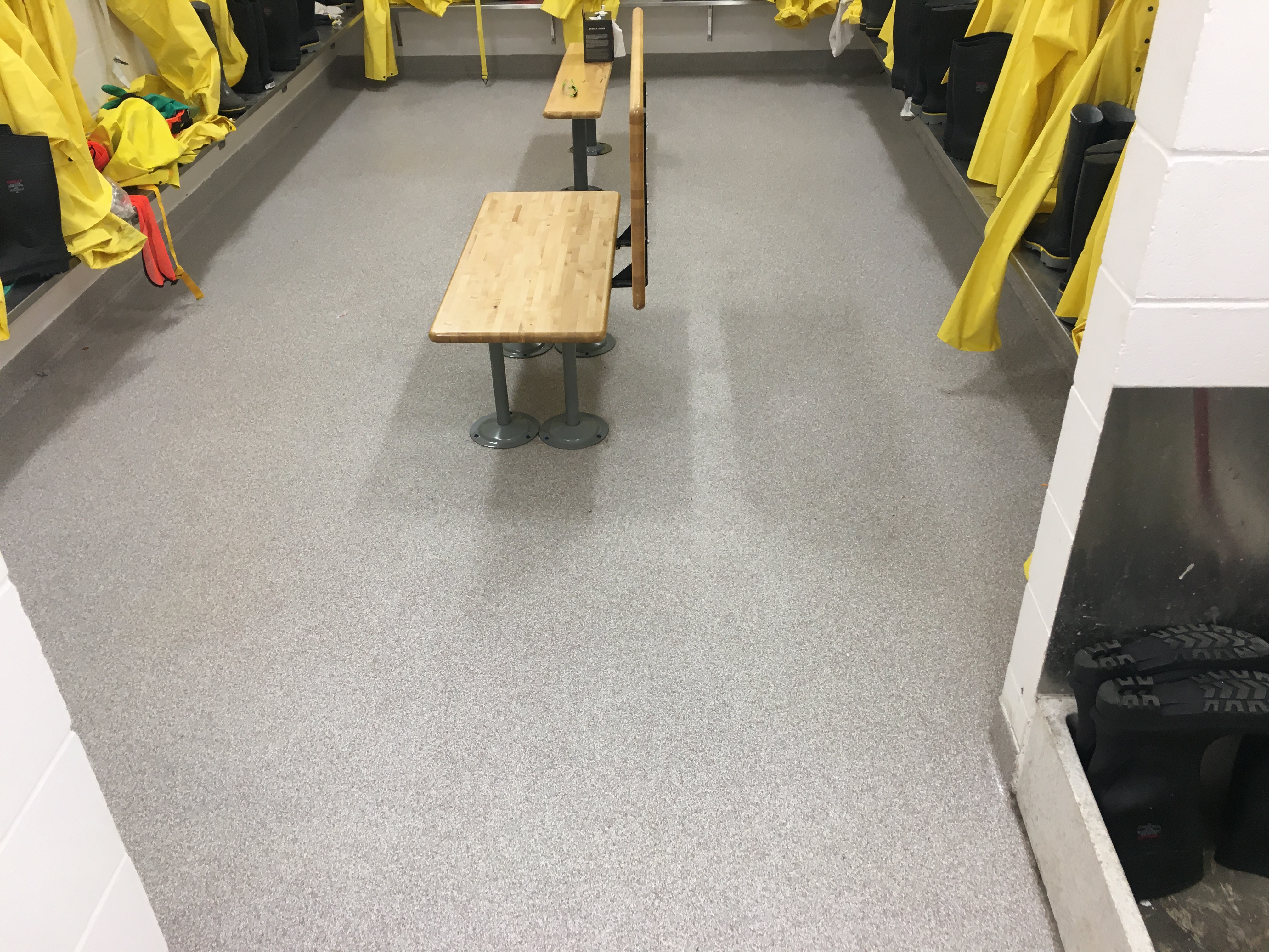

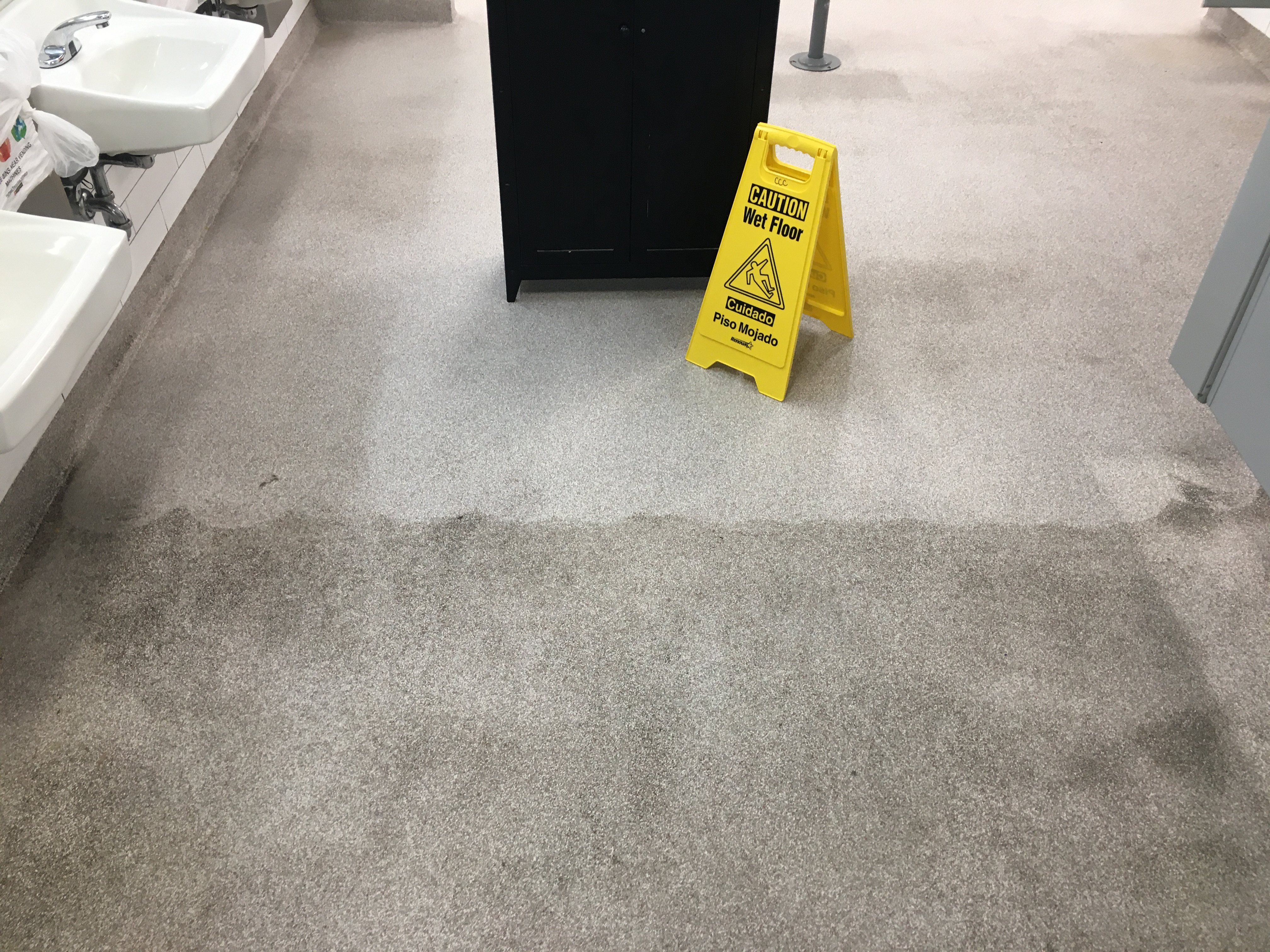

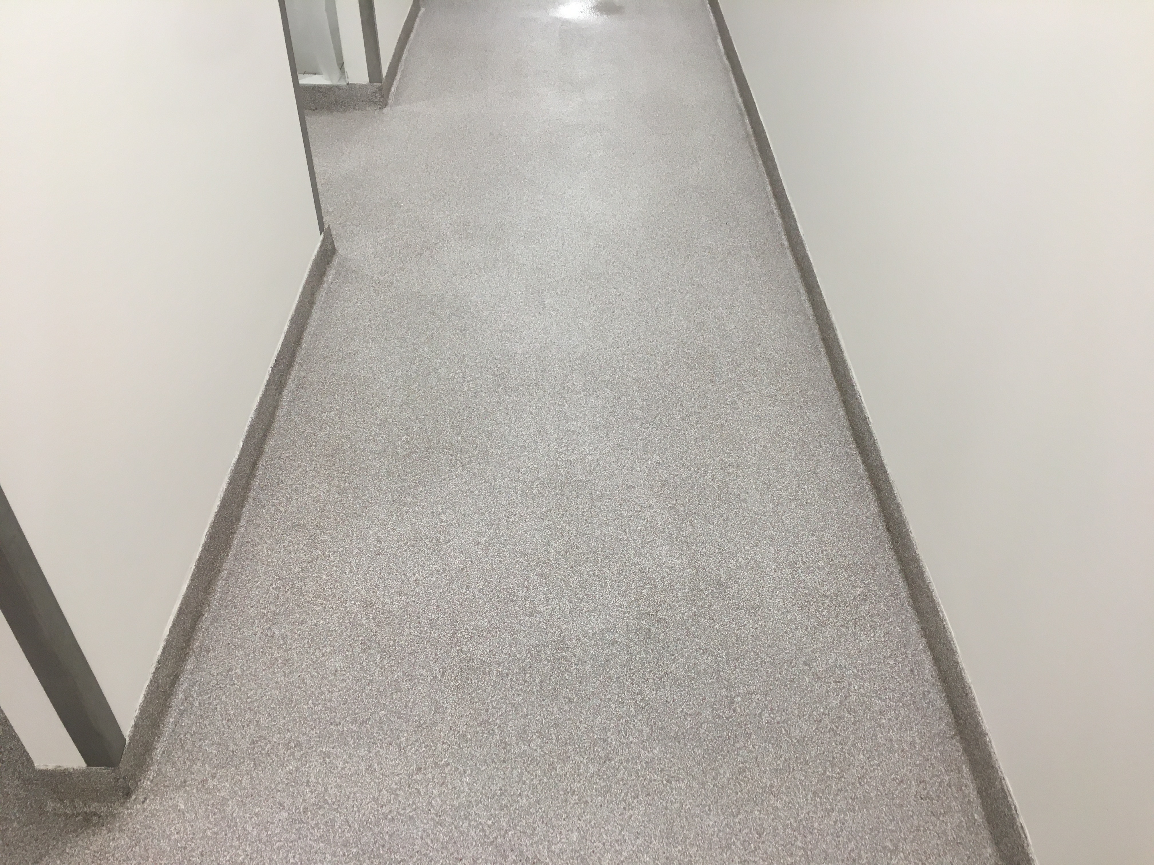

Did about 6k sq ft of epoxy bathroom floors yesterday. No sweeping or vacuuming. Just spray treatment, and th-40 it off at 1300-1500psi
