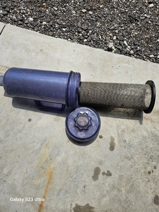

I had a clean out installed at my house close to my driveway that I dump in now. I use those blue plastic filters as I dump. It solved the issue again.
I have floor drains in my shop that I had built a few years ago but haven't hooked them up to anything yet.

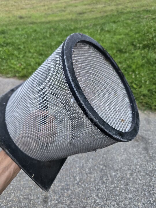

I don't know what the blue plastic filters are. All my recovery water passes through this screen. Are you filtering it through something finer than this?

Probably similar. But not as clean.
