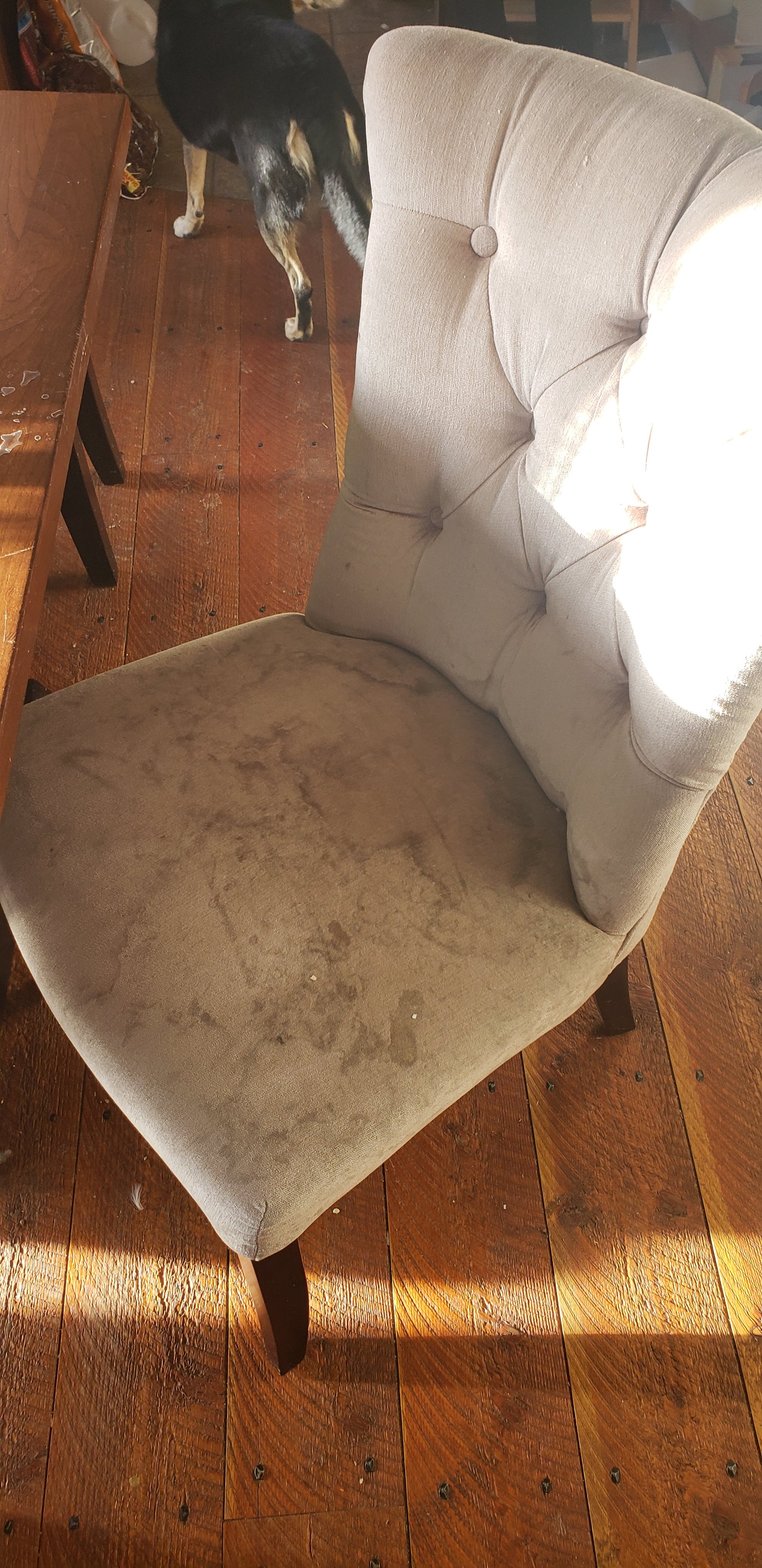

A horse hair brush isn't going to cut it for this project. I'm thinking some of those brush attachments for a drill. 87165

The chair looks like it was ‘attempted ‘ to be cleaned by someone. It doesn’t need some fancy-schmancy 2000 dollar machine. It needs a good quality uph cleaner, boosted with a little ammonia if need be, scrub it with a bonnet mit, followed by a good rinse acid side, speed dry.....

The chair looks like it was ‘attempted ‘ to be cleaned by someone. It doesn’t need some fancy-schmancy 2000 dollar machine. It needs a good quality uph cleaner, boosted with a little ammonia if need be, scrub it with a bonnet mit, followed by a good rinse acid side....
BTW, when you are putting you’re cleaner on, avoid the buttons as much as possible, they may be metal, and might rust. Not only that, the top left one is almost ready to come off...
The owner actually has cleaned it before with Dawn dish soap. :dejection:

I see the chair now
if poly fabric, it might clean up better than you think
that's food stuff on there, not body oils.
Let me raise an indignant eyebrow from upl gurus and suggest you hammer it with a heavy hitting enzyme carpet pre-spray like Chemspec Enzall

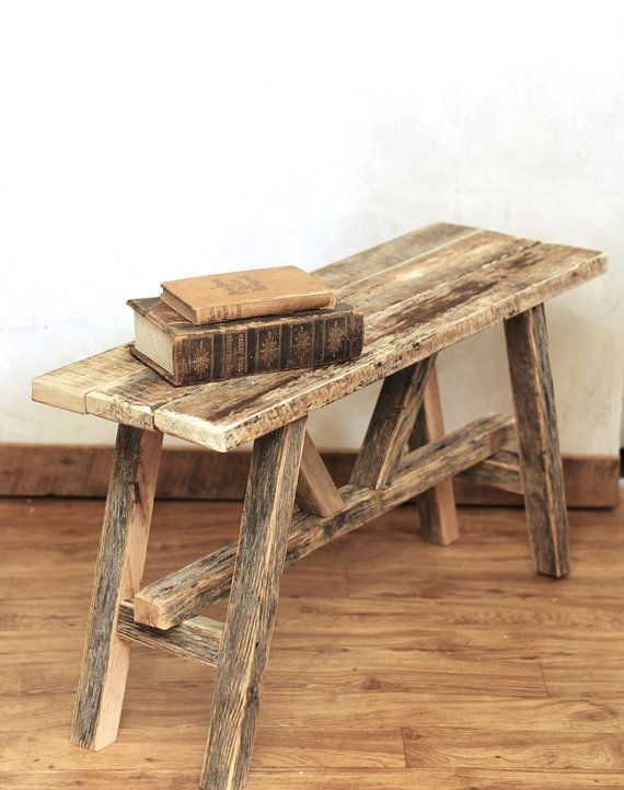

If it doesn't clean up, tell 'em to get some of these
87179
it'll go better with the rough cut BARN FLOOR look that's under the chair
