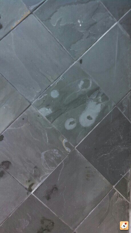

Aug 26, 2013 #1 B boazcan Member Joined Jan 11, 2007 Messages 1,522 Location Tampa Bay/Central Florida Name Bryan C Sent from my DROID RAZR HD using Tapatalk 4
Aug 26, 2013 #2 J Scott W Member Joined Oct 16, 2006 Messages 4,061 Location Shelbyville TN Name Jeffrey Scott Warrington I would suspect moisture trapped under a finish or sealer. USe an air mover or a hair dryer blowing across the surface (not down into the stone) and see if this corrects the situation. Reactions: John Olson
Aug 27, 2013 #3 John Olson Member Joined Oct 9, 2006 Messages 6,281 Location Orem UT Name John Olson agree with scott slate is void of calcium so it isn't efflorescence nor is it etching from acid since it doesn't have calcium.
Aug 27, 2013 #4 Mikey P Administrator Joined Oct 6, 2006 Messages 116,041 Location The High Chapperal Efflorescence from the thinset below Where are those tiles installed?
Aug 27, 2013 #5 B boazcan Member Joined Jan 11, 2007 Messages 1,522 Location Tampa Bay/Central Florida Name Bryan C Back patio of condo 2nd floor water side. Sent from my DROID RAZR HD using Tapatalk 4
Aug 27, 2013 #6 B boazcan Member Joined Jan 11, 2007 Messages 1,522 Location Tampa Bay/Central Florida Name Bryan C I didn't take a closeup of the spot after, but here it is after dry treat enhancer. You can barely see it left side near sliders about middle of the pic. Sent from my DROID RAZR HD using Tapatalk 4
Aug 27, 2013 #7 Mikey P Administrator Joined Oct 6, 2006 Messages 116,041 Location The High Chapperal Go back in a month (or less) and take notice.. Like I guessed before, thinset minerals...
Aug 27, 2013 #8 Mikey P Administrator Joined Oct 6, 2006 Messages 116,041 Location The High Chapperal Go back in a month (or less) and take notice.. Like I guessed before, thinset minerals...
