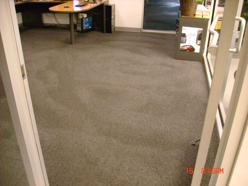

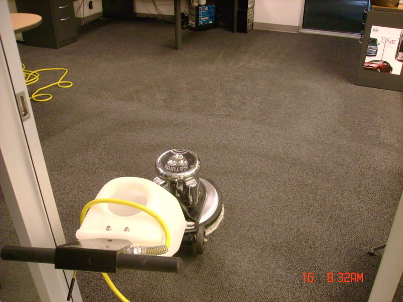

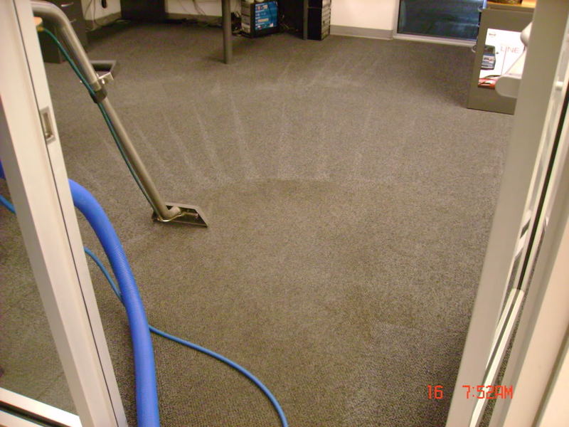

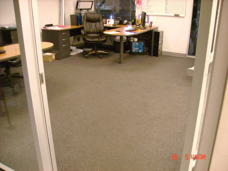

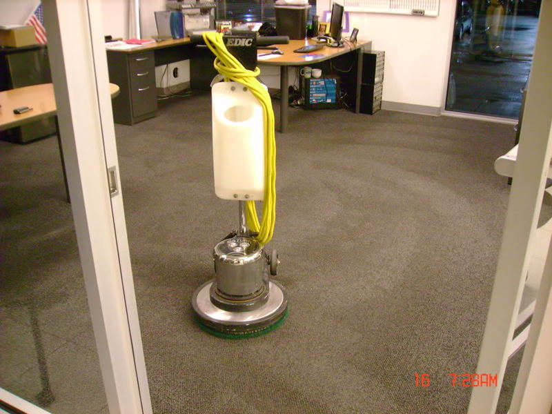

Well here are some photos. I learned a few things about scrubbing with a green pad. I tripped a breaker and the pad was wet and the carpet also plenty wet. I had to flip the pad over to the used side. The unused side was too rough. I guess the pad needs to be smoothed out over concrete. Anyways I am going back to using my brush. When the sales manager comes in tommorow and his computer doesn't work he is going to be po.
Before
A good precrub does wonders.
Look at the difference
Wow padding makes a huge difference. I used three pads for best results.
All finished and no grooming cause the cleaning ladies were coming after me to empty trash cans etc.
