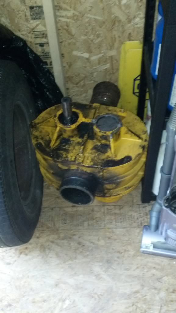

OG 6008 blower is done.
Lower seal popped out when greasing the bitch today.
and now the shaft has some wiggle in it.
My N#$@** rigged bearing fix held but I think it's time to put in the virgin blower.
