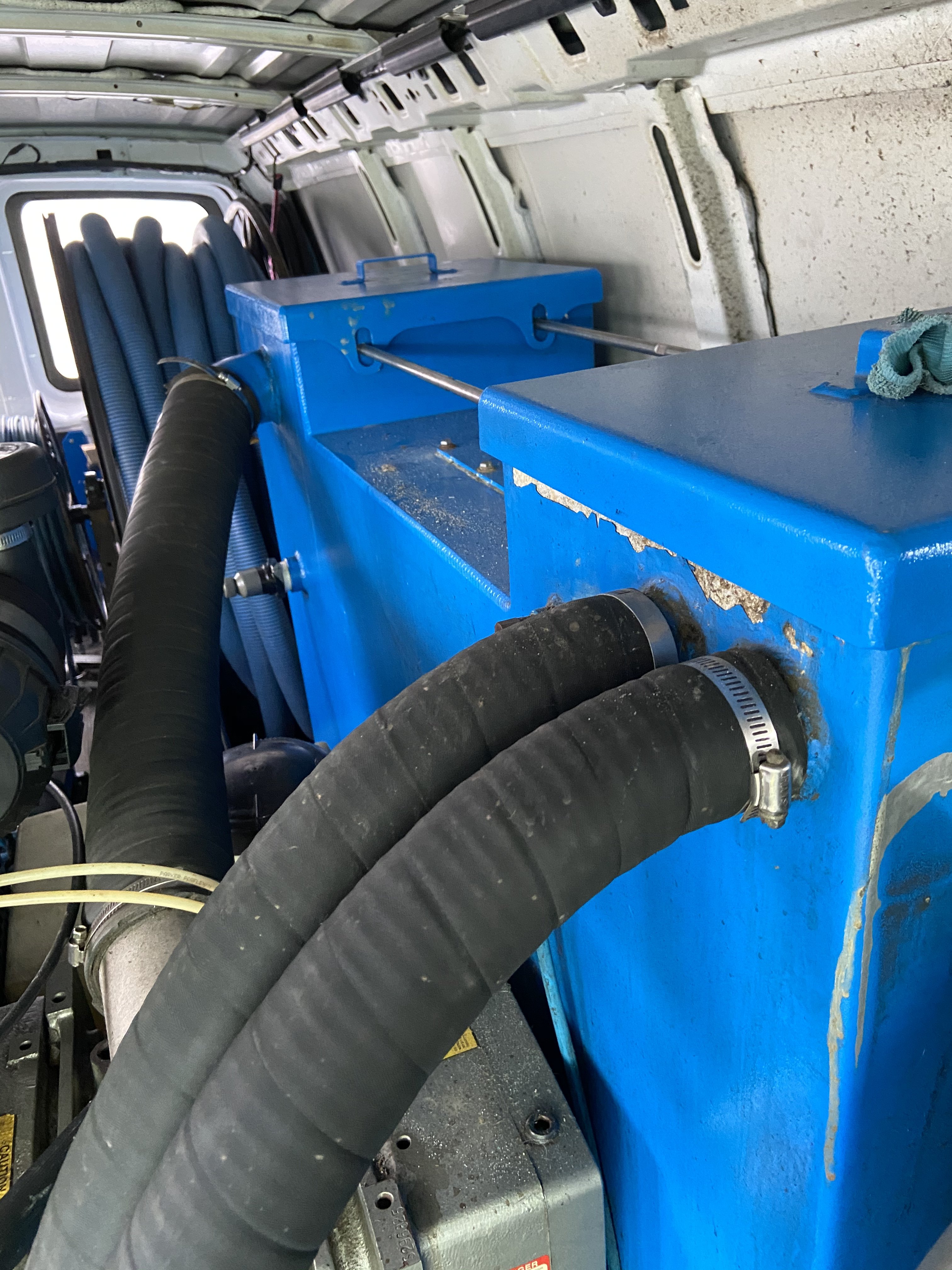

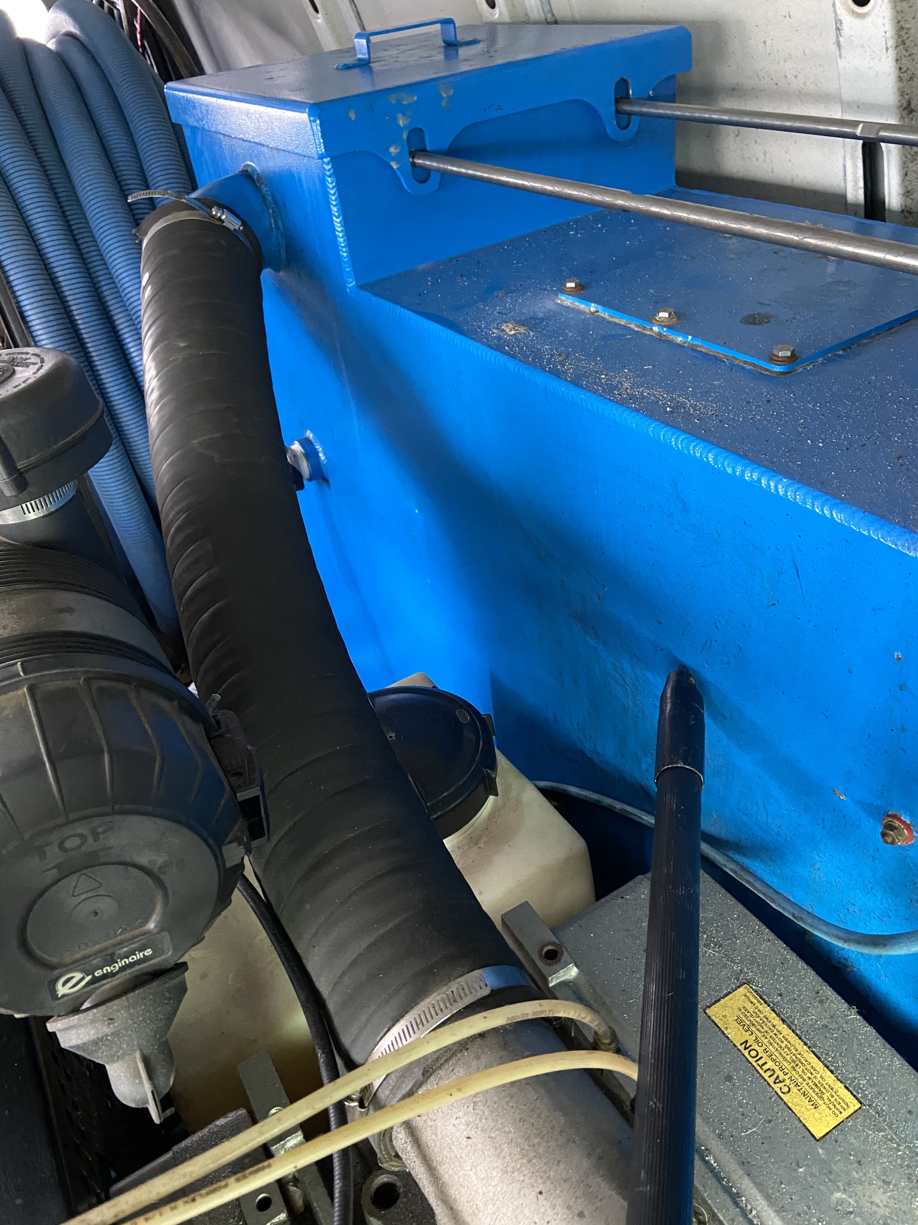

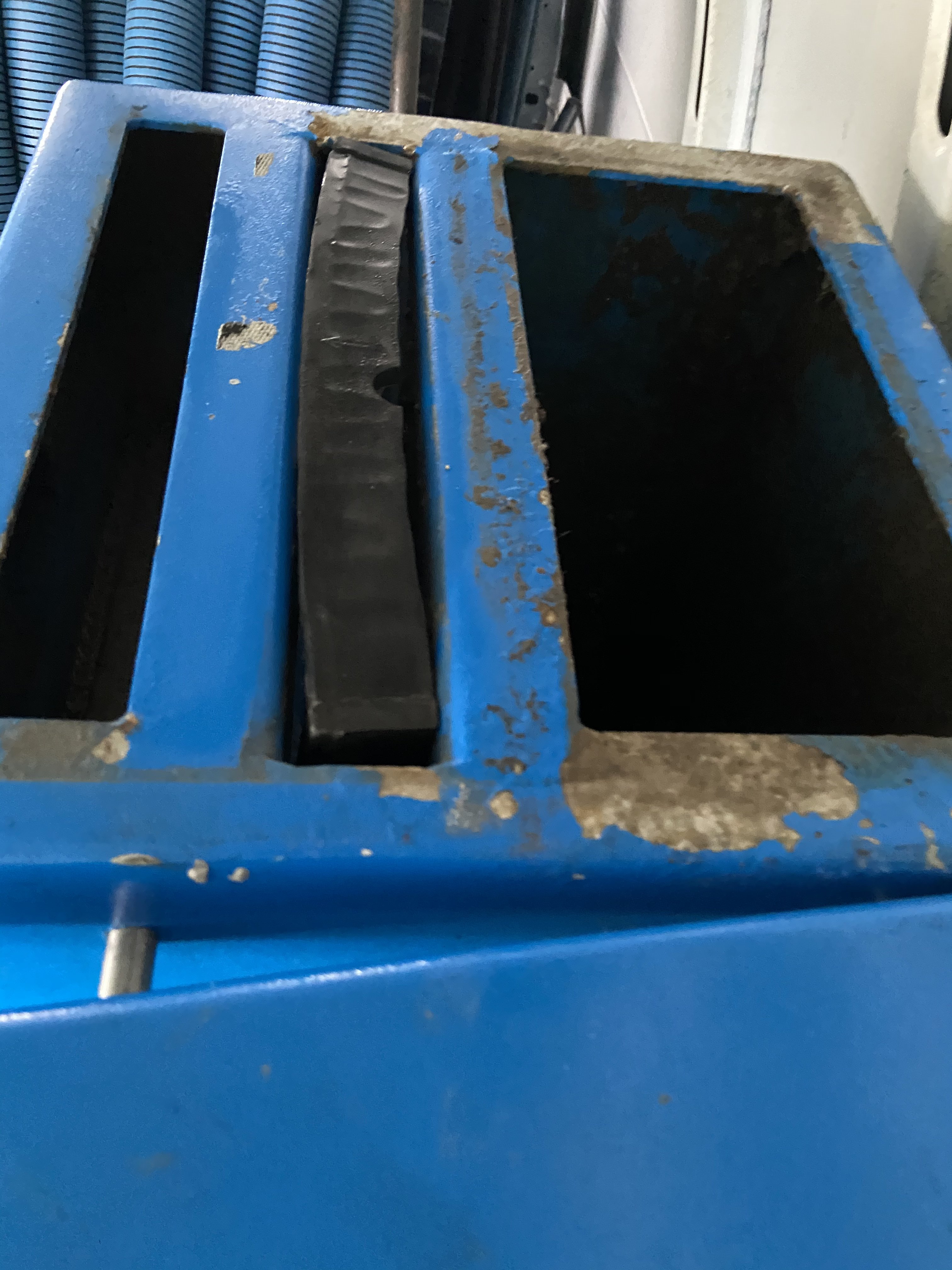

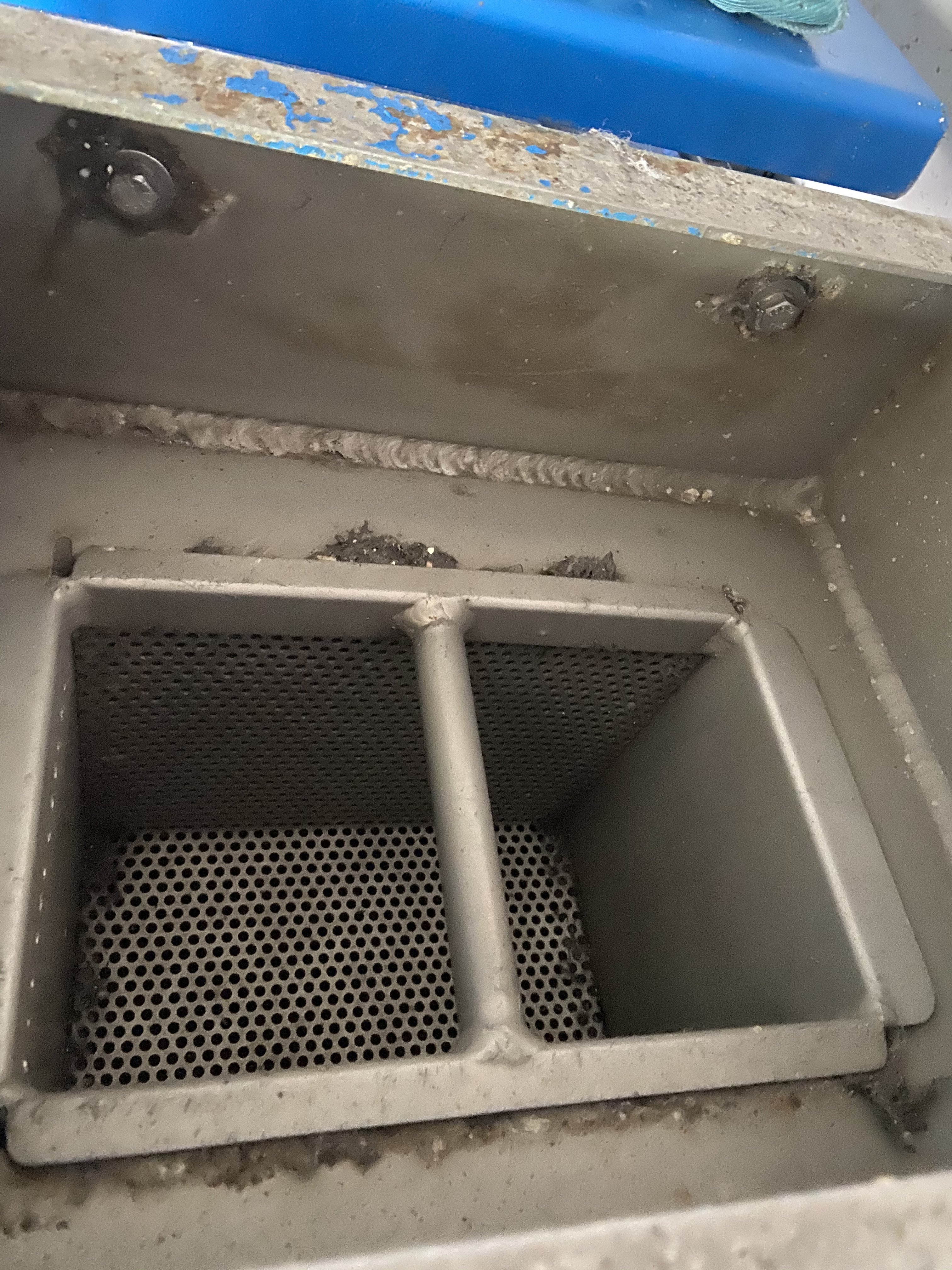

7A9AC04D-4C1B-45C5-B149-2C7A8F9512AA.jpeg 2B636595-AB1F-42E3-9F84-E10D0C3750F2.jpeg B7FC17D6-84DA-4113-828A-8BA07A6B179A.jpeg CCFB27B7-1ECC-4FDD-A3AE-0C82380F51F0.jpeg

Sounds like the extra airflow is pulling water either directly to your blower or pulling it off the bottom of waste tank. It would explain why you didn't experience better vacuum at the wand.
Just run it where it was set before. The extra Rpms will reduce the life of certain parts like belts and bearings.

I noticed on your lint basket one end is perforated and the side is not. If the other side is not perforated turn your lint basket so that the solid side is facing the outlet side of the tank. That will force the air down instead of going towards your blower.

basket is solid on both ends. More air is being caused by higher rpm which is The correct rpm for the machine. Before it didn’t suck water through the blower at the wrong rpm and now it does.
