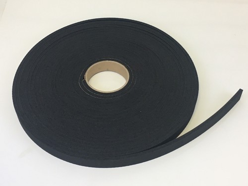

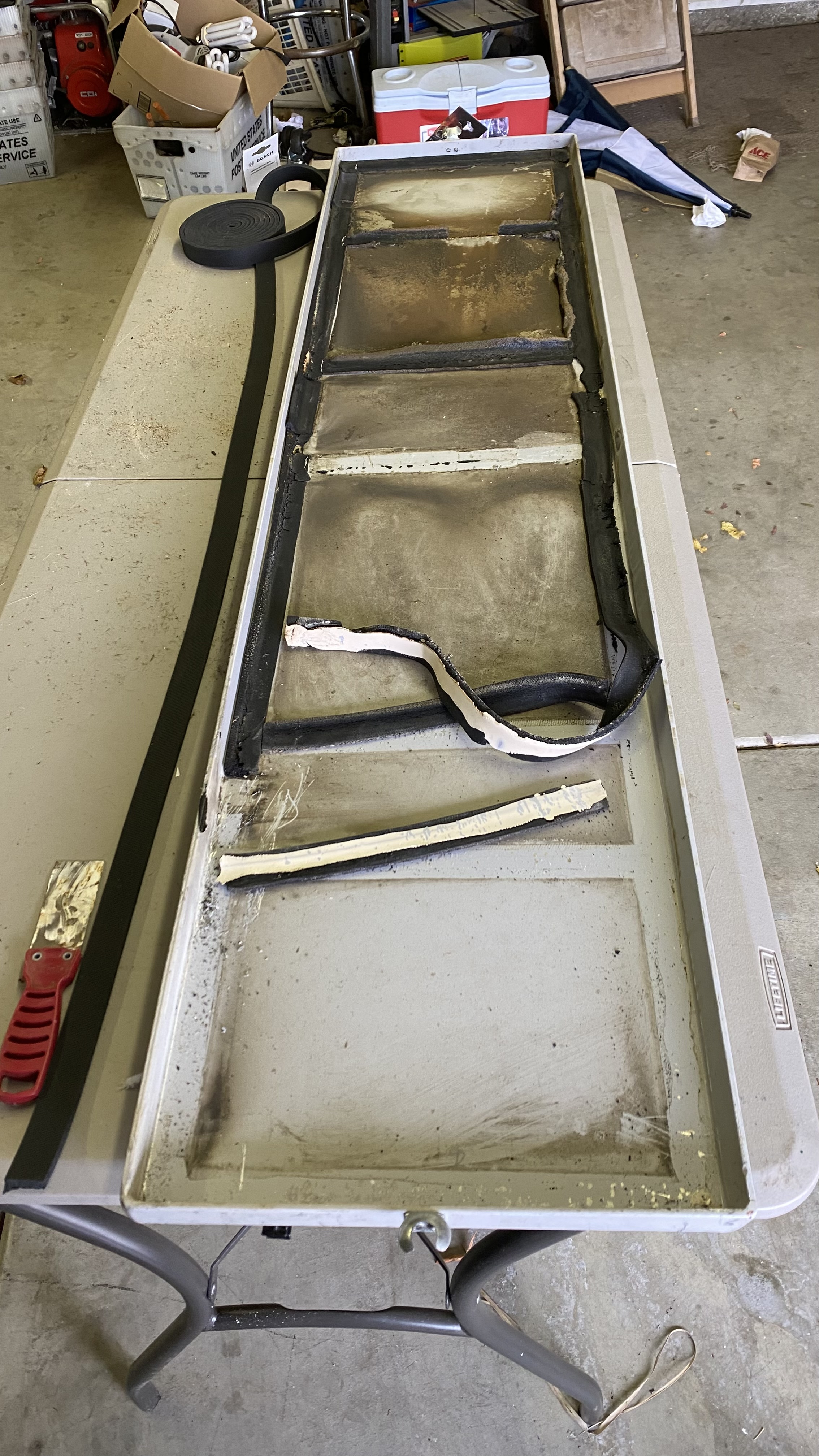

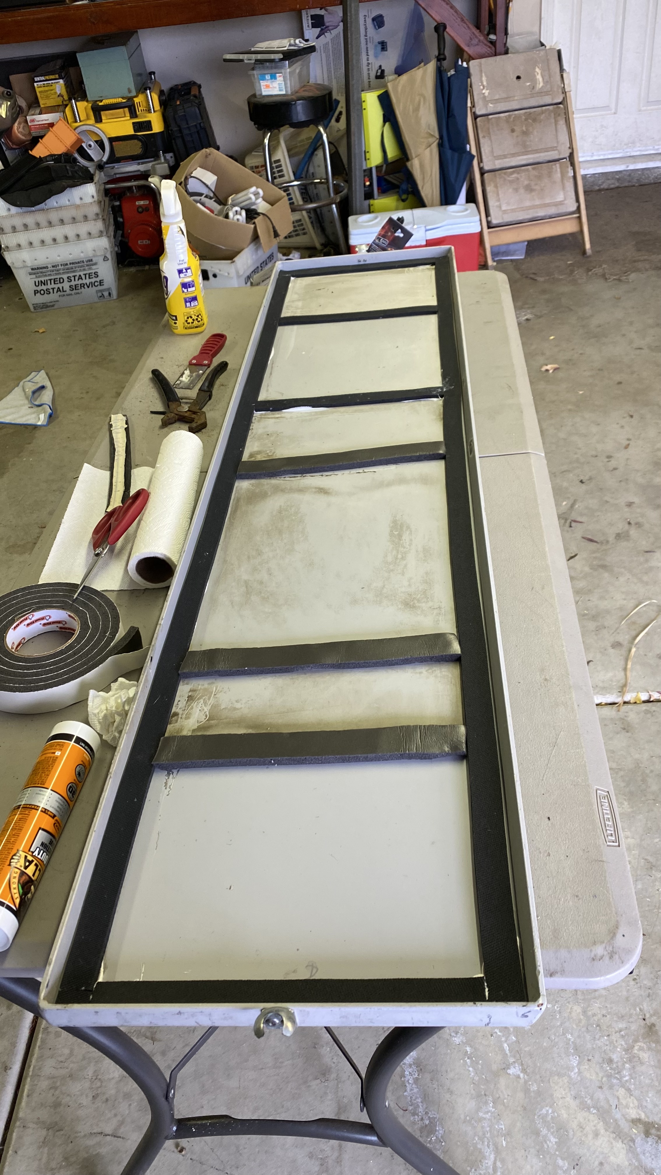

Replaced the seals on my tank lid. I noticed that suction was getting pretty nimble. It's time for a new seal. I was able to replace it with the real deal type seal that Prochem uses. I was three feet short so I temporarily used Ace Hardware weather stripping until my remaining three feet get delivered. The last time I replaced the seal I used the hardware store stripping. when I went to remove it this time it was a slurpy mess. It worked okay, but did not last as long as the real stuff.
If you guys need the real deal, here is where I found mine.

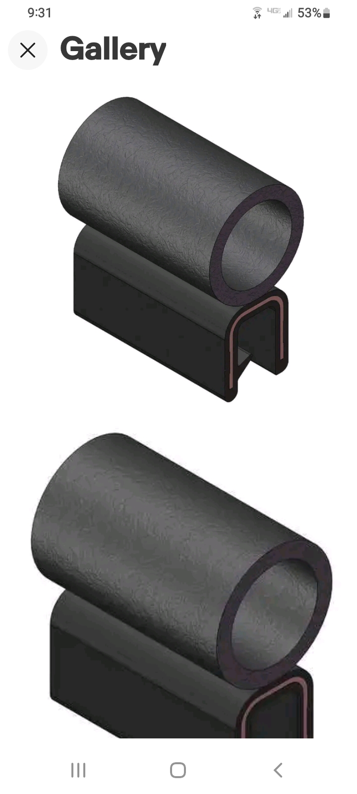

What I've found to be a great seal material for lids like this is the seal rv stores sell to put between camper shells and pickup beds . The 1 I've used in the past had great adhesive and is belted like a bicycle tire and lasts forever i got a piece at my shop if your interested tomorrow i can take a few pictures and see if there's any info on the box

Great suggestion. I'll check it out for future use.
