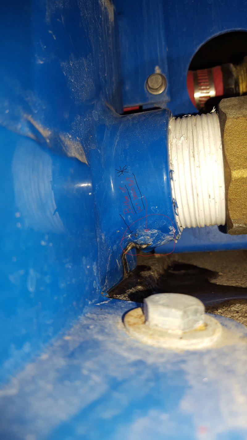

Our 2013 Hydramaster CDS unit began leaking from the "bung hole" under the waste tank discharge area. Our local service shop claims it is from corrosion in the aluminum. Seems a little odd a 4 year old unit that is well taken care of, dumped daily, and rinsed out weekly would have this kind of issue in such a short amount of time.
Anyone had this happen? We have an '08 CDS that runs day and night and never has had an issue like this. We bought 2 CDS units in 2013 and the other unit shows no sign of any corrosion. We are currently seeking to create a warranty claim, so we'll see how that goes. Sani-Bright Unit #14 Waste Tank  Bung Hole Port 072417 1 of 2.jpg
I agree 4 years on a tank I wouldn't think you'd have an issue. We've had aluminum tanks last nearly 20 years with a lot less care.
Could it be the pipe thread that goes into the tank cracked and caused corrosion? :headscratch:

Had that happen with my CDS. Not so fast. Exact same place.
Seems like a problem in design or manufacturing with their tanks to me.

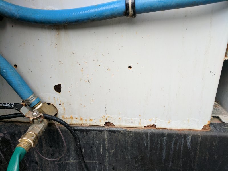

Grass ain't always greener though, this is the front of the water pond on my 18 month old pro1200. Like you it's cleaned fairly often but looks like shit for a unit less than two years old
Reactions: Bob Pruitt
Jun 22, 2016
206
Toronto
Kevin De Medeiros
Same thing happened to the finish on my prochem chemical rack . after 6 months was corroding wherever the slightest bit of moisture hit it. Same finish u have on that tank. Its a shame. You spend a ton of money on these things and should be able to hold up under any condition. A few months after buying, looks like crap.

I'm going to be pulling my waste tank out very soon to move in to another vehicle. I see pits inside of it at the bottom. Is there anything I can do to it to help prevent the problems above while I have it out?
Watch the acid rinses. Rinse it and open the lid and let it dry out now and then.
All the moisture from the tank and then closed up in a truck doesn't allow shit to dry. Metal, moisture, extended time=corrosion. All that is magnified if the truck sits out in the elements day in and day out. I know some of it is unavoidable but its also ridiculous for us to cry foul on a waste tank that gets abused.
In the CDS tank, its sounds more like an isolated problem with the drain outlet weld. ???

Jebus, is that the inside?
No right on the front of the water pond, my new rig with 160 hours is showing rust at the bottom also. It's very visible and looks like crap. My local interlink is looking into it
I've heard of guys who will leave their WT valves open at the end of the day.. I think it's more of people using the pump out and less dumping/rinsing the tank out.. The way the tank is designed with the pump out seems to be the problem imho..
