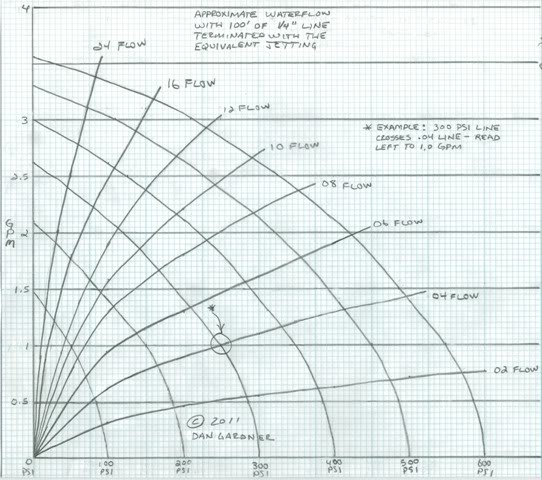

Don’t listen to those meatheads above. Just follow the chart to the specs on your water pump on how much gpm it can put out

Can you tell use what machine you’re using on that wand?
(corrected for friction loss by Dan G)

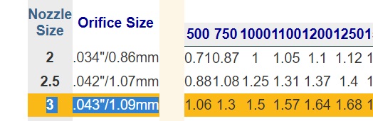

We refer to flow as it relates to the size of jets you have on the wand. 3-11003 jets will give you a 9 flow. 2-11003 jets will give you a 6 flow and so on. Has nothing to do with GPM, it's just the size of the jet or jets.
Reactions: steve_64
I guess in the sense that we refer to it......meaning not usually having any idea how much....or at any standard pressure
but that last # in the jet size it what it will flow in gpm @ 40 psi. Each of those 1103 jet would produce .3gpm at 40 psi (not particularly useful info for our application)
increasing with psi.............as per chart above

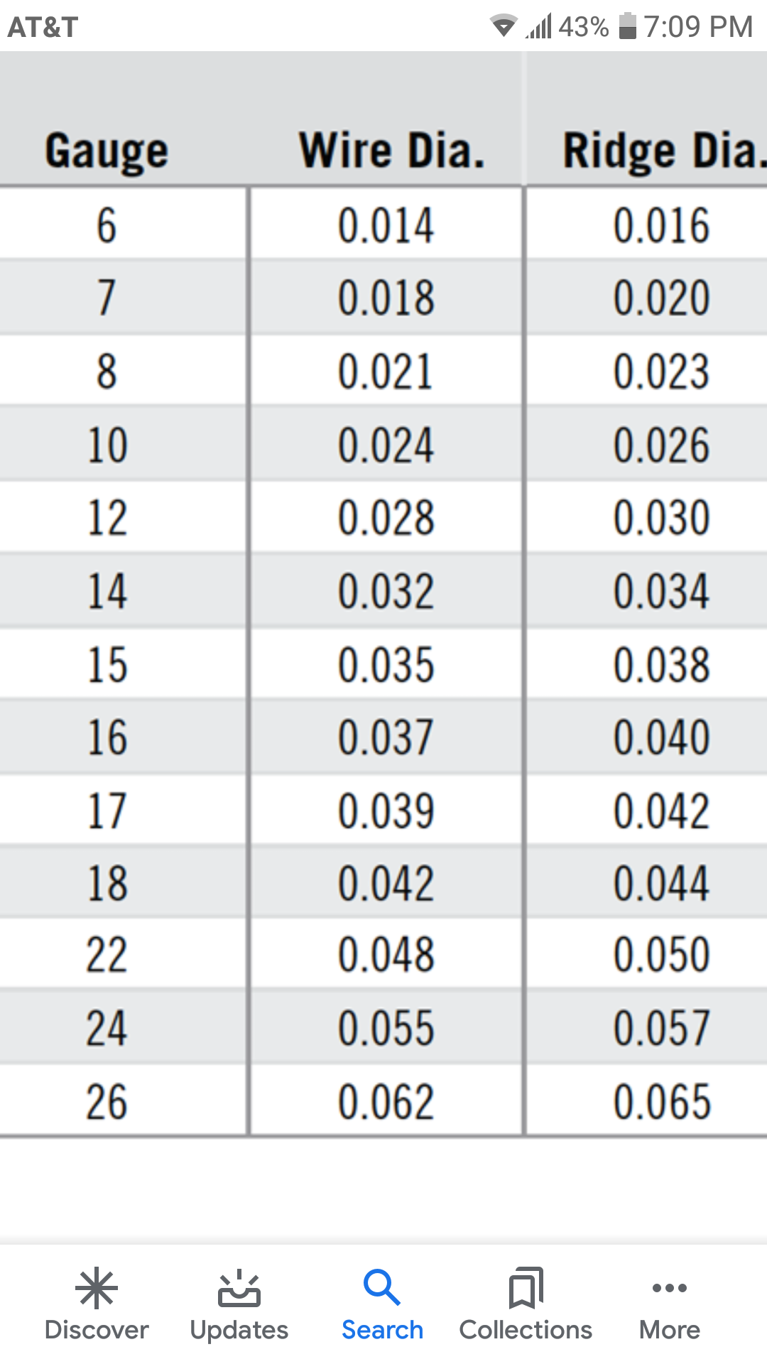

Coming from the machining industry I agree with Ron.
A 11003 is a .030 opening. The 110 is the angle. You can't get a .030 tip cleaner in .015 opening. Different pumps will produce different flow rates at equal psi. At least in my experience.
Think of using an electric sprayer compared to your truckmount. The smaller the pump the less water you get through the same orifice.
It's about the back pressure.
