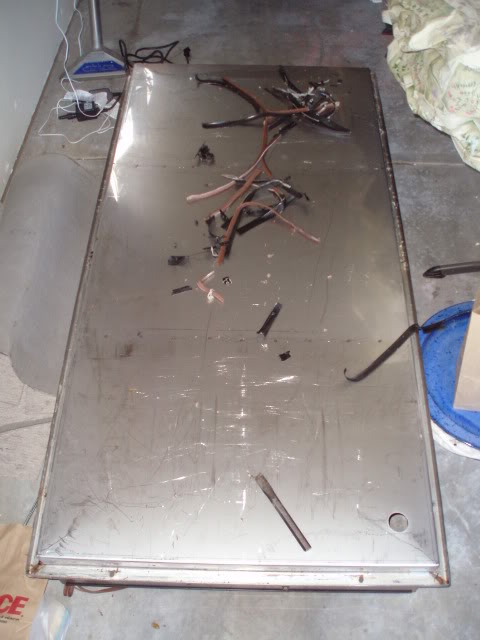

After 4 years It developed a fresh tank drip.

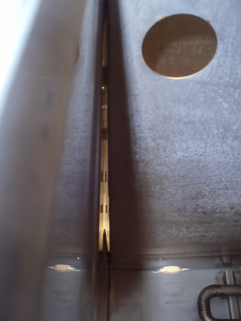

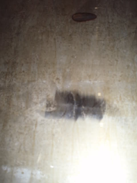

See the crack?
I can't either, but its there

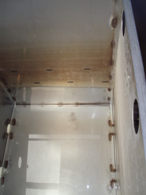

Both my baffle walls fell over in the first year on my Aero Tech built tank. I had a local welder re tack them in. the sides worked loose but the top and bottom welds are holding. AT had nothing on the bottom holding the walls down. :shock:

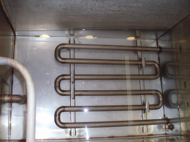

HX pipe from the radiator
Redoing the lid gasket while I'm in there.
116,121
I had Nordik1 install that HX pipe Vince.

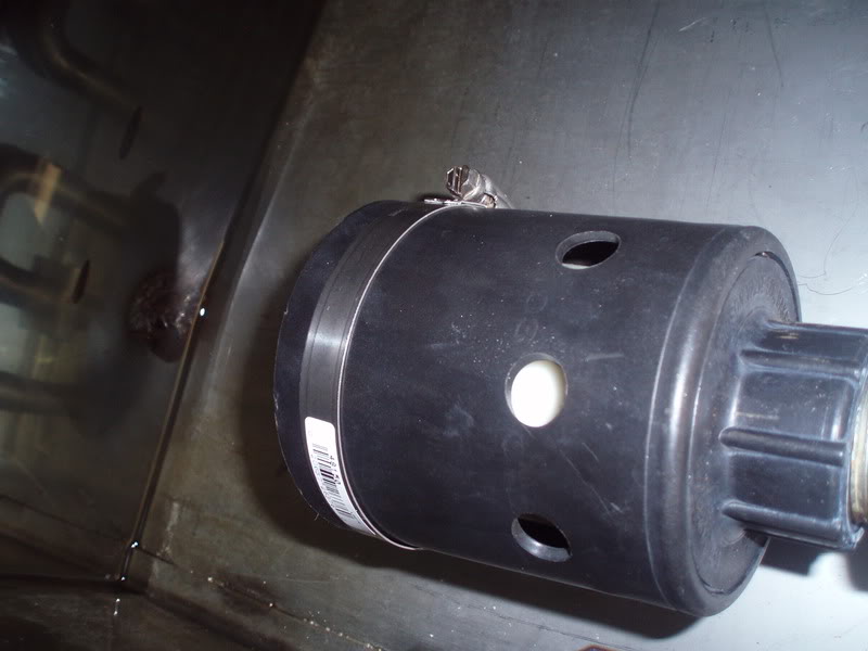

Geez...a baffle or two around the float area would shield the float from all of that sloshing, it's obviously killing the float levers (after they degrade a bit).
The plastic Hudson looks like a winner from a stability point. Mike, what causes them to "oblong"? Just the hot water in general?
116,121
Yep, the outer black shell cant take it for more than a few months.
Even the stock pvc pipe that attached to it oblonged like mad.
