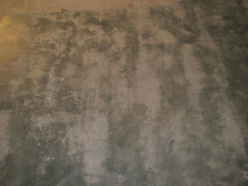

just a report
The glue was both black and in some areas yellow.
I had done a test area and things worked, well we get into the job and it was a huge pain in the ass. got it up and the finish came out nice, this was a real old floor 25-25 yrs old. The 12by 12 tiles were up so all I had to do was beat the glue, and it kicked my ass
Ill put up pictures today

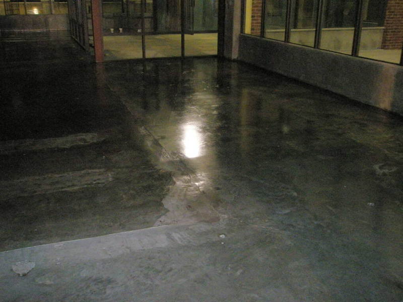

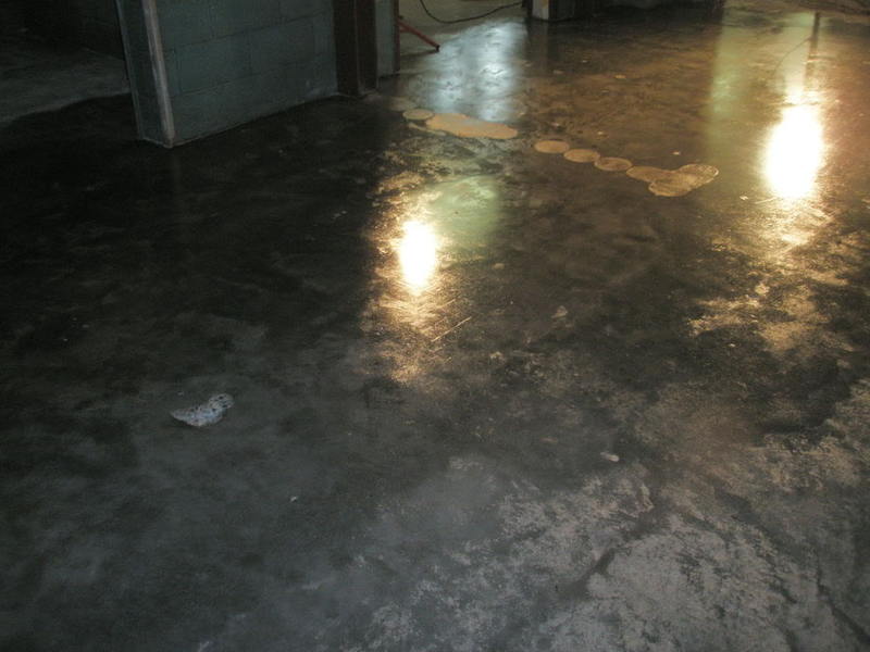

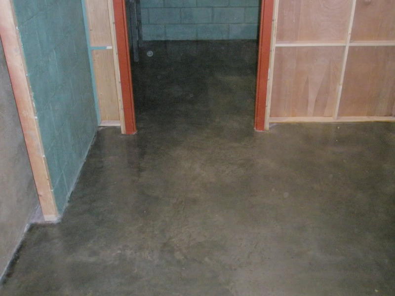

Ron Lippold said:
dont beat me up to badbut here goes
wood eye do that.... :twisted:
kind of tough to make that floor look "great"
it's shinny though...
BTW, you missed some CRUD in the corner :mrgreen: :mrgreen:
