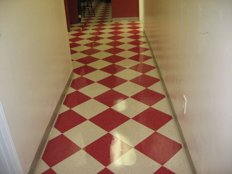

VCT Floors I did since I had requests for pictures

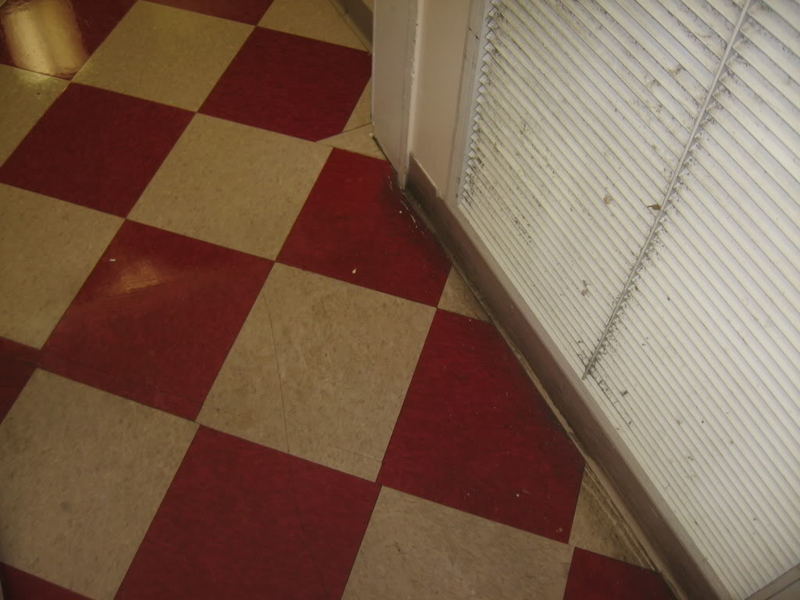

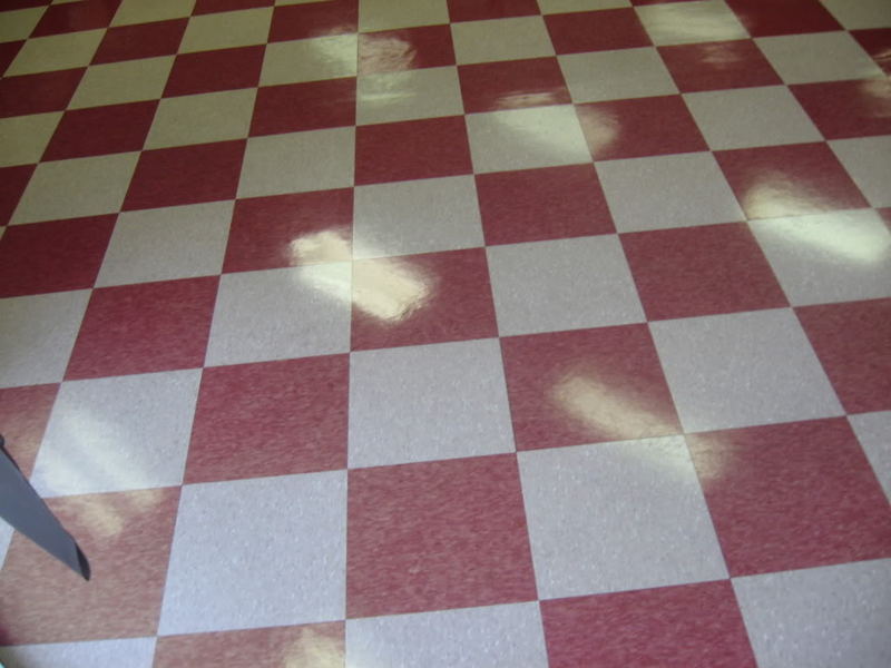

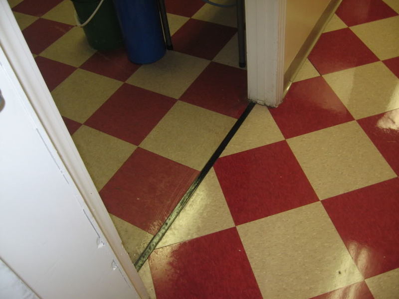

This was an area we didn't do ( the main area was worse than this room since it wasn't being used for customers)
These are areas are we did next to an area we didn't for a contrast I know it might be a bit sloppy but no customers saw this area

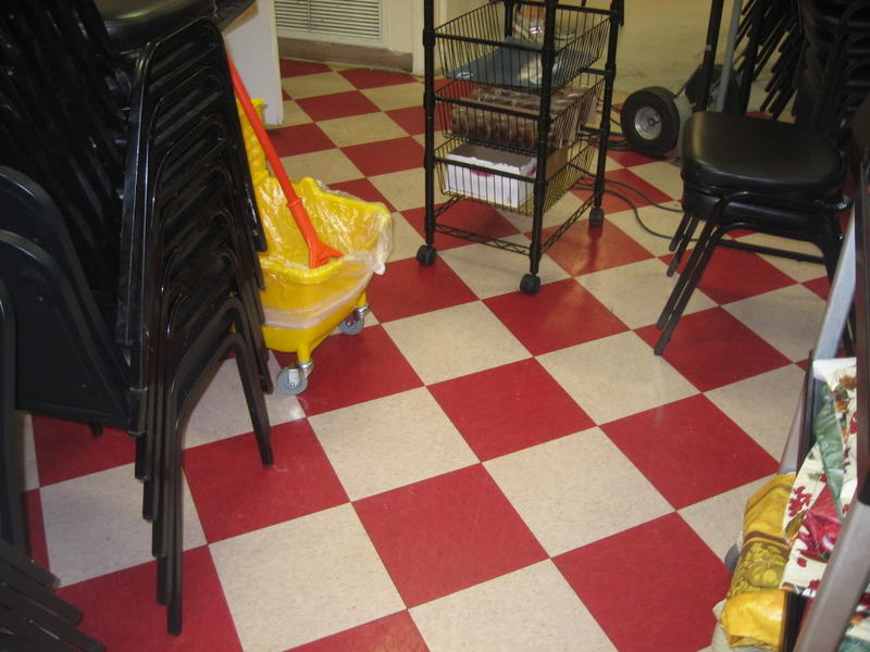

you didn't put that plastic sheet cover over the wax in that mop bucket did you, or was it a bucket liner
any more I just get the wax in gallon jugs and use a micro fiber wax mop

steve frasier said:
looks nice
I put some trash bags in there as a liner but so far they never hold all the wax in the bag.
Also the place I bought my stuff from was totaly anti microfiber and I just got enough to get started, as I make some money I'll update with microfiber and all that. I'm sure it will make application better and more smoothly.

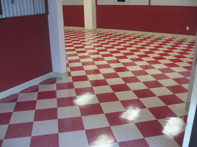

The typhoon? It's ok, i probably need the squeegy kit to push it around and suck stuff up but I'm waiting on more jobs to do that. Right now I squeegy it to a side while my wife sucks it up. It's time consuming but probably less so than moping it up. I probably went through around 30 gallons of slurry and rinse.
The worst thing about the whole job was the edges and corners. Stripping the center was very easy with the cimex. I gravity fed the stripper to the whole room then would come back and go over it one time after the stripper dwelled and that's all it took for sure. We could of gotten done faster if I had another doodle bug and another scraper blade.

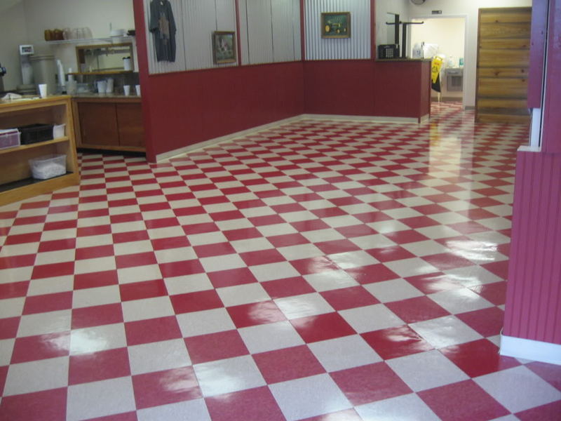

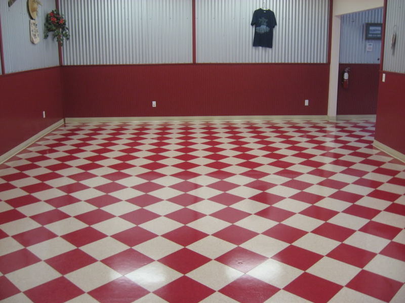

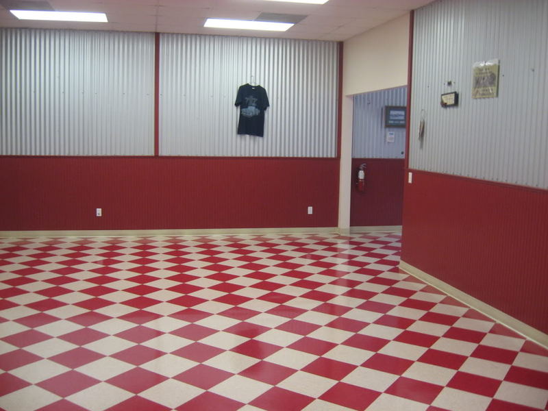

These people had someone supposedly strip and wax the place before and they said there was no comparison to the job I did compared to the last one. The corners and edges were noticed right away. The shine is something they hadn't seen on the floor ever. I think most people who do vct around here put 2 maybe 3 coats on in the beginning and most if not all never do a complete strip, just scrub recoat and call it a strip job. And I seriously doubt any buffers are used in a scrub job. One guy around here that I know of that does this work, I've never seen have a buffer.
