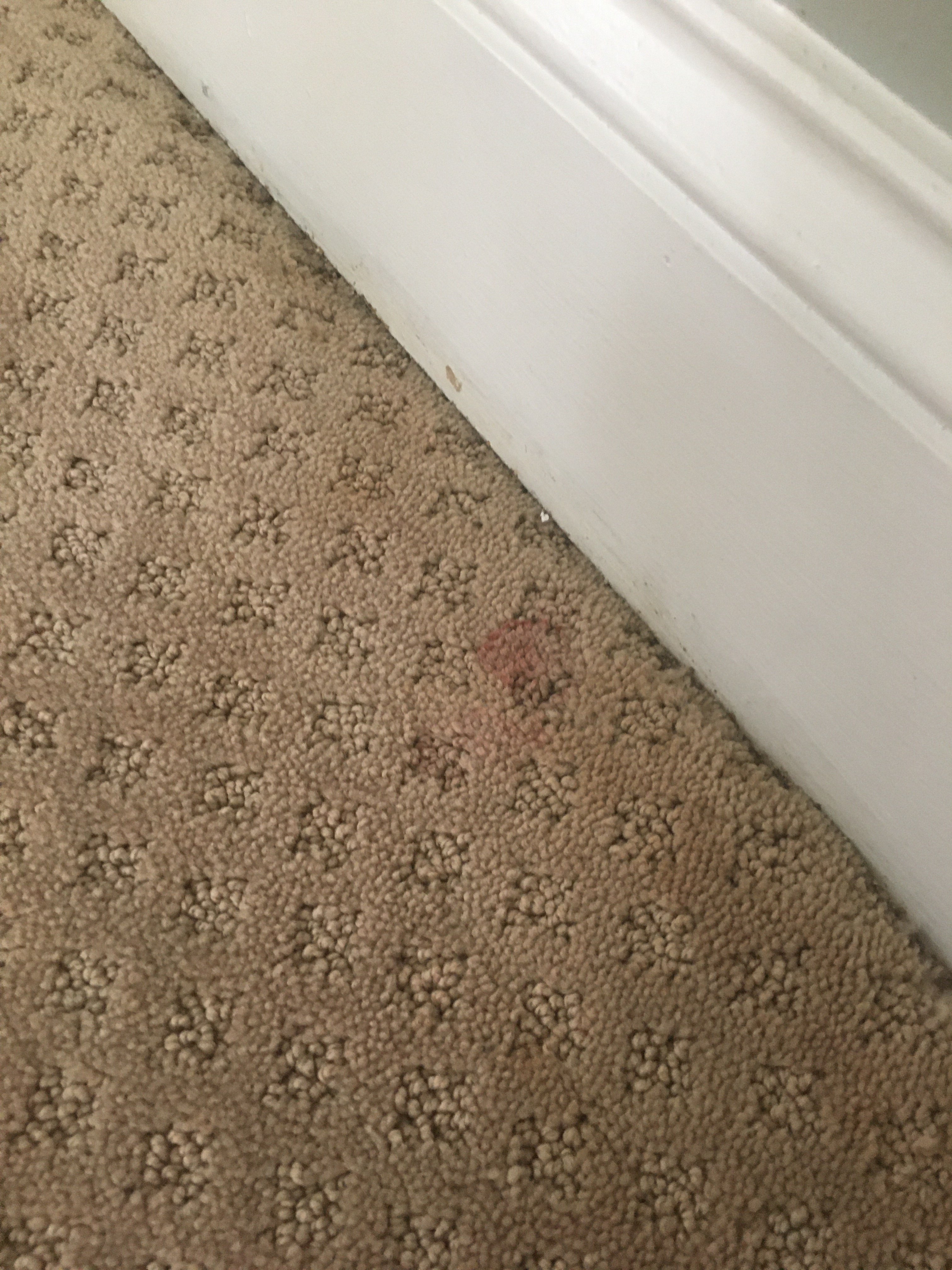

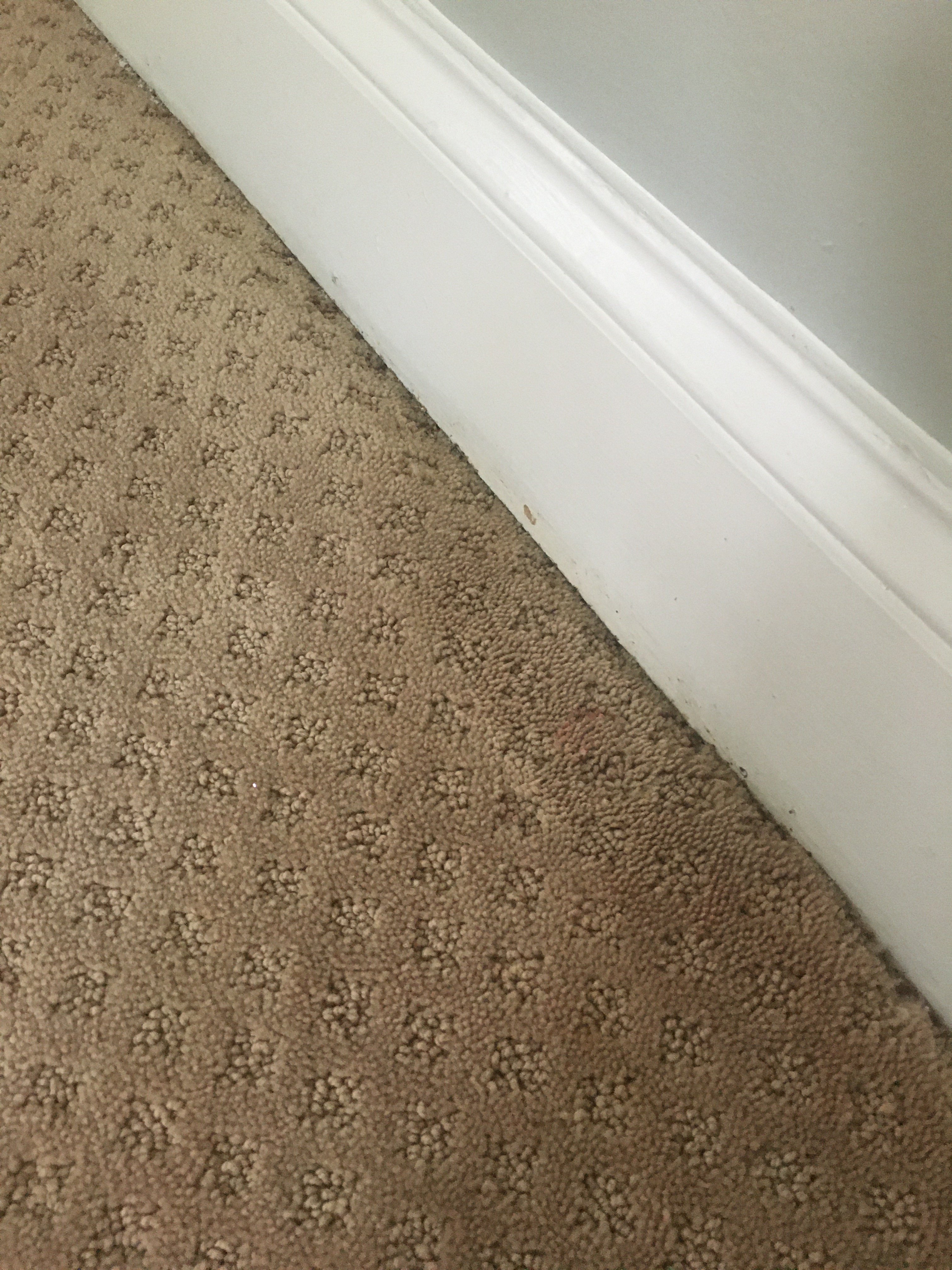

So here are some spots that I cleaned up after my prespray didn’t work:
C3E40ACF-DD17-410E-93E6-FBBB43FDFBA9.jpeg B9900020-B8FE-47DC-862D-35A689FAD9EB.jpeg

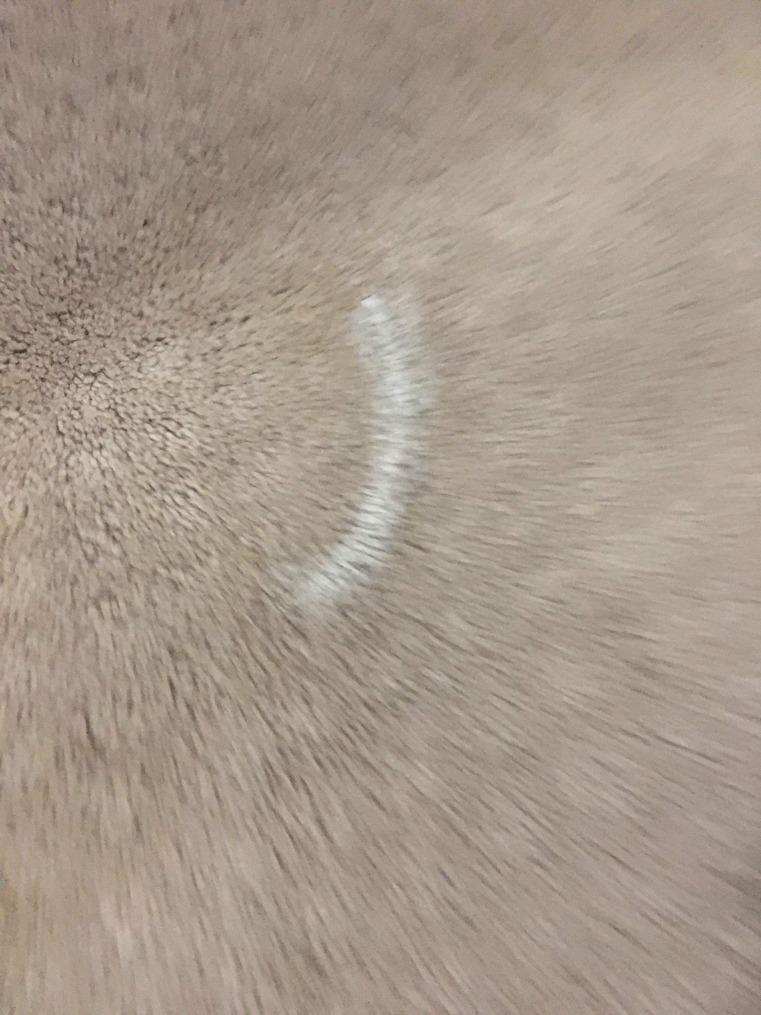

Below is a paint spill (I already spritzed the spotter on it). It dissolved immediately and completely.
(for Fred) The stuff is so powerful it partially dissolved the picture! WOW!!!

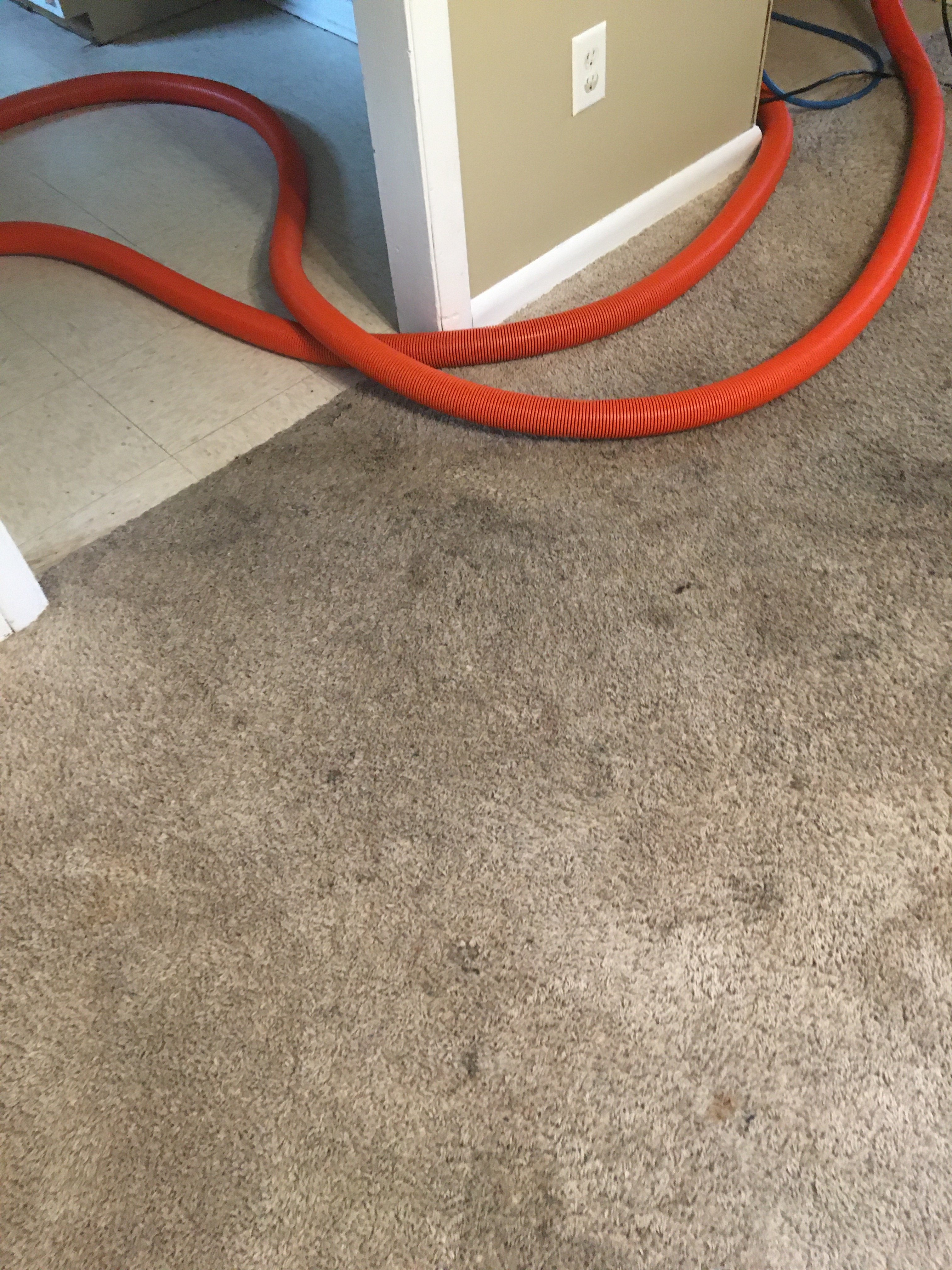

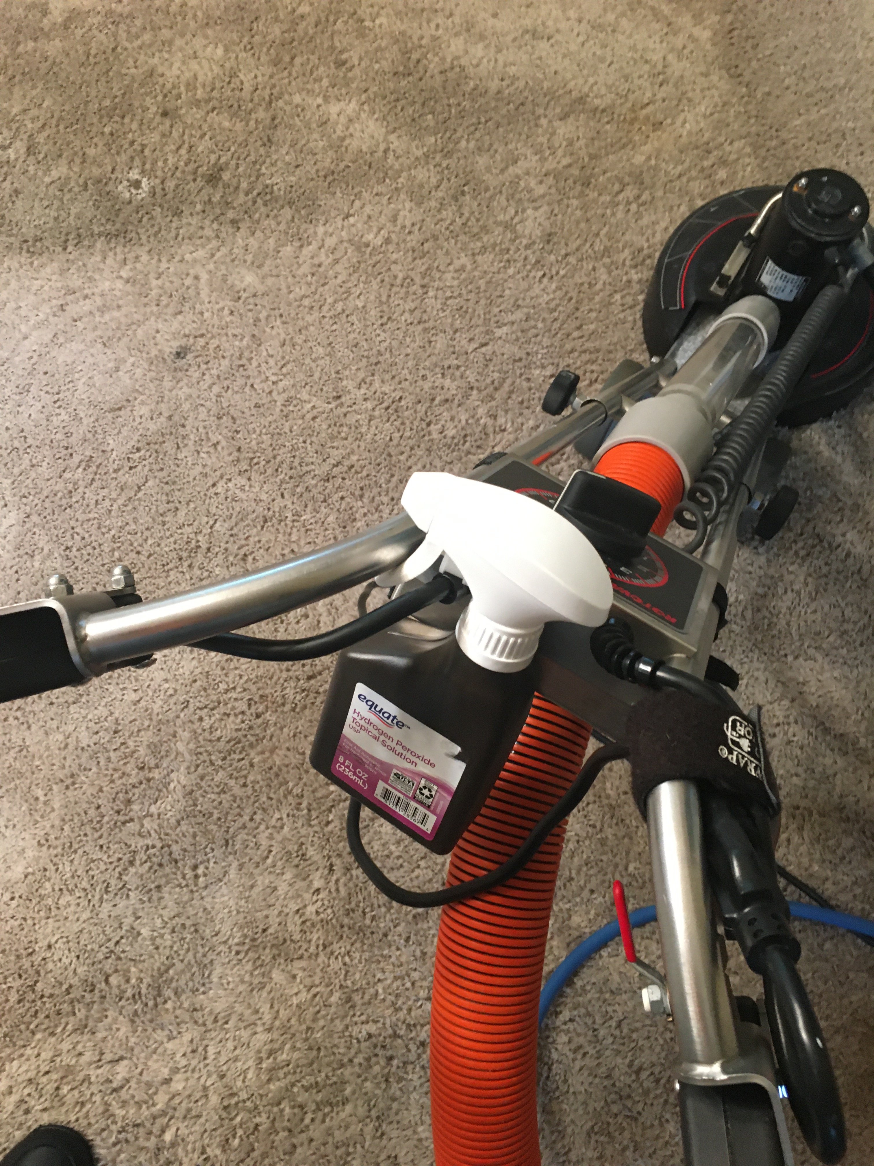

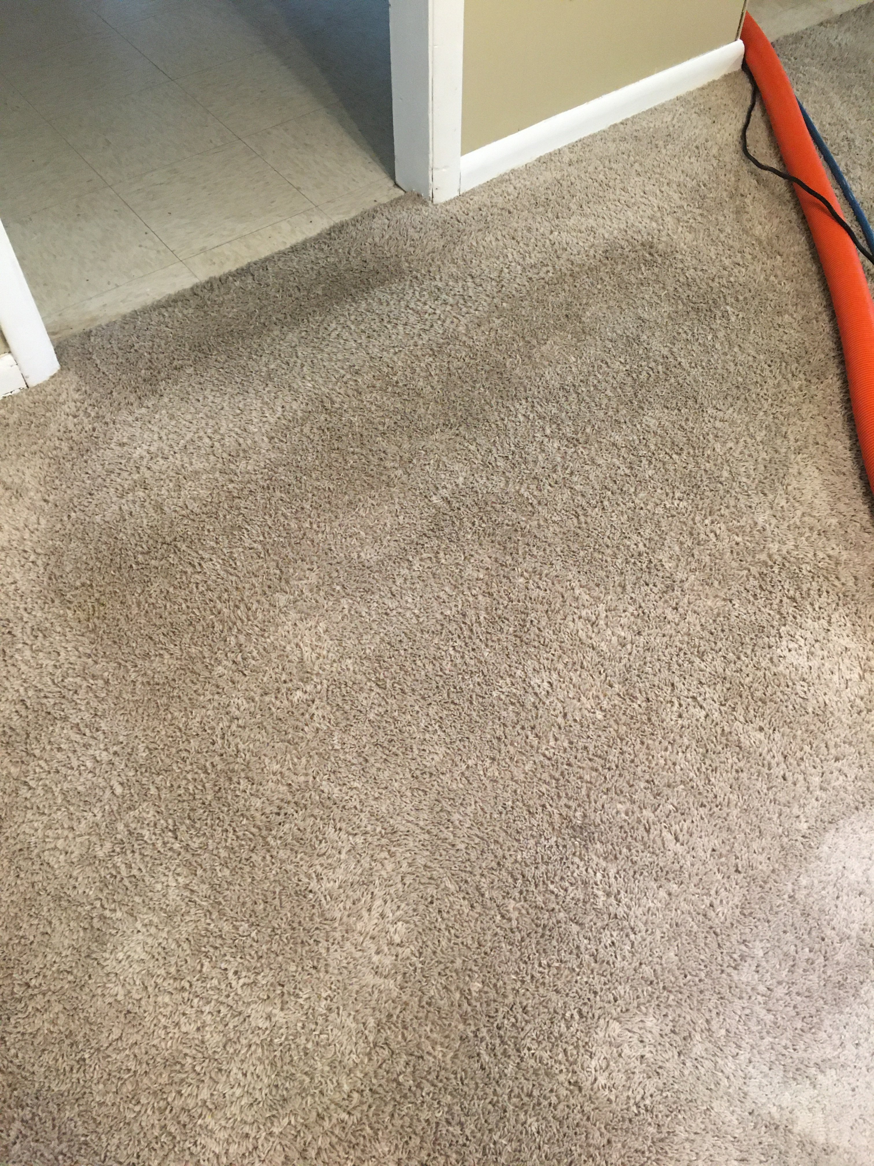

Below is an entryway with a variety of greasy and waxy spots. In order to disperse the spotter, I used an empty peroxide sprayer
361CF6CC-9AE2-44AC-9C18-FBC994D6B3E8.jpeg FFE1375F-28B7-47AA-91BC-ED5C819B28E6.jpeg

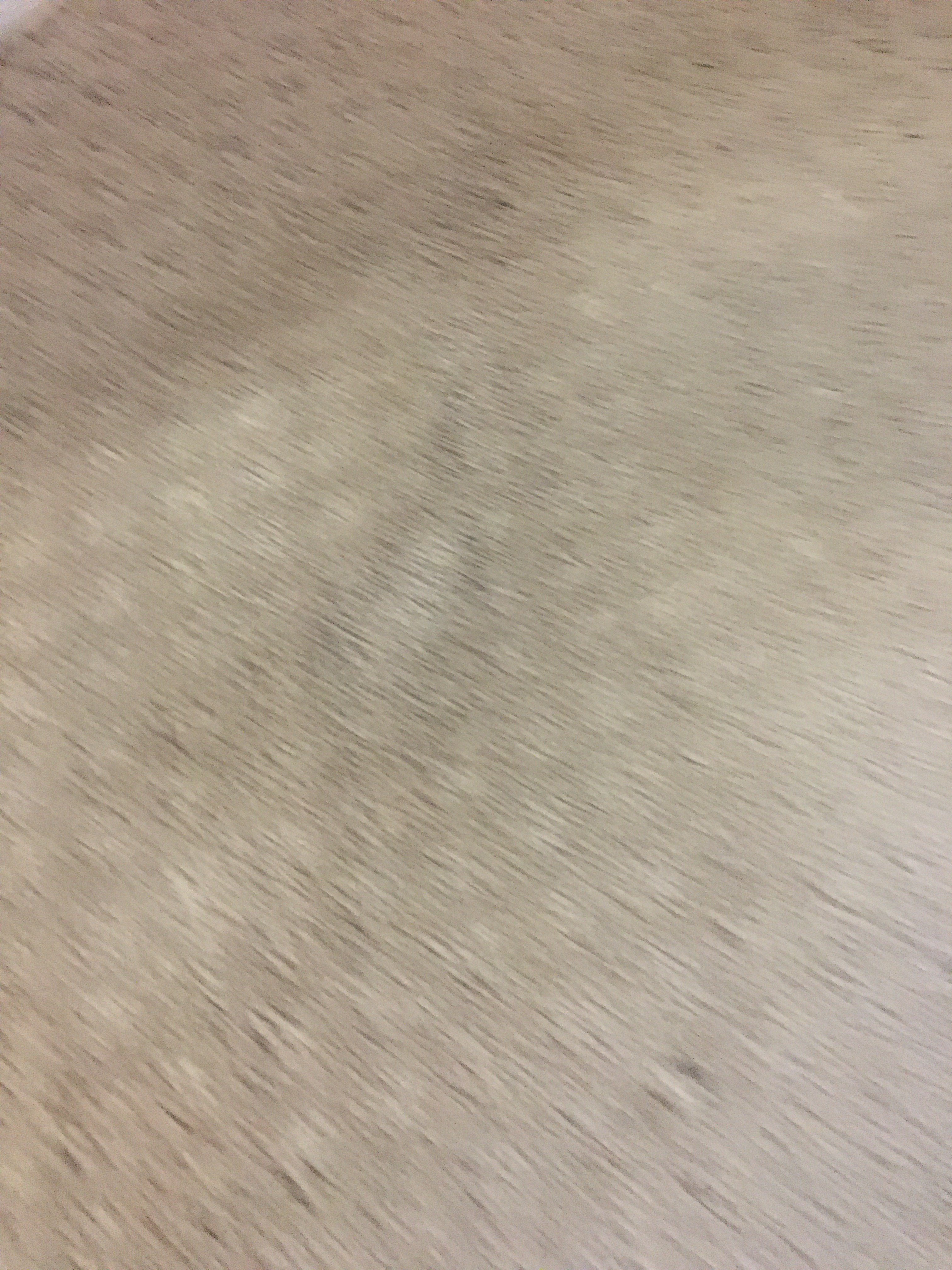

Then I flushed it a second time, with nearly perfect results. Ignore the shading, it is iPhone screwing me
The spotter behaves like a solvent for things I had been using gel for. For crusty things, I broke them up with a carpet shark (doot doot do-doot) and the spotter made them crumble off the fiber. I found two spots it failed on; one was a hard gummy substance In a rental that I could not budge with anything. Wound up using scissors to clip it. The other was a hard substance that looked like a spilled resin. Again, I had to clip.
I did not expect one spotter to get everything, but this one performed nicely. In fact I used it all in two houses and felt oddly bummed out when it failed on those two spots! It flushes easily, unlike dilimonene or peroxide.
