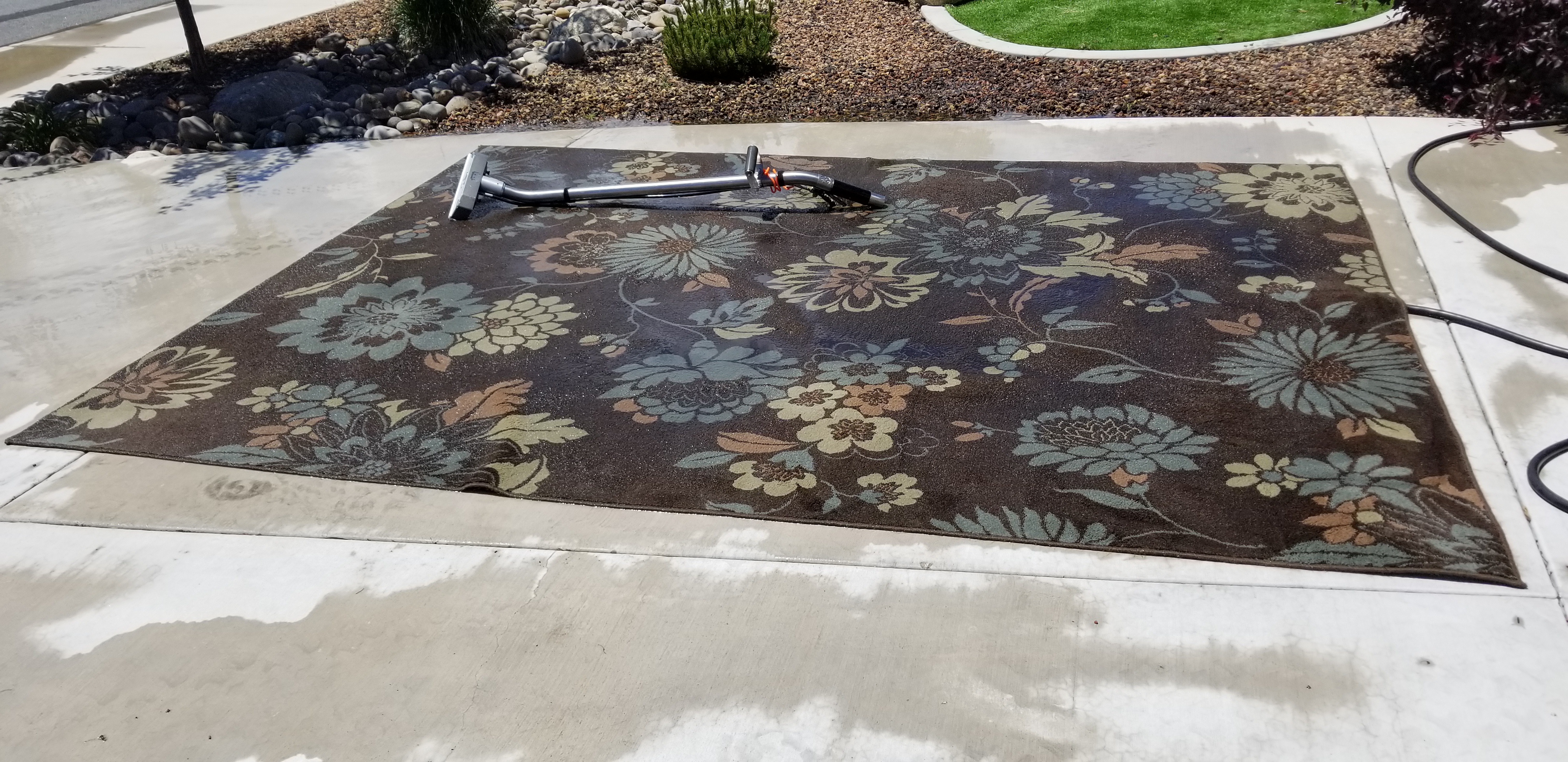

Im testing his theory today on our Pepper soaked olefin woven.
Flush flush flush..
Push the brown water off until clear..
Extract...
dry with fans and the sun...
Flush flush flush..
Extract...
Lay a hose under it and rinse. If you don't have a scrapper use you glided wand to squeegee it off. Better yet flip it over soap it up use your CRB then preasure wash the back to push/rinse through then do the front use caution with the pressure though.
Roll it around a pipe, tie it, stand it up have a beer/fruity margarita you rug fag, then extract the bottom foot or so of water.
116,006
Did that for over an hour wit the wand.. Water was that delicious golden brown in more than half the area..
Smelled great when cool and wet but had a slight pee smell when it dried so I doused it with a smelly good quat and dried again.
Back in use now.
tossed the Nomuv...it was the funk.
