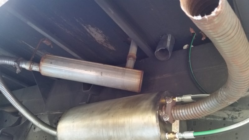

Hi my name is William and I am new to this board. I'm am also new to the cleaning business. I purchased a 2003 prochem blazer xl and I would like to get more heat. I read In one of the posts that you could add a 3rd exchanger to the machine. I was wondering if anyone has any information on this. Was hopeing someone could help me or point me in the right direction about doing this. Thank you

I added an a Blue Barron heat exchanger to my Whitemagic... it replaces the primary heater ,but i don't see any reason why you couldn't extend you exhaust and add one .

I have a Blazer xl and had to change the temperature relief valve in the water box and the temperature by-pass. Now I get very good heat. The problem is if you are using a large flow wand and are on it continuously, you will run out of heat. Probably a 4-6 flow wand and start in the center of the room. Clean over to the wall and dry vac your way back to the center again, letting the machine heat some more water.
