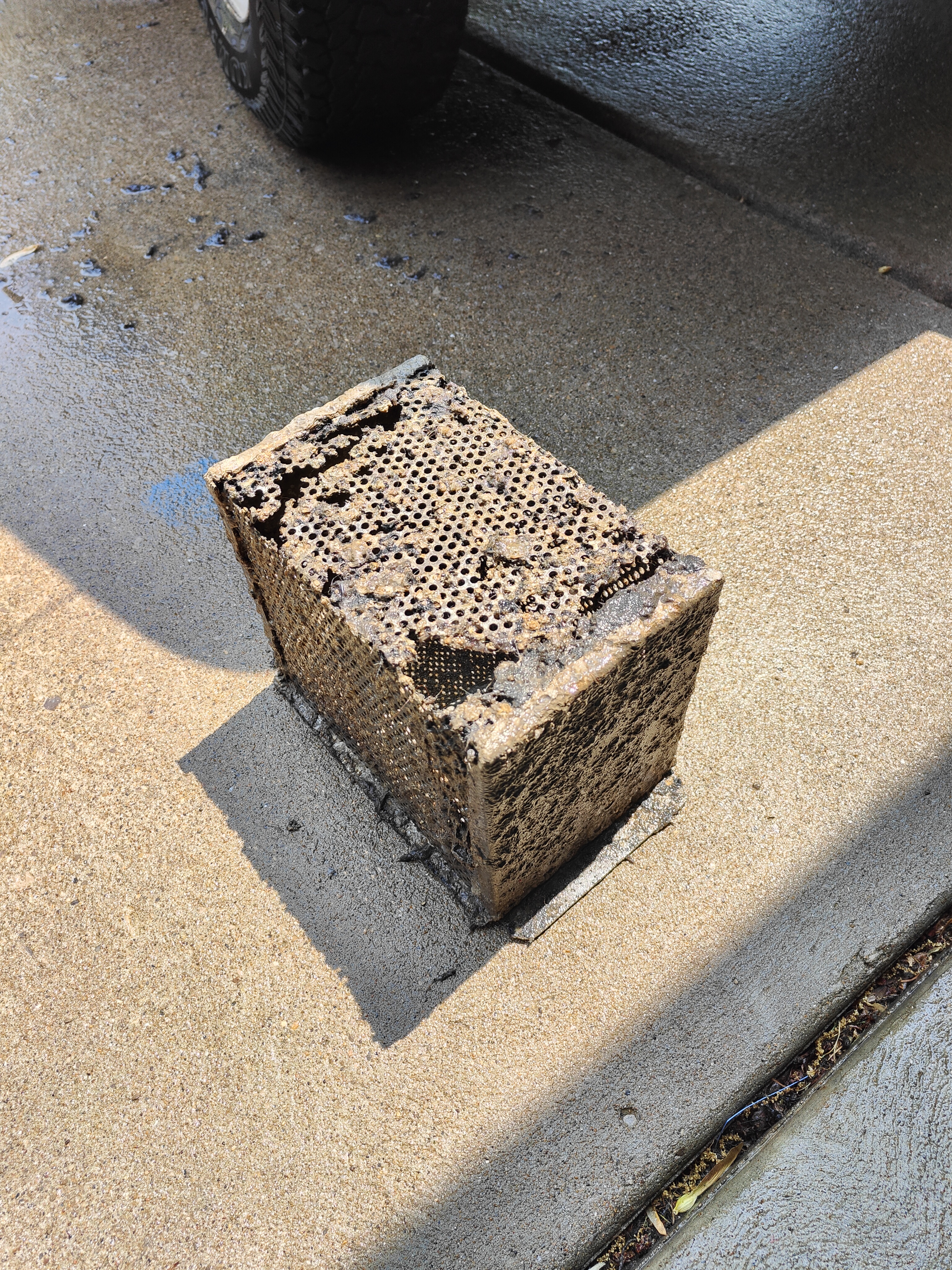

May 28, 2023 #1 steamron Member Joined Oct 15, 2012 Messages 265 Location Northeastern PA Name Ron Let's give it a try,
May 28, 2023 #2 BIG WOOD The Timminator Joined Feb 4, 2016 Messages 14,102 Location Georgia Name Matt w. Nope Time to buy a new one Reactions: SamIam
May 28, 2023 #3 Sierra Clean Care Member Joined Jun 20, 2016 Messages 6,516 Location Bc Name Jeff T Looks like mud wasps have taken up residency… Replace. Reactions: Mikey P

May 29, 2023 #5 Papa John Lifetime Supportive Member Joined Aug 19, 2013 Messages 6,972 Location San Francisco, CA. Name John Stewart Repair it by replacing it with a lint hog or devastator filter. Reactions: Nomad74 and hogjowl

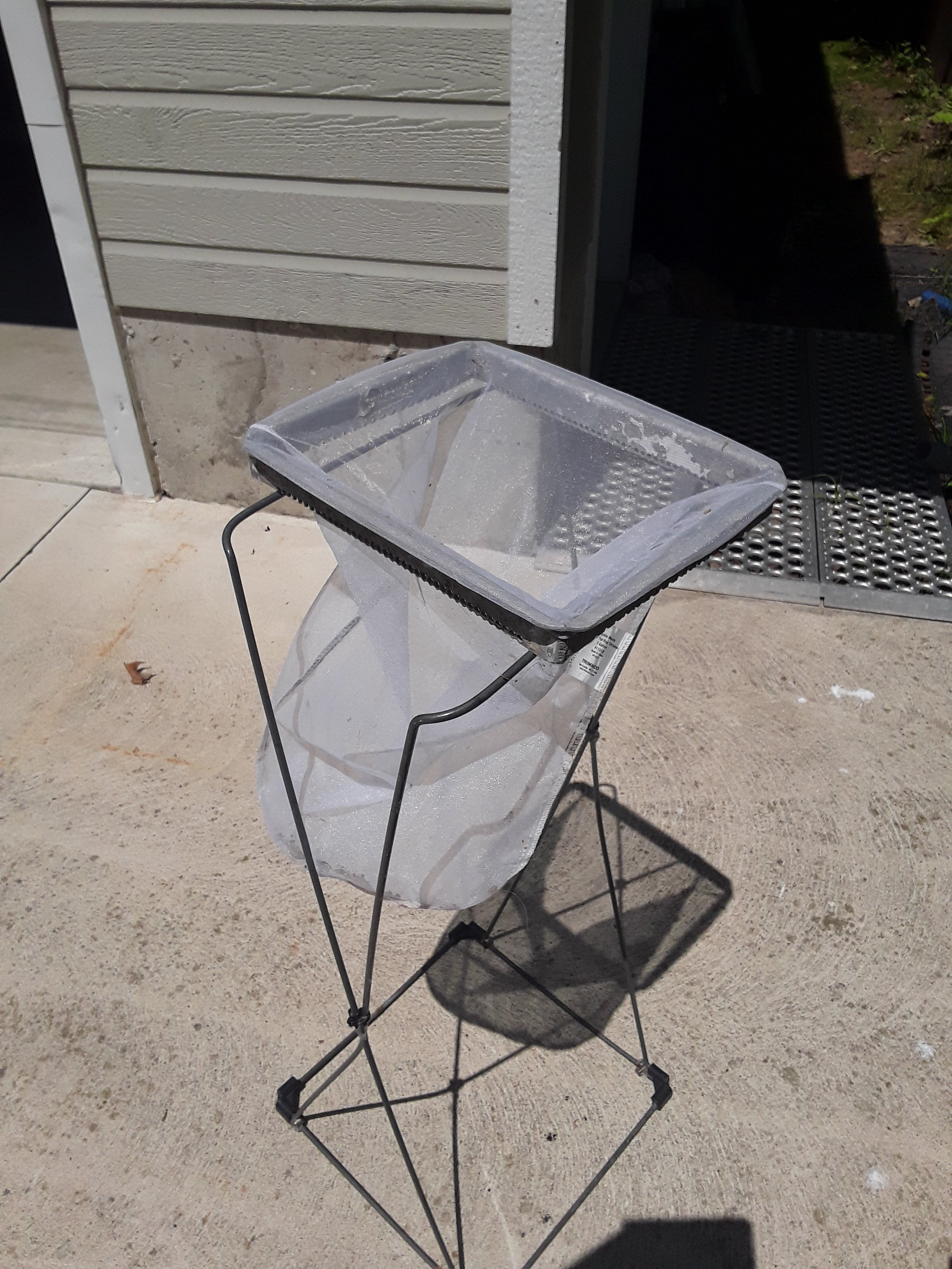

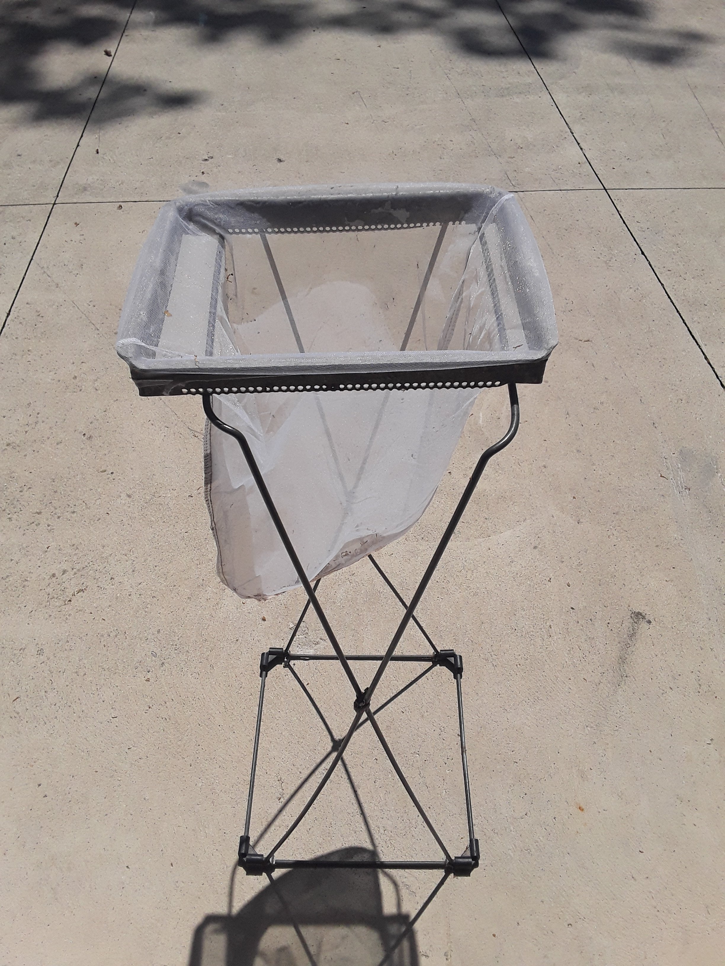

May 29, 2023 #6 Rob Grady Member Joined Jan 31, 2016 Messages 604 Location Sauble Beach, Ontario Name Rob Grady Here's what I did to several restrictive baskets. As long as your top part is in decent shape. 5 gallon paint filter fits snug. Makes my little 45 blower a deep breather. Reactions: Papa John, Mikey P and BIG WOOD
