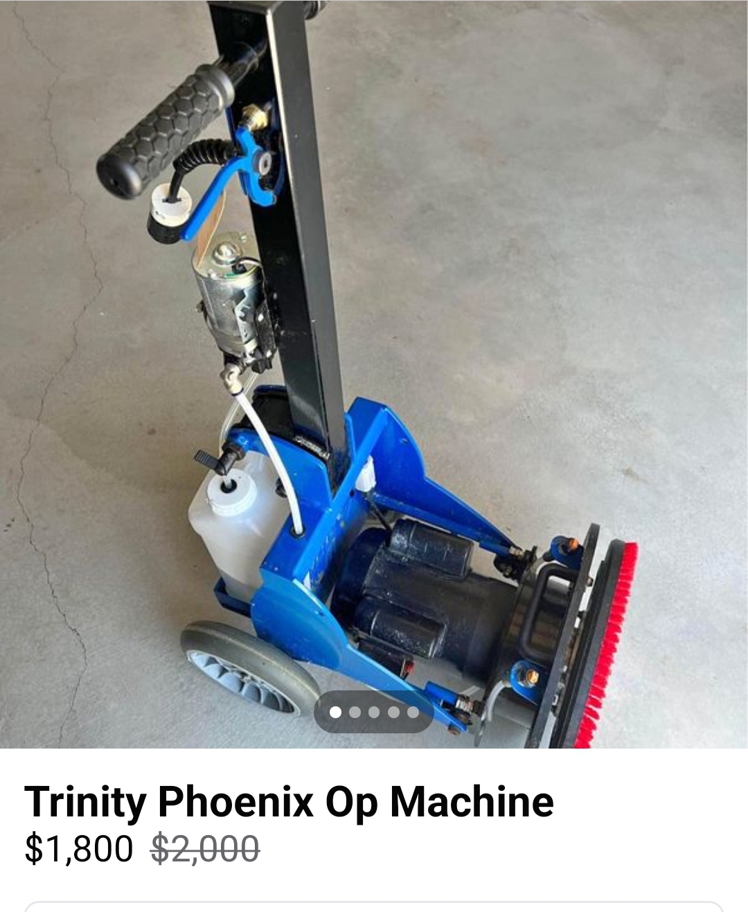

This gentleman supposedly has two of these for sale. Would this have any advantages over my Mytee Eco 14?
115,993
Advantages..
Easy swap and clean solution tank
Easier to flush lines and pump
Much easier to maneuver in tight spaces
Three choices of occilation throw/ speed
Its not a Mytee
and most importantly, the tamping action

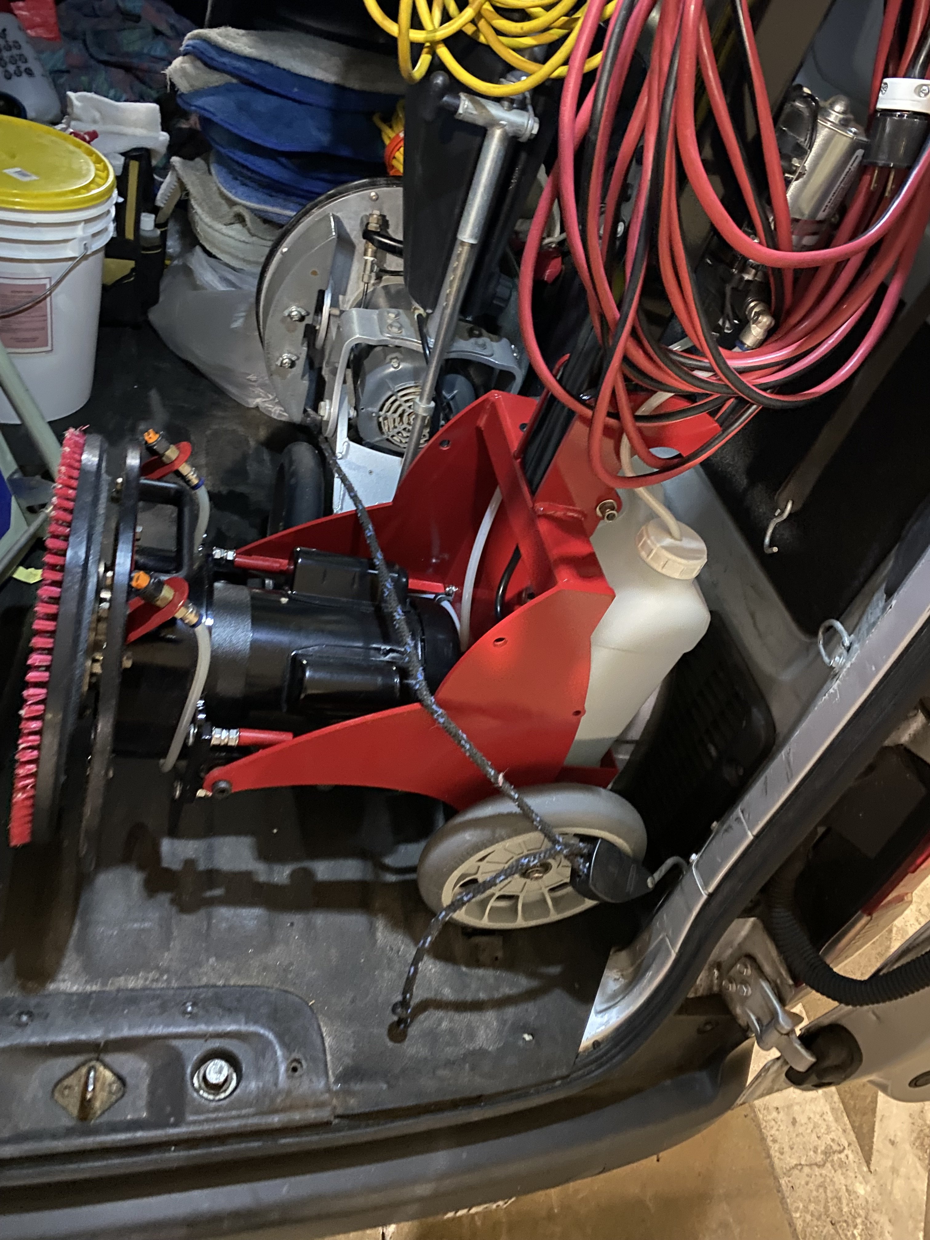

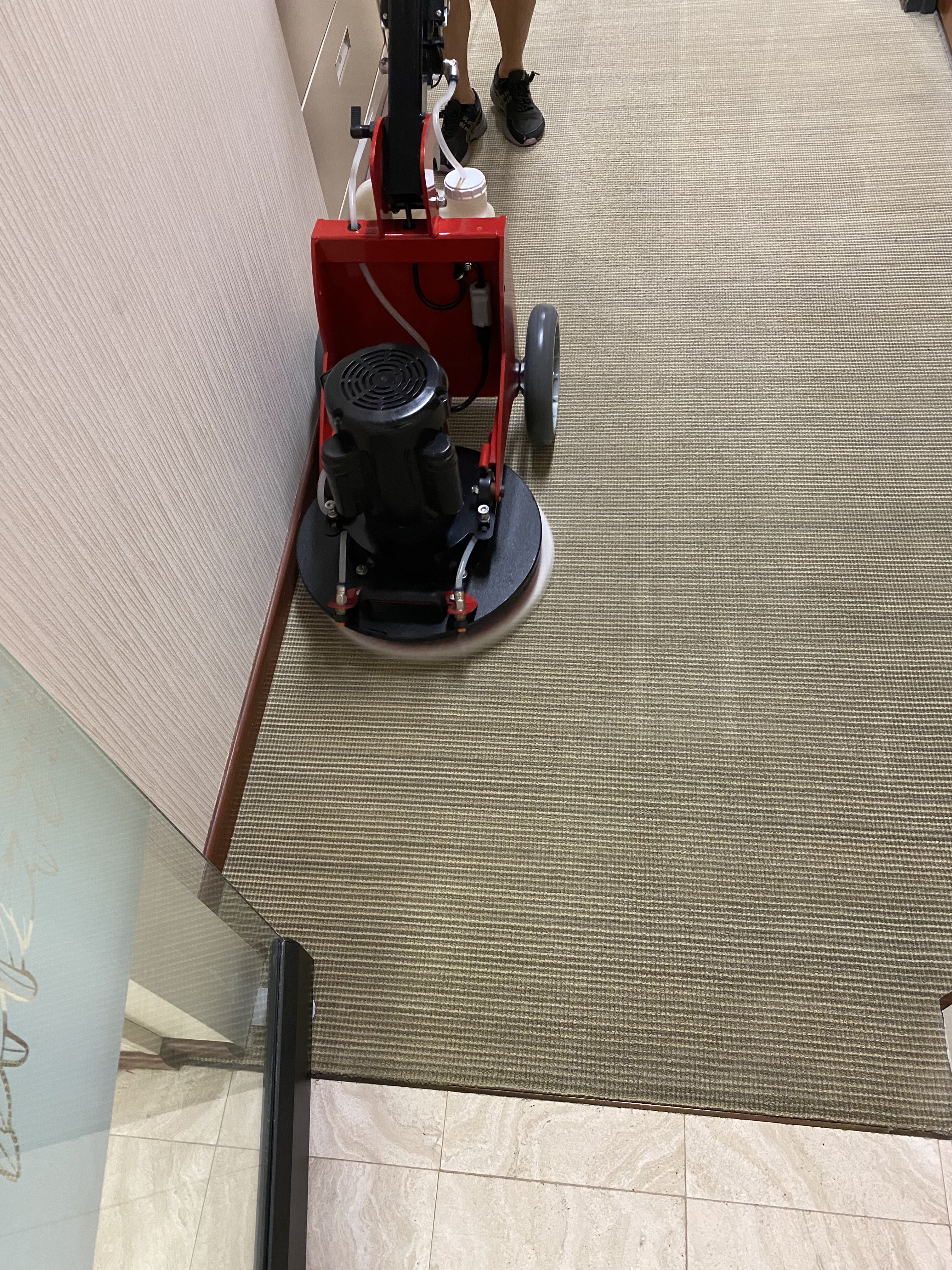

I have never used the Eco so can't really compare. I have a Sprayborg which is a great machine but I find the Phoenix is a little faster. The Phoenix has a larger orbit, may have a higher rpm and also has some up and down tamping action. I have a dozen 2.5 gallon jugs for both machines and bring all the solution I need. Makes for quick and efficient cleaning on commercial carpet.

I don't think I can justify 6 machines at this point, so I've decided to pass on them.
There's the link if anyone wants to pursue.

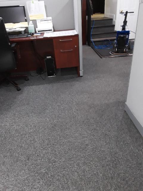

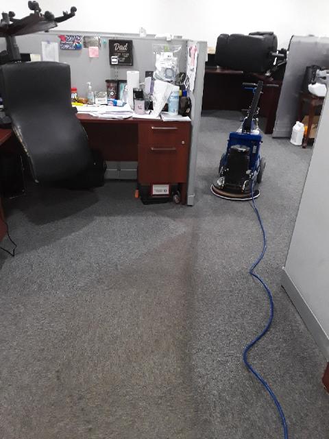

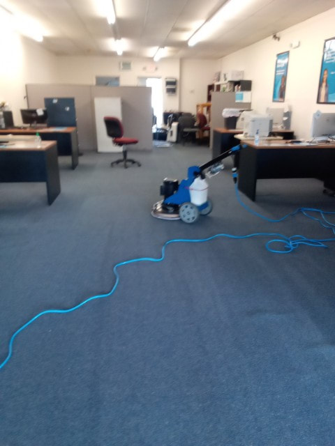

$1800 for a Trinity Phoenix in excellent condition is a STEAL. Buy it !!!
I never used Phoenix on Residential
I use a CRB to scrub and Trinity Odyssey to extract for most of my Residential
Releasit DS2 and Phoenix are used for Commercial Carpet Cleaning
Commercial is mostly just using a Microfiber Bonnet
But in some cases a Fiber Pad is needed to scrub before using Microfiber Bonnets
Those two jobs I didn't need a Fiber Pad
Cleaned easily with Microfiber Bonnets and DS2
