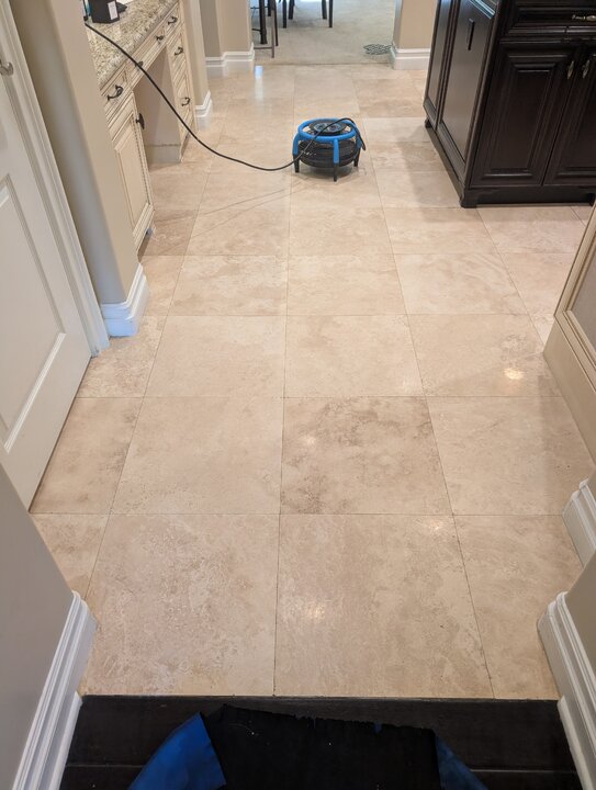

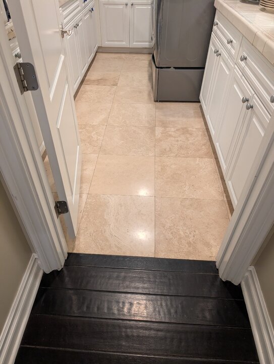

They're hiring a company to fully restore the floors next year.
But before Thanksgiving they need it not to smell.

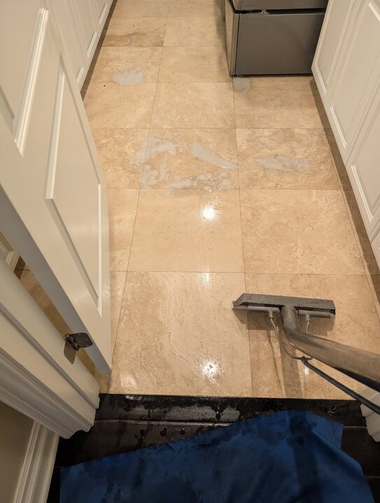

So I used some @Mark Saiger LVT/LVP cleaner with some Lime Citron destroyer cide.
Mop on 10 minute dwell, crb scrub, and 400 psi rinse with my sapphire 14 inch and brush glide.
Hopefully cooking and baking will knocked down the cide, OORRR JUST buy some Keylime Pies!
PXL_20251126_192323962.MP.jpg PXL_20251126_194759473.jpg PXL_20251126_192326459.MP.jpg
11,565
Ps I flat mopped the floors dry and dropped fans and dried the engineered wood floors
Maid uses bona, so the wax clouded a bit in the edge doah
