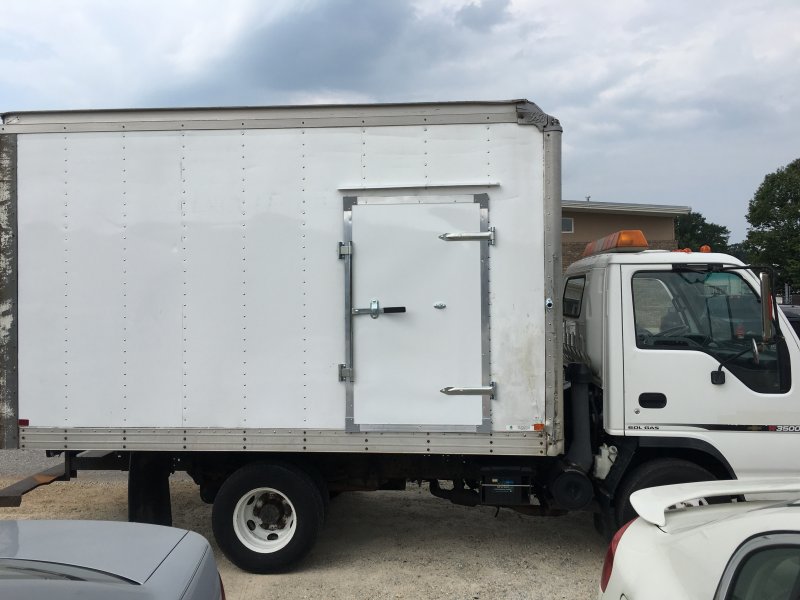

Before scraping adhesive off. I know you guys have seen this already. I'm adding more.

I started using goof off and it was taking the paint off with the adhesive as well. I used a few other things and didn't like the outcome and found that wd40 did the best. I sprayed it on, loved that it stayed on and didn't evaporate immediately, let it dwell, and started scraping. There's just a tad left on it, and I'm gonna see if my wrapping company will let me get by with it. If not, I'm just gonna pay them extra to remove it themselves. I'm burned out on scraping
As for the door, I have a local welder machine dude that did all the cutting and remaking of the frame. There's a trailer company that builds enclosed trailers in a county next to mine that's gonna install the door this thursday.
