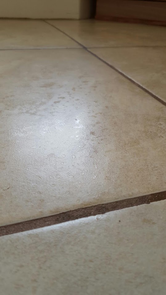

A member here sent me this wondering what is going on..
Zep stripper wouldn't touch it...
Took a razor to get SOME of it off.
I'm guessing someone sprayed a lacquer on it, creating those droplets..
ZyrdK-9SfaQkwIj2f7NhMT8an2bX2fRqR2XIWiZAPjTn3W4u60kxvacI-Hi4swu7Ip30IcRuS5SwGjPERoE=w538-h956-no.jpg

The lacquers I used years ago in my automotive days re-dissolved easily with lacquer thinner. Is there a lacquer-based floor finish? That's a new one on me.

Dan is right, lacquer comes right off with lacquer thinner. If someone was working on the cabinets it would probably be a two part conversion finish. Much hard to remove.
