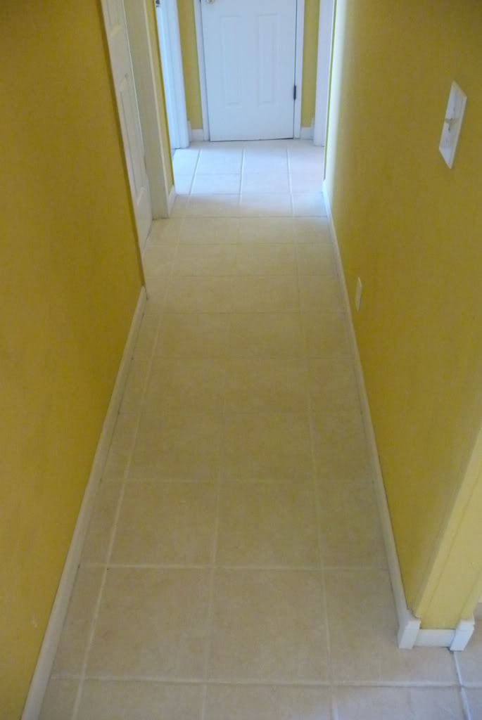

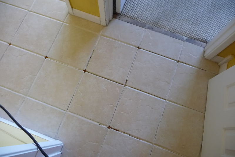

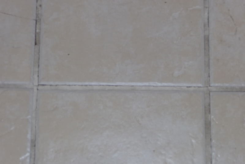

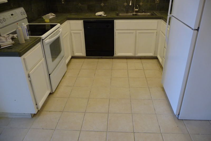

I gave a bid for this job @ Xmas.
They went with a cheaper company that would also clean the whole place (empty rental)
While they got the tile clean the grout still looked like shit.
I recleaned with Oxyblaster, some Restore and regrouted where needed.
After the low baller did it..
And after I did it..
Some one had already color sealed it years ago I wanted to try and touch it up but no go. So we spread some acrylic fortified grout over the stained areas and filled some loose areas.
The whole floor needs to be ripped out in reality but they want one more tenant out of it.
