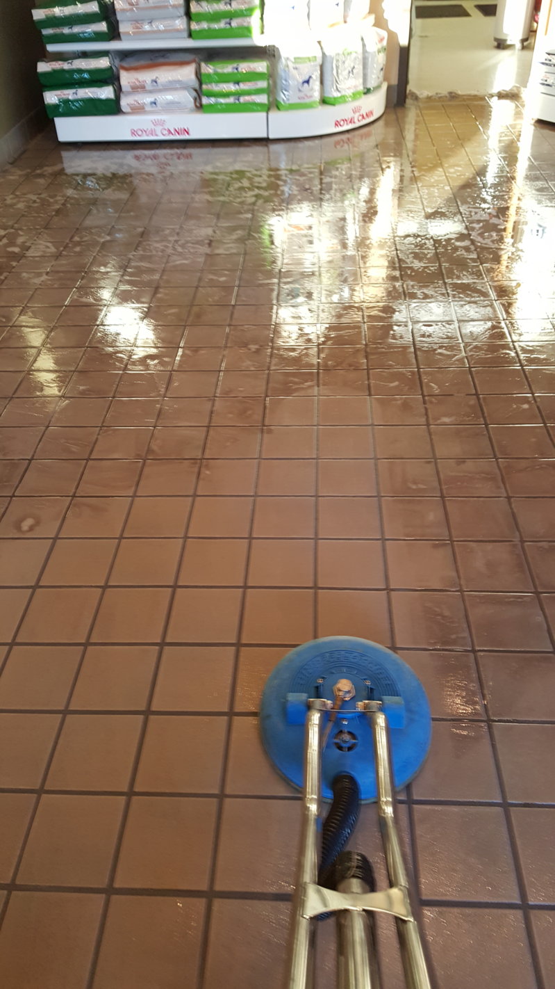

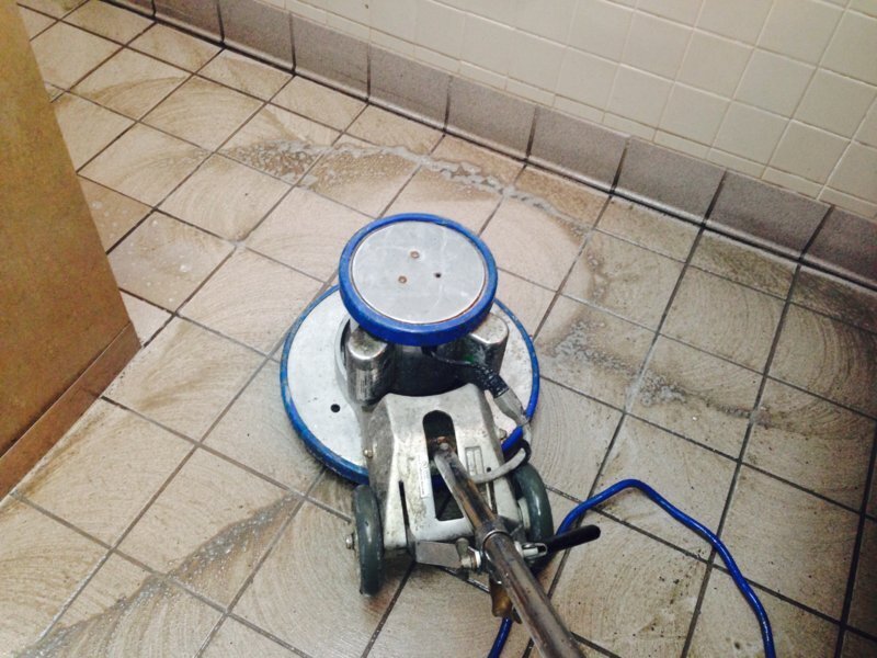

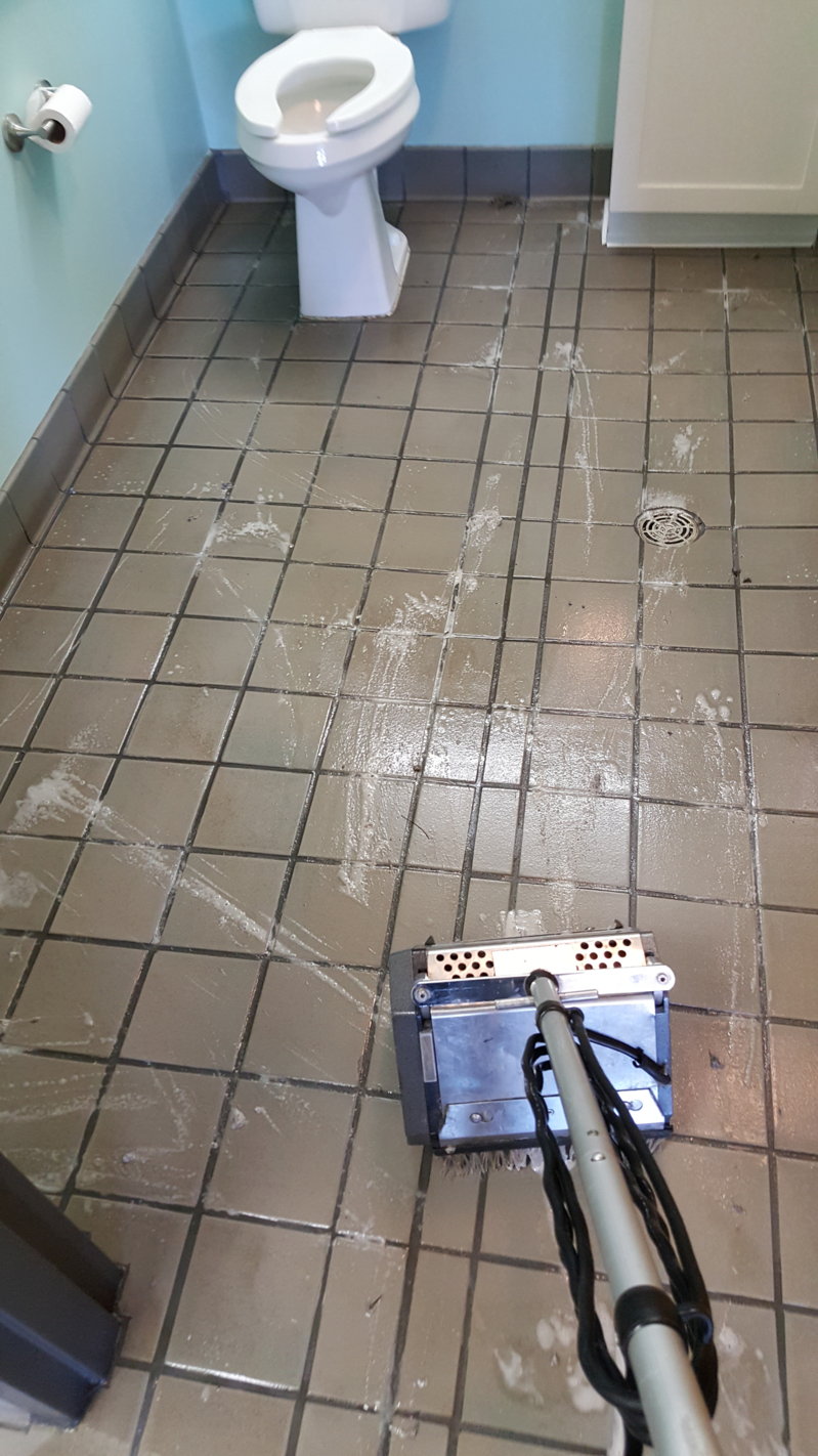

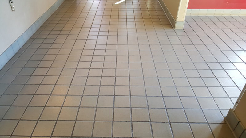

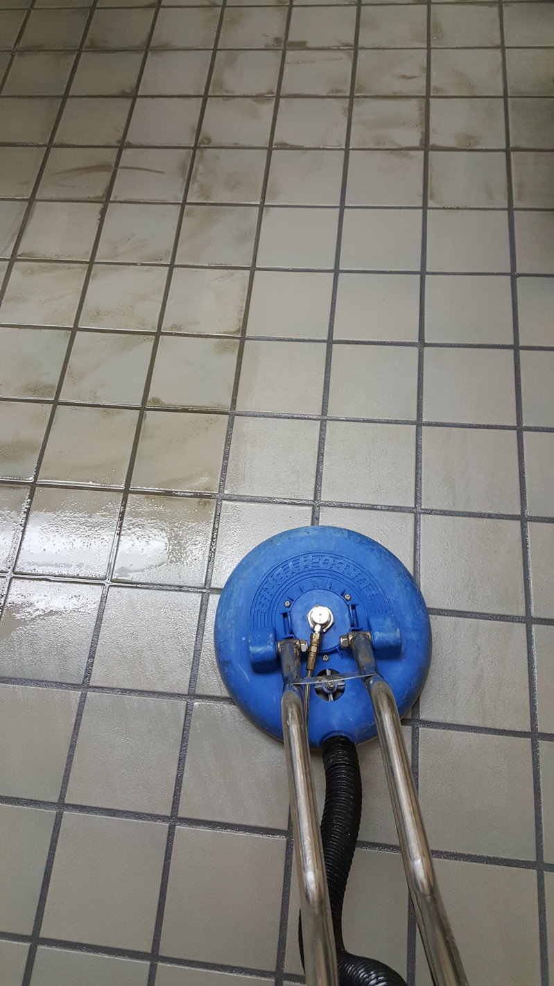

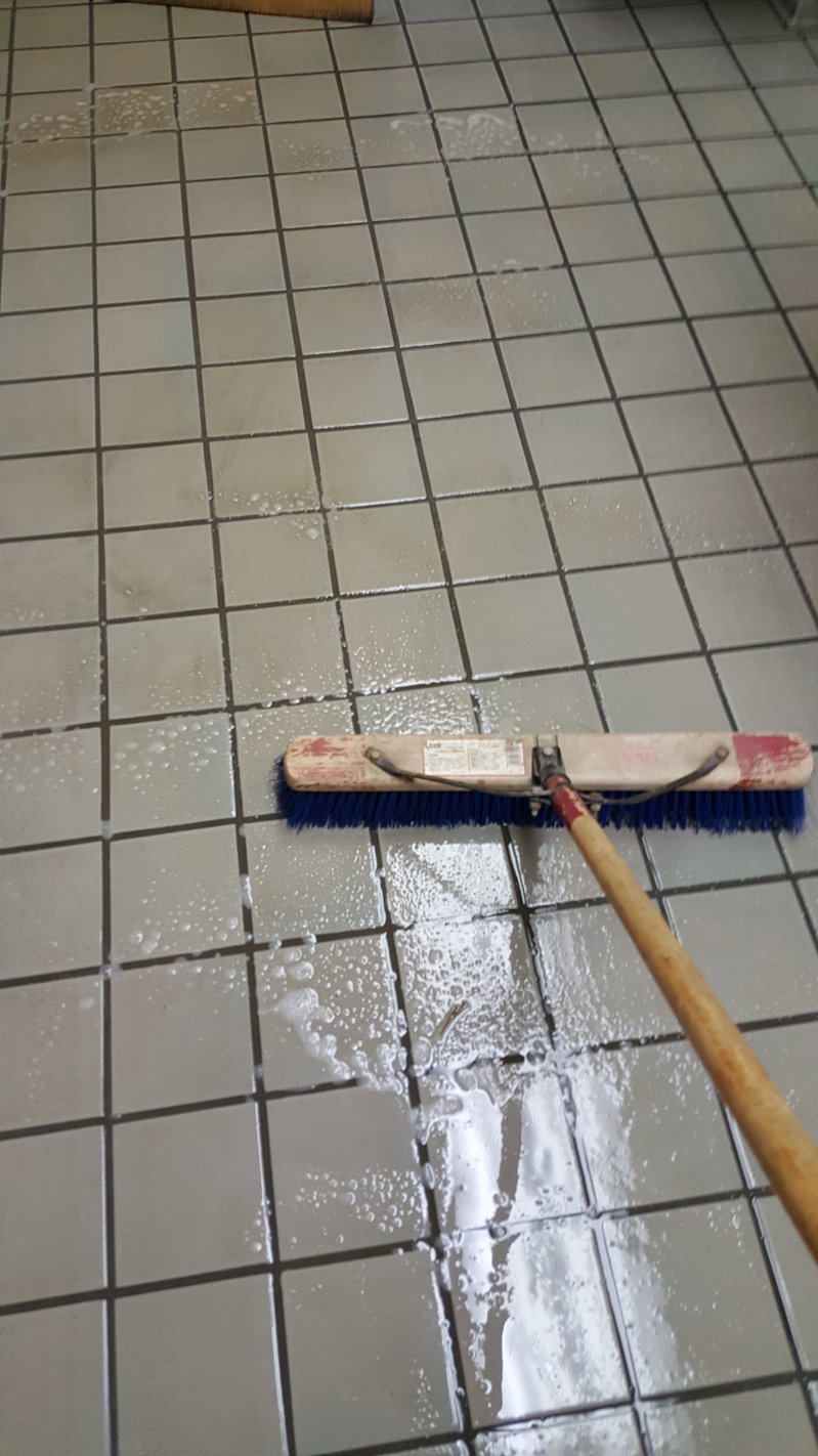

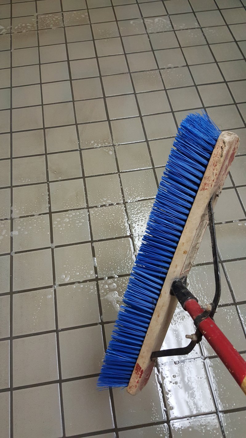

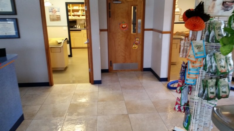

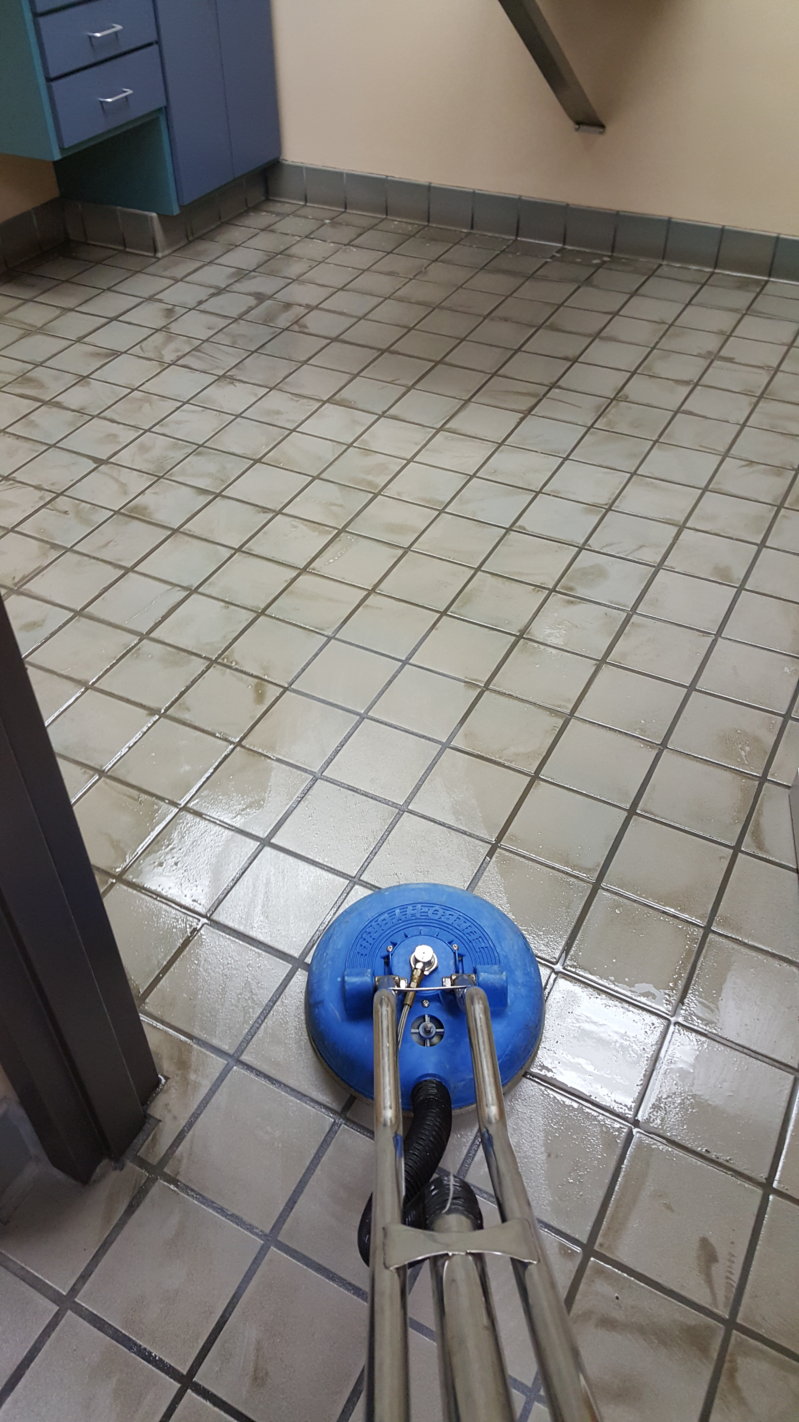

Mark Saiger
Veterinary office....

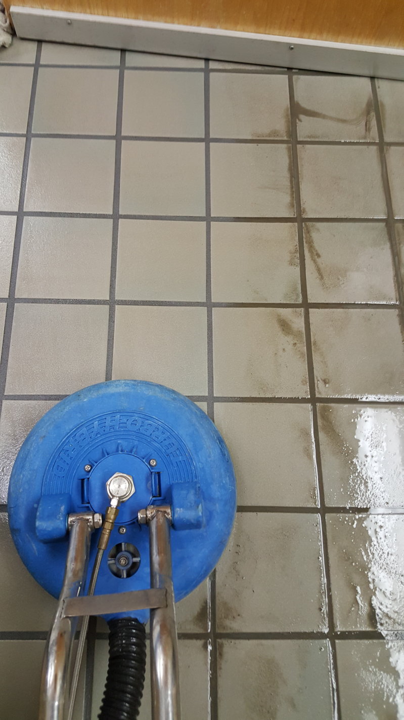

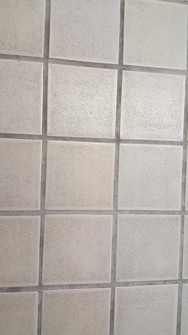

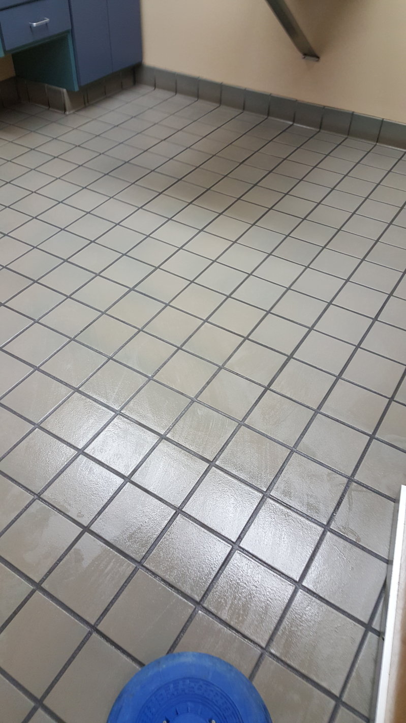

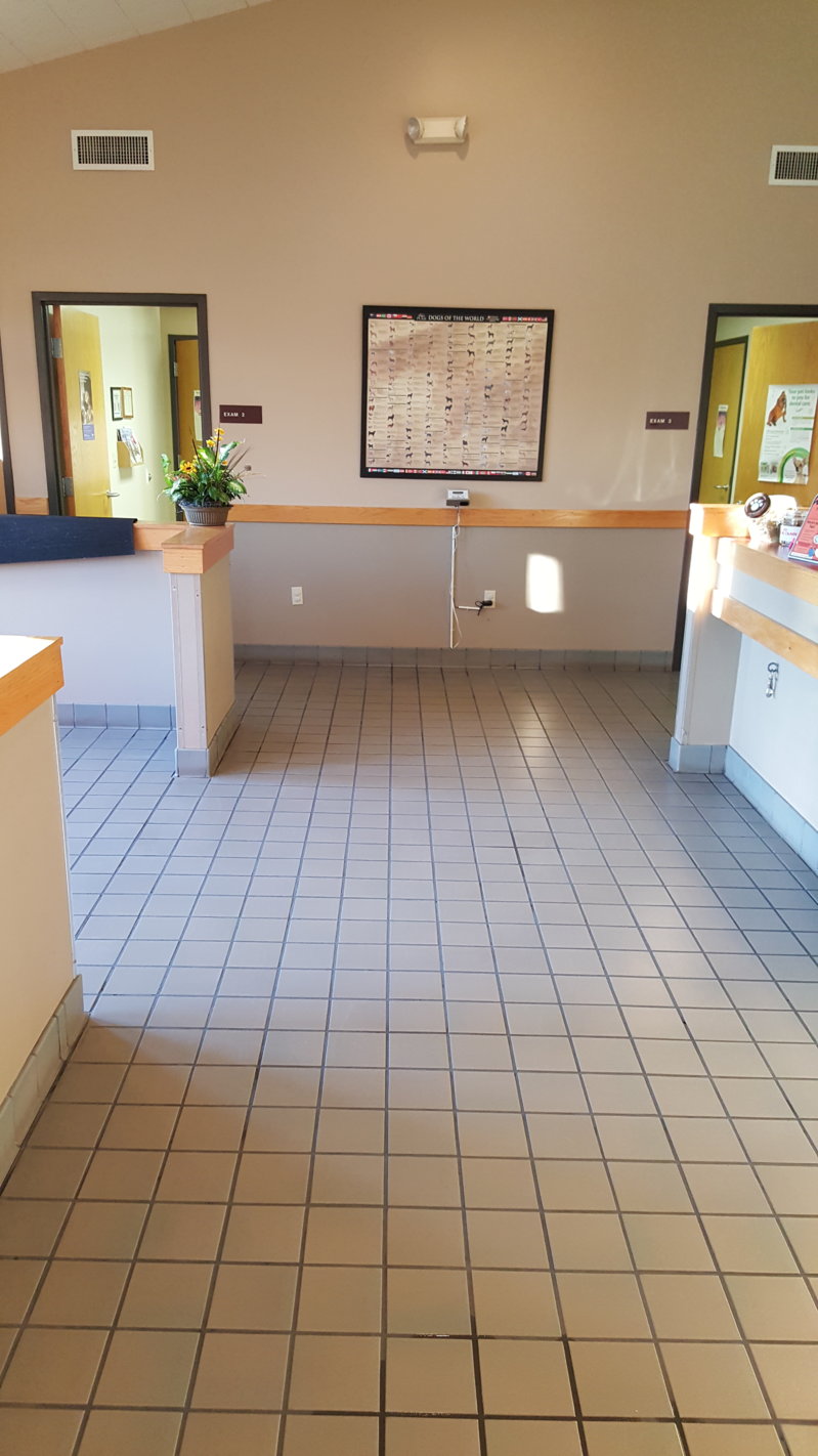

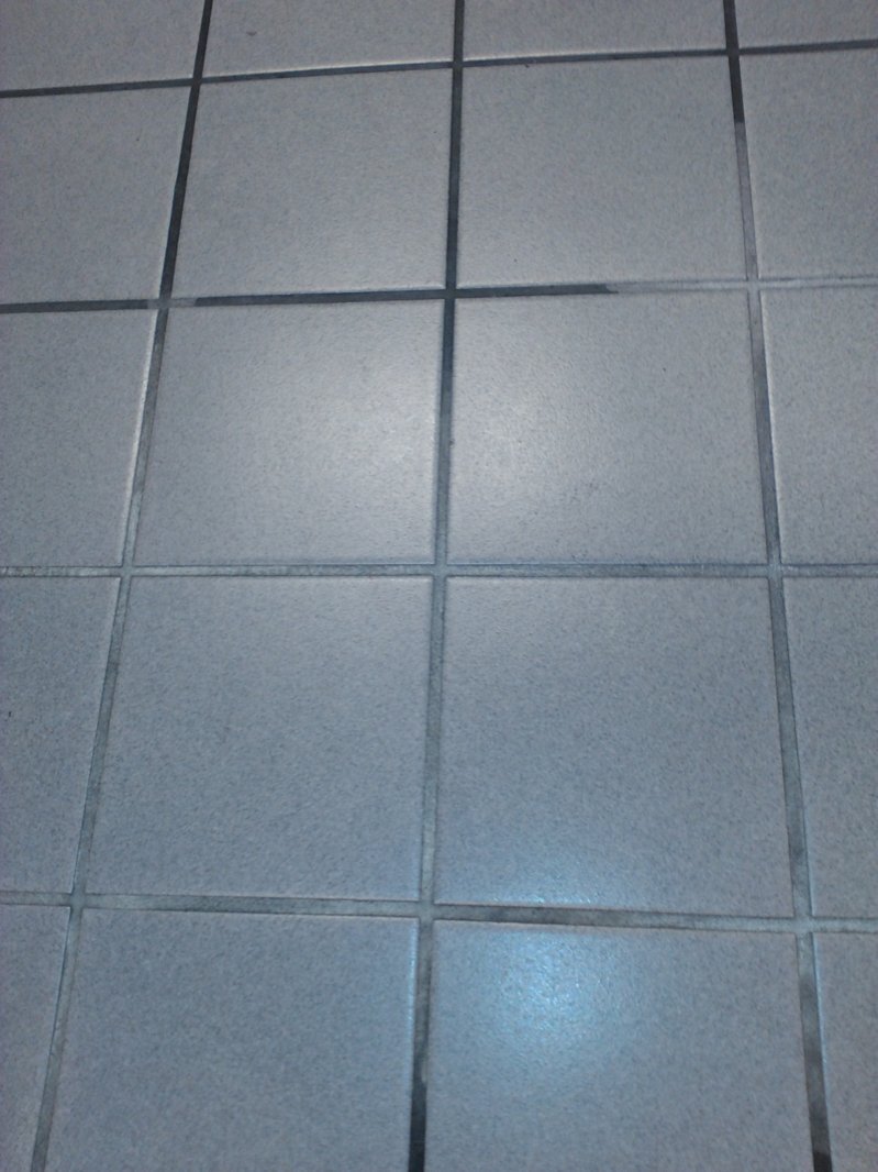

About 30 years old...never professionally cleaned.
Cleaning people using the same mop water going from the VCT to the Tile and Grout and getting wax transfer....
Actually went pretty good....
Interlink Supply Stainless Steel Grout Brush, Some Wax stripper, Saiger Sauce Boosted with the Powdered Citra Zov, my little 7 year old 10 inch CRB....and a good old push broom (I forgot my microfiber mop :hopeless:)
All worked out and got by with 800 psi on the spinner (which worked good with the Zipper SS Super Spinner too)

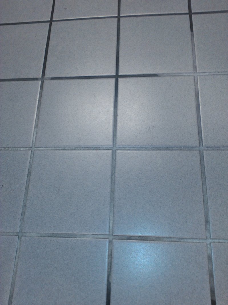

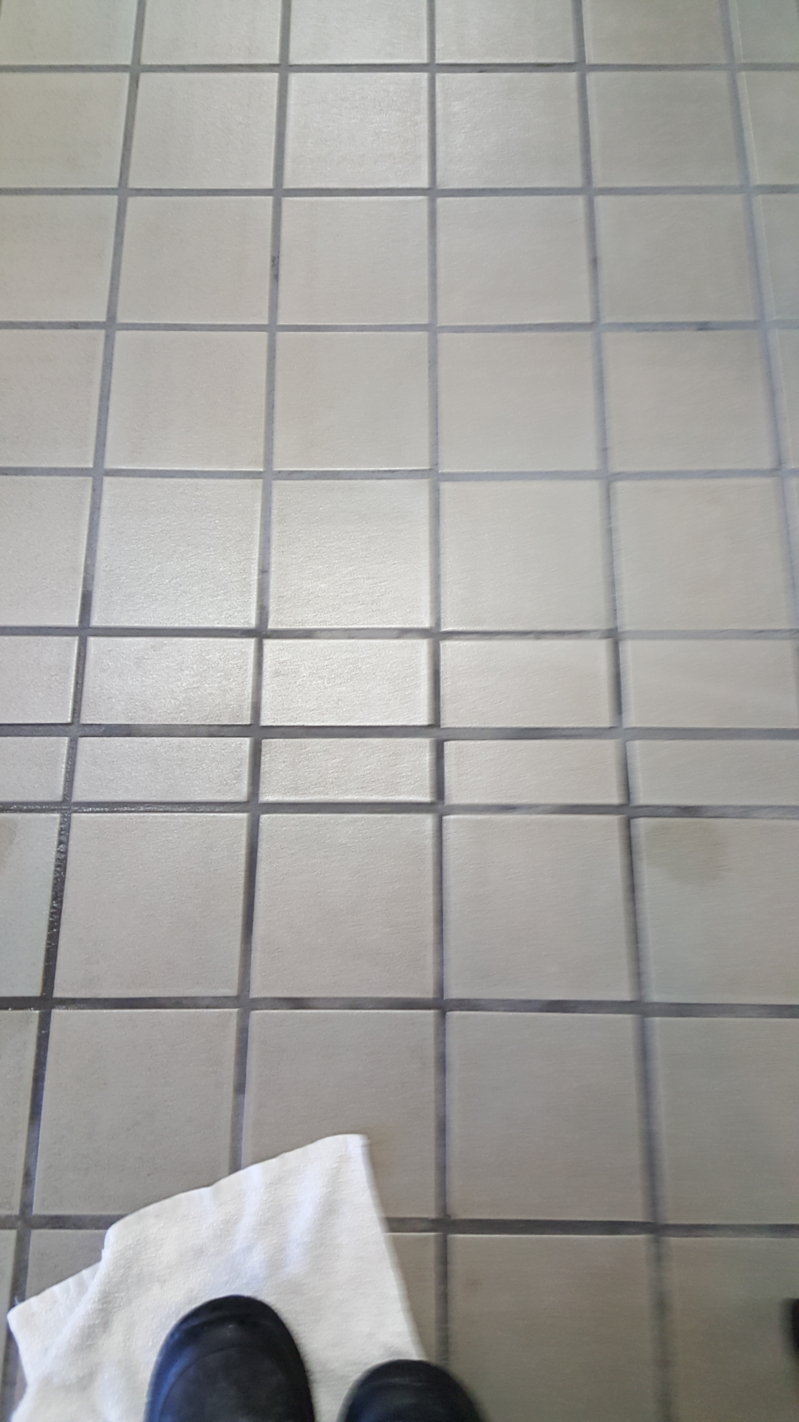

Dirty part close to my feet....cleaner part to the North...Last 3 pics were what it looked like before starting....

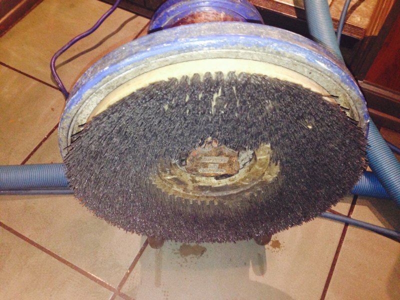

Billy Lewis

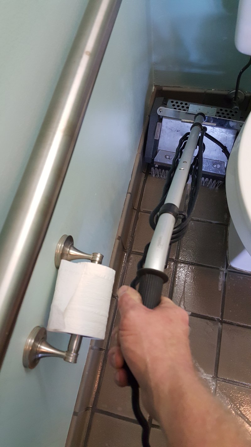

We use a grit brush on a 175. We do add 1/2 the amount of stripper that we use to strip VCT. We empty waste tank before starting such job, then empty at end of day and wash out all filters and inside of tank completely.

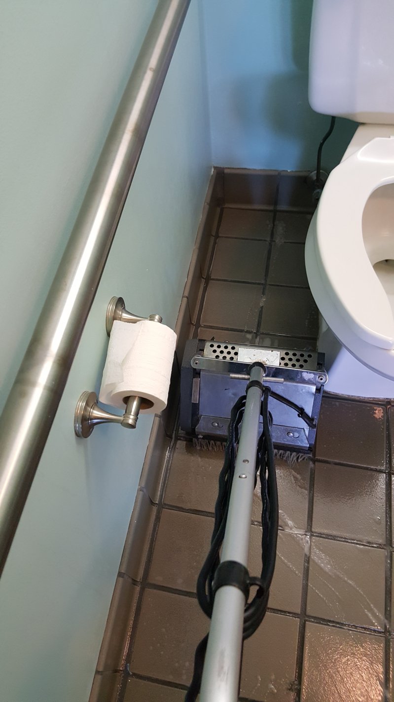

Thank you for this video. You certainly make it look easy but I know full well that is far from the truth.

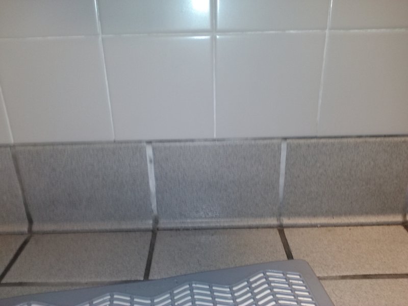

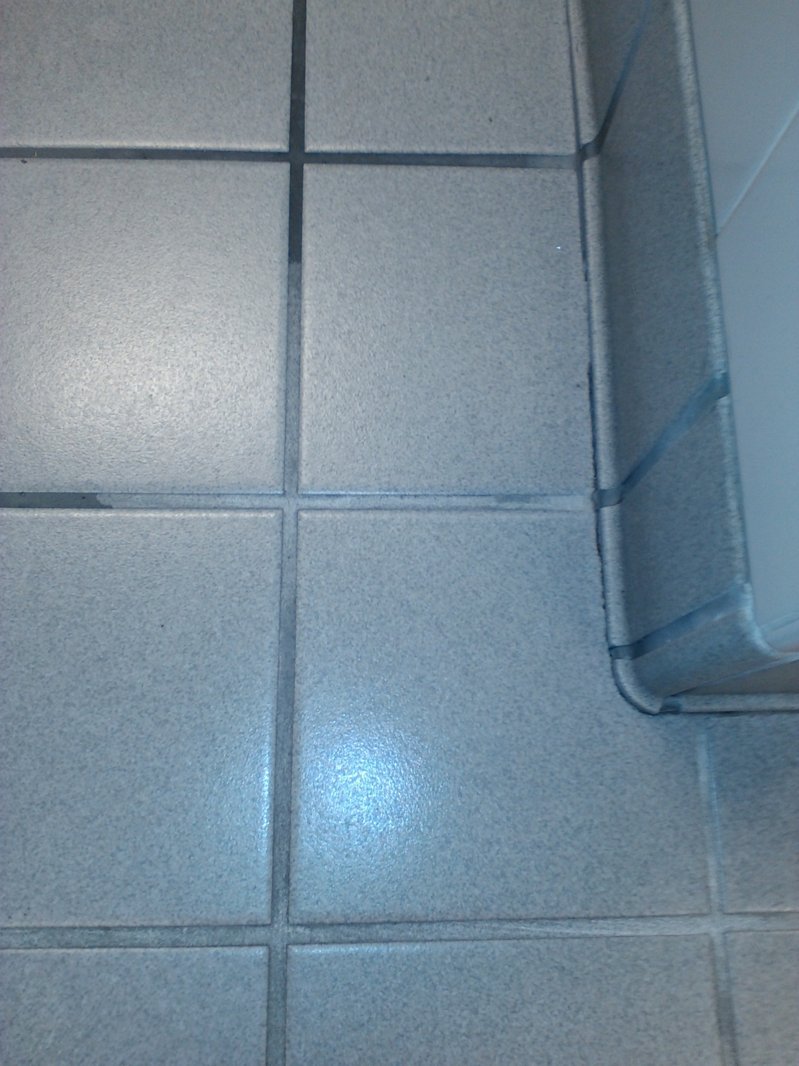

I'm wanting to clean the ground in the bathrooms of the building I clean and some of the grout is discolor. I assume that is partly from the bleach the company insist on using to mop the floors. It was that way before I began cleaning for them. However, I must say it is only in a small area of the bathroom so I'm not so sure it is the bleach. for example in the women's under the hand dryers which I assume is from the water that drips from the employee's hands. Near the sinks and In the men's it's under hand dryer and in middle of floor only and these bathrooms encompass the lockers too. So it's always very busy.
In your opinion what is the best method to clean grout? What equipment/cleaner would be worth investing in and how often do you think deep cleaning grout should be done. This facility is a printing plant for food packaging, it is 24hrs and it is a constant flow of ink on foot traffic.
Thanks for the kind words.
If you were able to maybe post a few pics of the floors that would maybe be helpful to give some suggestions.
Some floors have a lot of other issues, or are just different to clean.
Pics maybe could help us give some ideas and then maybe we can all come up with some ideas that would be best for you and that situation.
Looking forward to helping :)
Thank you for being here and posting by the way. :)

Hey there Stephanie,
Looking at the pics, it looks like there is mainly a lot of embedded soils in the grout.
Not sure what you are cleaning with right now, but it will take a good alkaline based cleaner and some scrubbing to maybe be able to get the soils out of the grout lines.
It might take some wax remover such as the Zep wax stripper mentioned...but you also see that wax stripper could be hard on certain equipment and precautions maybe needed to be taken.
Do you or the company y0u are doing the work at (this work place) supplying equipment and chems?
What are you using now for your cleaning? Are you also doing carpet cleaning there too?
Maybe with these questions answered, we might be able to help a bit more with some equipment and cleaning recommendations.
Those tile and grout squares look pretty similar to what I just cleaned.
With the correct products and tool, a bathroom might not take too long and you could probably make it work out to clean them up.
The Bleach you mentioned they insist on using is maybe to do a sanitize type cleaning, but with those soils still in the grout....there is still not much total sanitizing being accomplished, but it probably just makes them think it is sanitized....and that is their "feel good" feeling.
Removing the soils will help accomplish more of that clean and sanitized moment.
