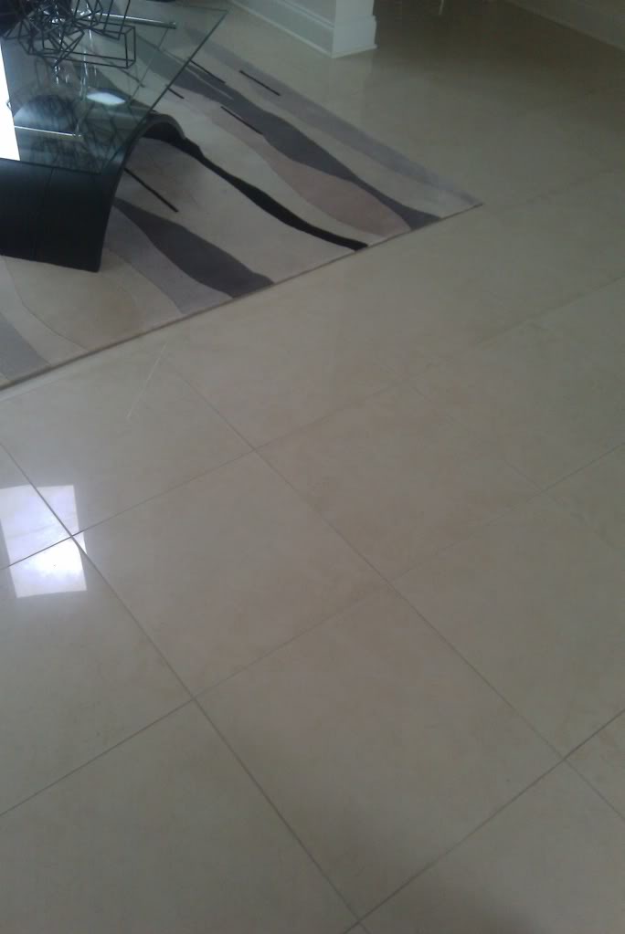

Never cleaned anything like this. Imitation marble. It's just tile, but I would think scrubbing with a 175 would not be good.
I could scrub just the grout lines with a grout brush.
What should I avoid?

avoid acids. find out if they used a sanded grout or unsanded.. *pray for unsanded. If its sandless grout then scrub grout line with good neutral to alkaline cleaner being gentle as you do and keep pressures a little lower. avoid any aggressive floor pads or brushes as to not risk dulling the high polish. And afterwards, force dry and use a white pad to or soft bonnet to buff the sheen. Document, document document any possible etched areas or honed traffic lanes and make sure to expliciltly state that cleaning will not restore the polish of the floor.

by imitation do you mean Porcelain?
I've seen Porcelain that looks just like that.
If that is the case you really can't screw it up, acid or otherwise.

Not worried about cleaning solutions. I was more worried about my brush and 175. I like David's advice.
Customer just wants the grout lines cleaned and sealed.

If its high polish porcelain then like Mike said, you really can't screw up. except how soft the grout is or not.

Thin grout lines means more chance for damage from scrubbing and/or pressure. Make sure you inspect the grout and let them know there may be a hole or two unexposed now that may be exposed later. I hate the ultra thin grout lines.

I did the job yesterday. It was unsanded grout.
The grout was actually very dirty. I used prochem tile cleaner boosted with oxy. I scrubed the lines with a grout brush and the dirt really came out. A 175 would have been faster, but I did not have one with me.
The grout cleaned up good, but still there were some places that I guess it was just stained. To be the fair though the grout needs to completely dry before any conclussions can be made, but I know the grout will not be pristine white uniformly. I exlained that to the customer, and told him the only way to achieve that was with color seal. Acid washing would not have that, and the grout was not in the best of shape.
