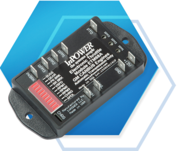

I've come across that, but is that pretty much the only way they control it?
Do the PTO's require you to leave the key in the ignition or that box controls it so you can remove it?

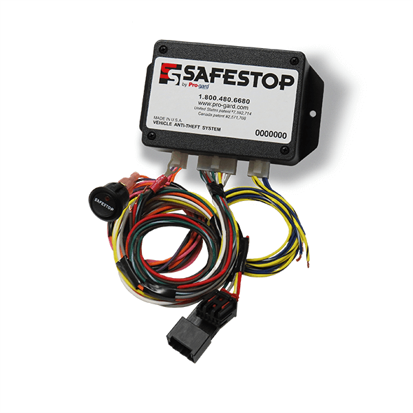

I'm been looking at the SAFESTOP that police cruisers use, enabling you to remove the key from the ignition leaving the vehicle running.. If someone were to try and press the brake or put it into gear it kills the engine..
I basically have no trust with leaving a running vehicle unattended while I'm 100'+ away.. I don't clean in the ghetto, but nowadays people will chance anything..

We use the ETM68A that @anon referenced as well as a parking brake relay so the parking brake has to be set in order for the machine to be on/stay on. If the parking brake is released it will kill the machine, however the key does have to remain in the ignition. I have never looked into the Safestop.
Reactions: Nate The Great
Yeah. I looked it up when you mentioned it. What I couldn't find is if there is a timed shutdown or it remains on continuously. I wondered because I thought a remote start module would serve the same purpose but I think I can only program mine (Firstech FT-DC3-LC) to remain running for 45 minutes.

Yes all the alarm installers say it’s only a 20 minute program.. I ASSume the SafeStop keeps running until you or something shuts it down.. I do like the feature if someone were to try and drive you vehicle off, It supposedly won’t start again until the key is present..
But again, where there’s a will, someone will find a way to bypass it.. I would just like piece of mind..
