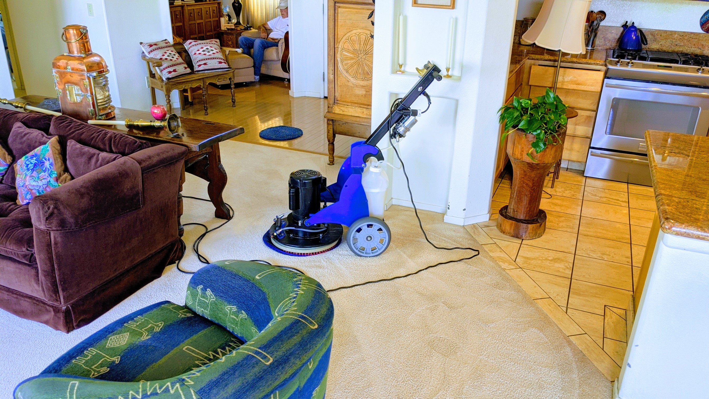

Three visits since the start of Coronagate led to this INCREDIBLE decision! ASMR!
116,245
Nice old couple in there late '80s been all over the world have a white shitty soft touch tech nylon carpet that shows every wine, blood, wine, and coffee spill and wine of which they're constantly making since they haven't left the house since all this bullshit started
the freshly stained deck, local blacktop, filthy garage, husband with Alzheimer's that doesn't take his shoes off
They're making at least 20 to 30 new spots a month and dragging dirt in from outside.. 1st two times I gave it the major mega steam cleaning w/ all fiber rinse and it looks great but one month later looks like shit and they've been cleaning it and cleaning it and cleaning it with everybody in town .. They like me and are willing to pay my more than double rates..
But I'm embarrassed that it only stays clean for a month regardless of whose fault it is
So I tried the PHX this visit and was able to get out a very deep wine stain, some blood and 30 others mystery spots and leave it all nice and bright
Remarkably, I got rid of some cornrowing of which I'll be interested to see if it stays away
I did the whole LDH & master bedroom with two blues and two glads and one gallon of Encap, a little bit of peroxide, a little bit of Tops Spot and a little bit of Chemspec tannin remover
Front door stayed closed keeping me nice and cool, took me half the time as usual and all she wanted was an explination at the end of where the dirt went and appeared to have bought my foam core explanation no ifs ands or buts..

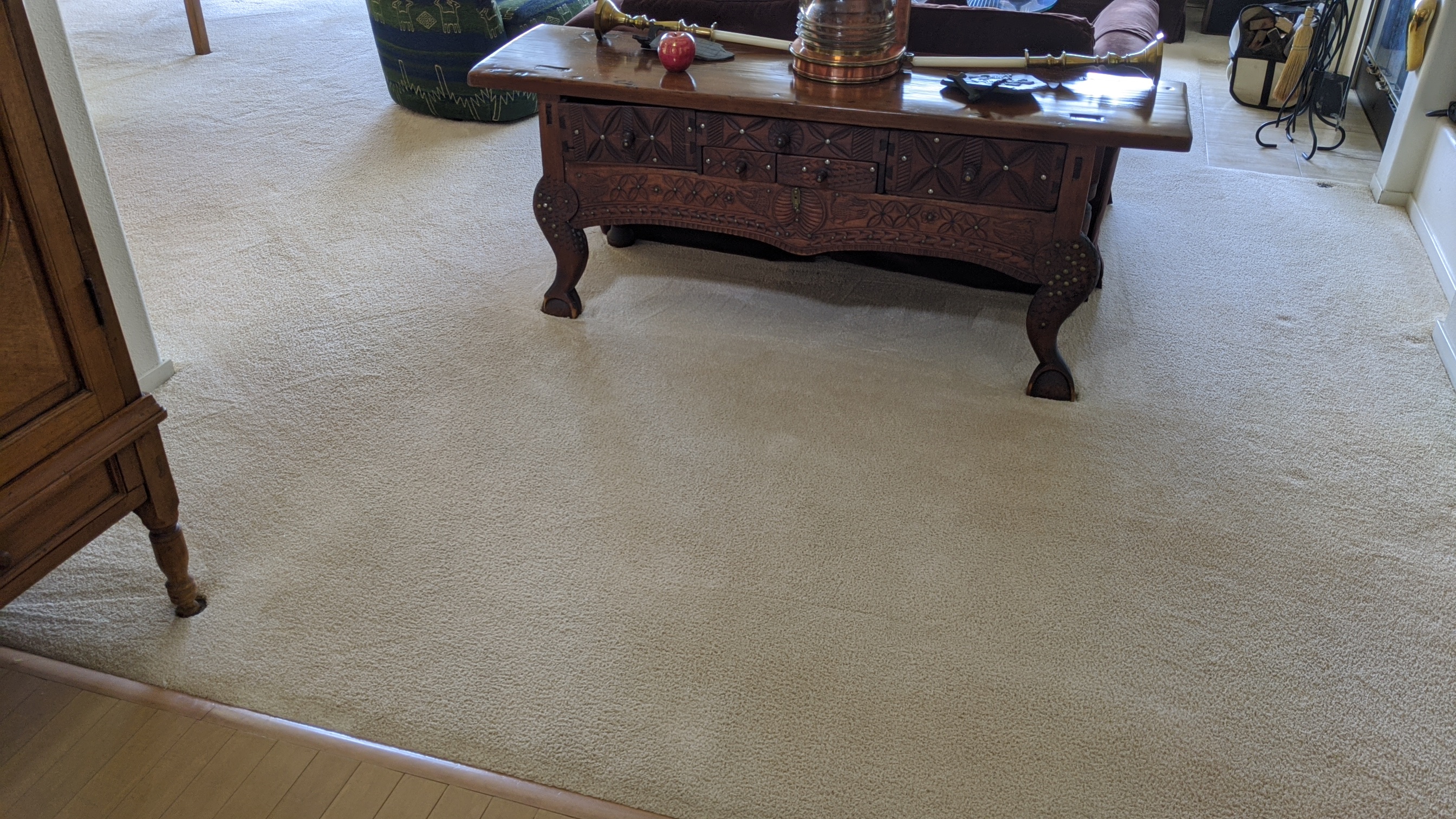

Is that second picture an after? Definitely looks like it needs a good rinse.

Think about it Steam Cleaners, the carpet was thoroughly Multi Stepped HWE'd TWICE in the last three months and poorly HWE'd at least a dozen times over it's life.
Could I have Extracted again and applied a protector and hoped for it to have bonded and provided some benefit? Sure...
But rather, I cleaned the very light soil,but heavily stained situation, made it look actually a bit better than when I've HWE'd ( less fiber distortion) and now effectively loaded with the best soil retardent in the the industry, an Encap Polymer...
Somehow I think they'll be very pleased.
