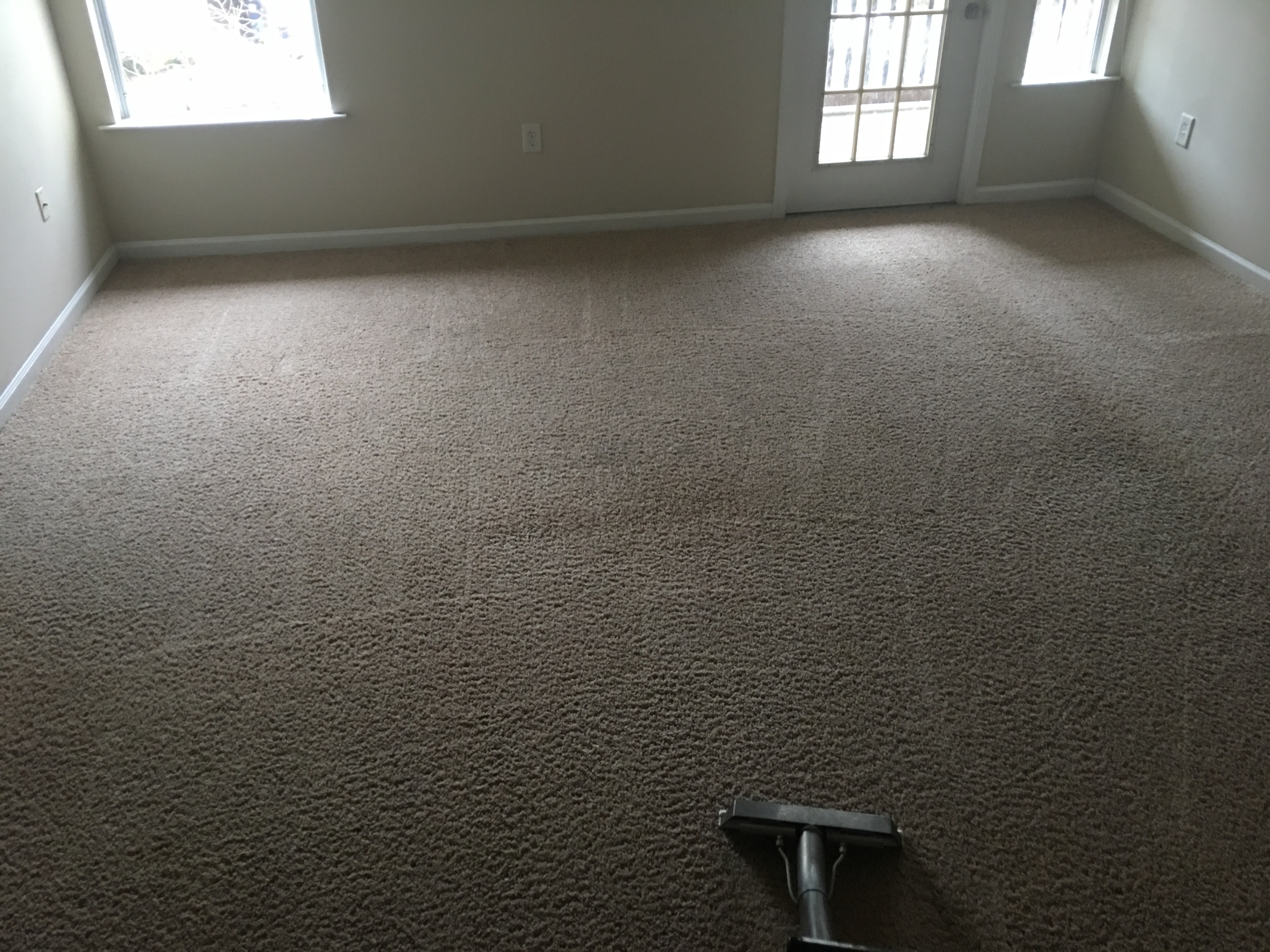

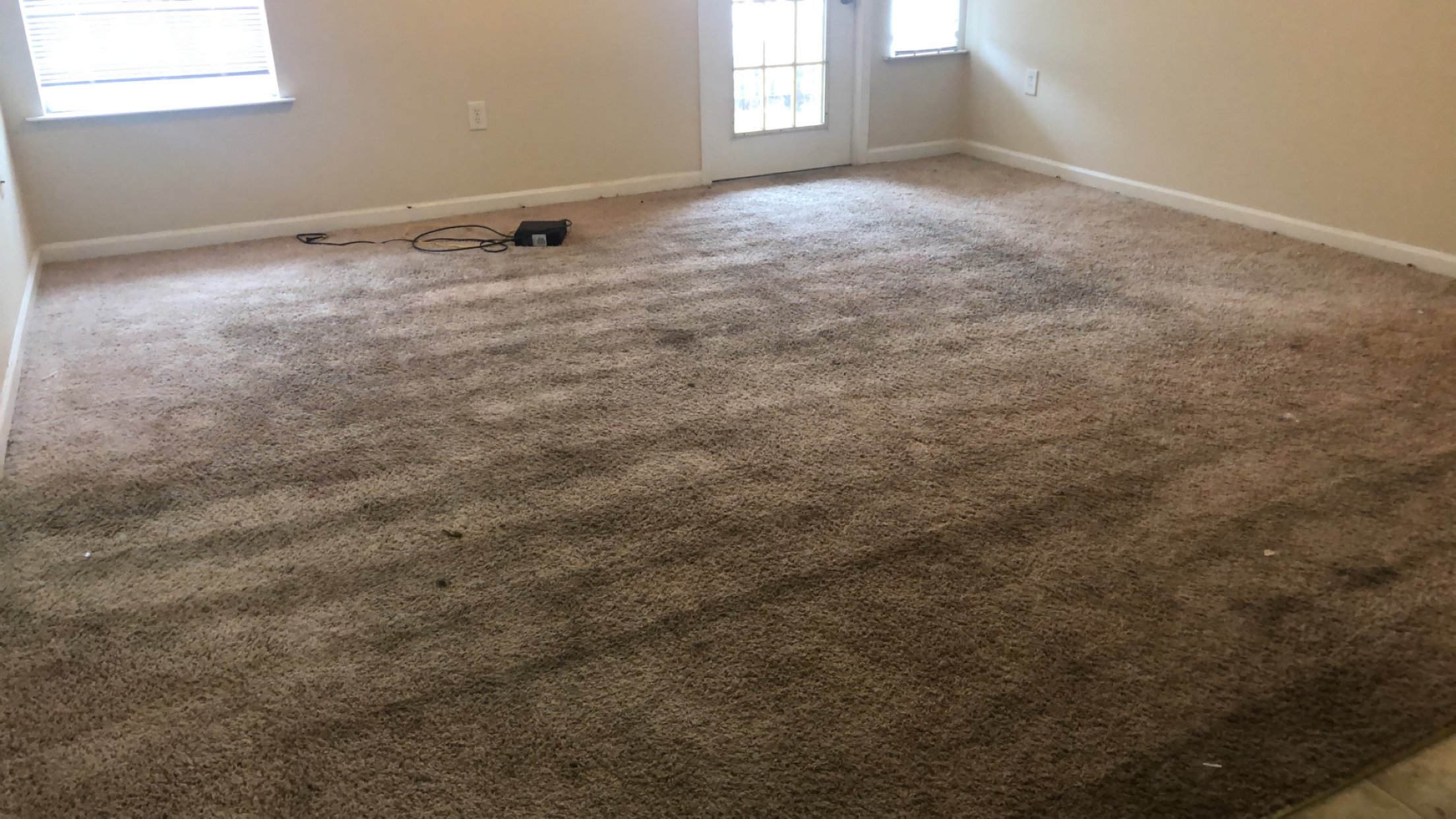

This job needed one and proof is in the Pics. There was so much junk pulled up After I vacuumed. I doubt it would’ve looked this good if I skipped CRB.
There was no special mix of prespray. Just a plain Jane jug of it.

A CRB doesn’t rinse away your pre spray.
Which provides more valuable dwell time.
It brings junk to the surface that truck mounts would most likely leave behind.
I like a rotary wand if a carpet needs to be flushed to hell and back.
