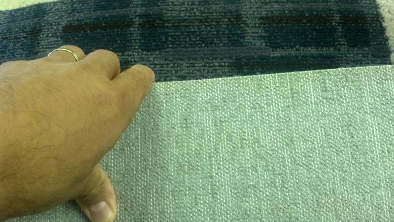

2013-09-11_11-19-50_754_zps72df0813.jpg This is the backing, had it been the hard vinyl I would agree it should come up.
So if they were rubber backed you would have removed them to dry the subfloor, and then dry the tile seperately off site... or do you pitch them and theyre replaced ?
Rubber back the Rover extracts them very well and with the right setup can dry in a day two at the most. If they are vinyl back we would have dried the face, then pulled them up and moved the out of the affected area. Then dried the concrete to get to the trapped moisture.
The vinyl just doesn't allow the trapped moisture that got down between the tiles to move though them. Its a vapor barrier we've tried heat, air flow, dehumidification and still when you pull a tile there is moisture there. I think you would have to create super low vapor pressure in order to get it to move if that. It's more cost effective to dry it, move it and dry the remaining moisture.
If you don't remove them I think you'll find you'll the moisture in the concrete will cause you a problem. That moisture combined with the dirt and dust and glue become a food source and you get some microbial activity beneath the vinyl, causing you some odor.
Vinyl back tiles are really very durable and usually come out fine. If they have some inventory they generally keep all the solid tiles and replace the special cuts with the new inventory.
Cardboard works best to cover up the glue on the concrete while the tiles are out. Installer don't use nearly as much glue on the vinyl tiles because they are designed to be rotated in and out as they wear a traffic pattern. Those tiles we have here in the shop were glued heavily, they should have been dried in place.
