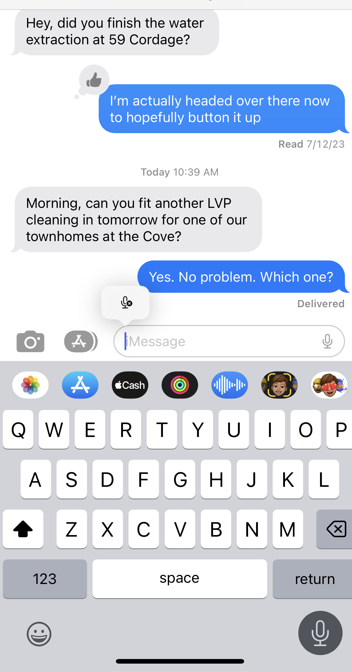

These PM’s are starting to get hooked on this Brush Glide
