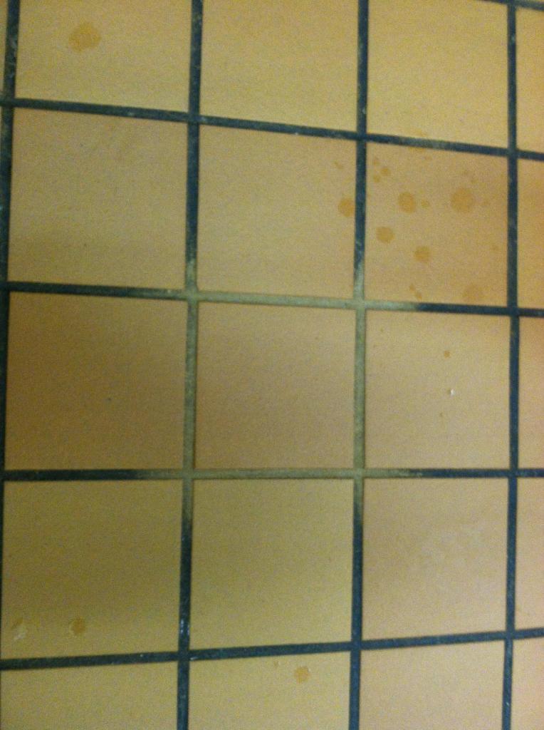

thats because the grout was not dirty in the first place...this was a warranty job where the 95 year old home owner could not keep the TILE clean.

I'd love to see a video on color seal, especially 1inch tile
Here you go -
Worst case, about 200 sq ft/hr around toilets & under partitions. Open area, at least 500 sq ft/hr. Material cost under 10 cents/sq ft. Average selling price (after cleaning) about$1/ sq ft. On a maintenance contract, mop with mild alkaline, spin it at low pressure & temp. Touch up around urinals or high lines in a couple minutes by mixing up a shot glass full of original color from core colors on truck.
