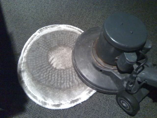

Most important step. Use that same 175 and some cotton or cotton blend PADS to go over and over the heavy traffic areas until you once again puke. No matter what pre spray you used or what toxic rinse you purged it with you'll be amazed at what is still hiding down there.
By post padding heavily used CGD you'll pull up soil that no single method alone can get up. You'll run into some areas that will never come clean. Use at least six sides in those areas.
Creating Michelins is the insiders name for this step. use both sides of the pad.
Hurby, Vac A Way and Guerkink have these pads for sale

"Don't soak the carpet two light passes with a HF will do"
Isn't that statement an oxymoron? HF are soakers.I haven't used one in years,wastes too much water as well as product.
#2: A dampened op pad works just as well if not better because you are actually picking up soil.
#3 is optional,not necessary.
Other than that,your post is old school but on the money.
