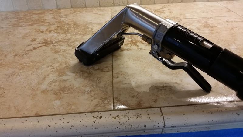

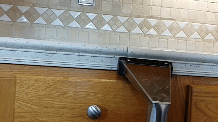

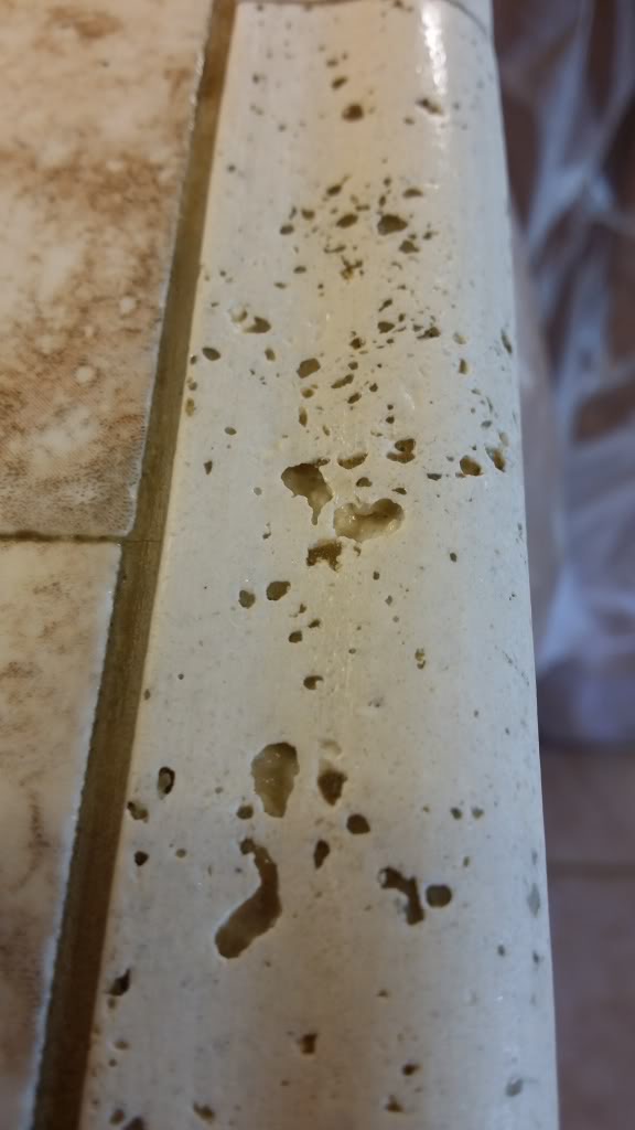

Porcelain tile counter, real Travertine bullnose.
quick $175 up-sell in 45 minutes.
No seal as they are selling the house and DGAS
these hole were LOADED with crud. SS toof brush and some Flex broke it loose, the PMF MB hand tool sucked (blasted) it out..
Gentle rocking technique gets the grooves and crevices clean with out soaking the cabinets or floor.

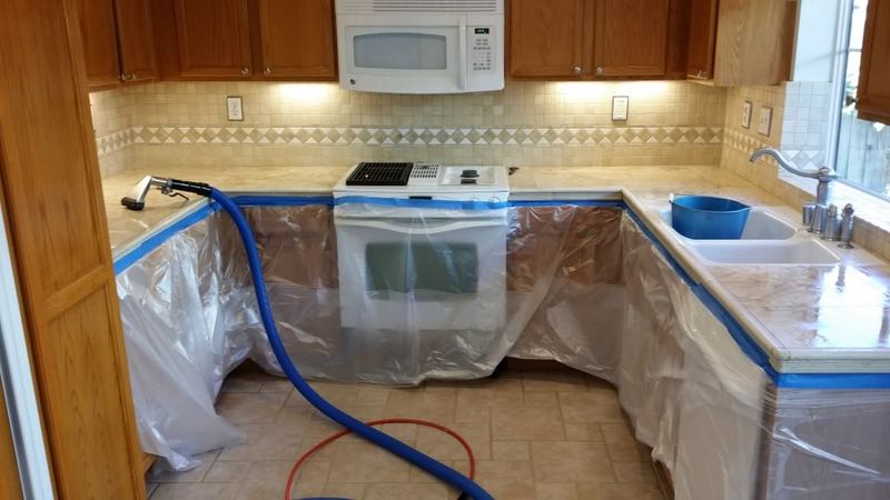

Good job! Nice to see you taped things off. I love your tool! Where did you get that one? Oops. Never mind found it!
Wandslinger
1,005
Simi Valley
Tom Meyer
Hey Mike,
Are you put the plastic up to it and then taping? I buy the 48 inch roll and put it on the one of those paint maskers with the tape roll on it. Affix the top of it to just under the cabinet and then pull on the bottom/skirt. Falls right down to the floor. Easy as 1,2,3
