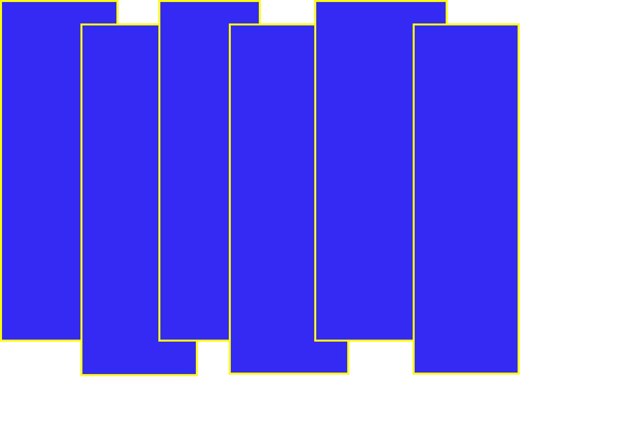

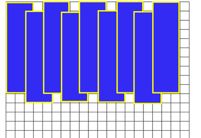

The proper wand stroke will ALWAYS produce better results.
We have figured out that 2 wands moving at the same time (running dual wands in different parts of the jobsite) will produce excellent results and will cut our time at the job by about 40%.
Time is money as long as you are still doing an excellent job.
unfortunately not
I compensate with my ss12 by overlapping by 1/2 for extra rinsing as was suprised what the window showed
