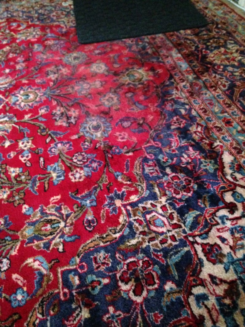

this was a wonderful rug!
The dog had his way with it,
I see the owner attempted to remove the problem and looks like some really bad fugitive color migration, I think I'm in over my head on this one. I would love to just use the
UrineLock™ - Bio Enzyme Odor Encapsulation gallon I won here on the raffle ;)
The color, the odor, the lady, what can I do

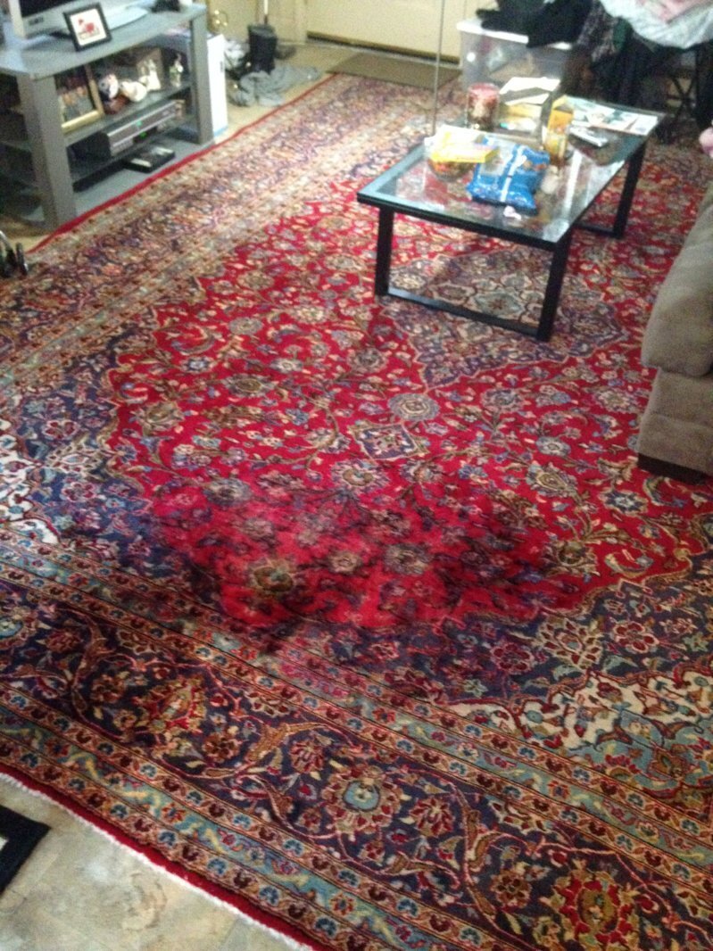

Ken692
Jul 12, 2015
405
Boston
Kenny
Here I cleaned it with all fiber low ph but its still got problems, some damage on the back. Can I use the edic to inject the bio-enzyme? Can this be repaired? Is it worth it?
27,878
There is nothing more you can do. It needs to go to a professional shop for repairs. Up to the owner if it is worth it. Check in your neighborhood if anyone does rug repairs.
Ken692
Jul 12, 2015
405
Boston
Kenny
I did watch Aaron's webinar and I can do a lot of what he said. The rug has bleed and I fell I can fix a lot of that but when you say repair are you talking the hole? That I agree needs a pro, I don't feel comfortable cutting in a patch, but I have all the items Aaron was showing us, the steam, the air brush, the odor remover, and the rug was washed and still looks awesome it's not pink. I feel like they put this in my hands and just want the best they can get. I hate to send it off when I'm trying to build this carpet company of mine and I'll never learn or make a living if I just send off the items to someone else. I really need to get up and running with this type of repairs. With this damage already done, cant I make these repairs here at some point. I really fell in love with this huge rug. I think I broke my finger moving it (ouch i.e. )
What is it worth and are you willing to take responsibility for it? I wouldn't tough it unless the owner has signed off of it as salvage. The urine could have freed up dyes that will migrate when you start cleaning.
Proceed slowly test an area before jumping in fully.

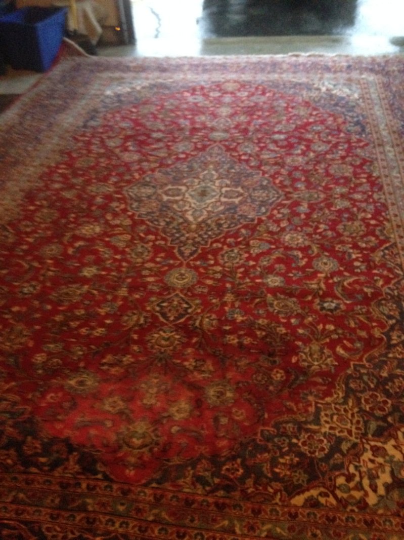

Ken692
Jul 12, 2015
405
Boston
Kenny
Its getting better, I think I'm going to order some magic dye and stain, I searched and searched for some without $20 shipping, crap it can't cost that much for a small jar, $47
Jondon wants $350 for 12 jars I don't need that much.

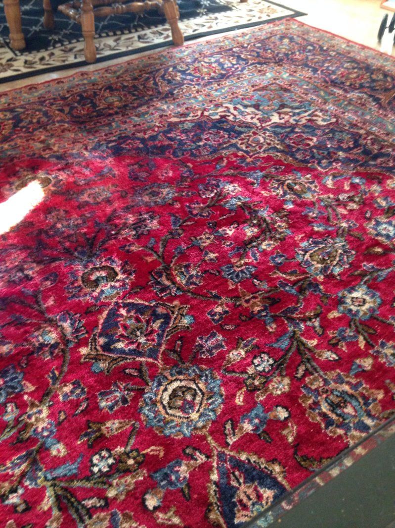

Ken692
Jul 12, 2015
405
Boston
Kenny
Here is where it's at now, the huge washout is now a small bleeding
sweendogg
Jan 15, 2008
3,534
Bloomington, IL 61704
David Sweeney
The urine caused the migration. This is not a rug to try and fix yourself, even with Magic. It will remove all the colors with out effort if your not careful, and those are some very small areas to be attempting dye correction on for the first time. There are safer ways to strip the colors out of this rug but only by people who are doing this day in and day out. You should skip this trial and error on their rug and take it to BonTon there in Boston and have them correct it. Its not a cheap option, but its cheaper than getting stuck with the cost of replacing that rug. If the customer is blaming you, this will make you shine, rather than causing additional bleaching or damage.

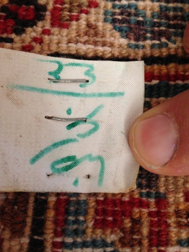

Anyone know what this may be?

Ken692
Jul 12, 2015
405
Boston
Kenny
This is the washout, the wool seems crispy, but looks like I got the stink out.
