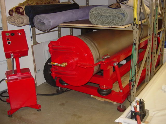

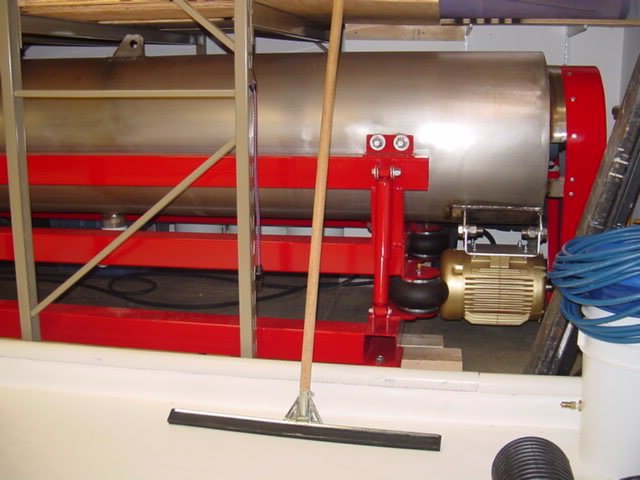

Clark came up yesterday with the new centrifuge. This is an awesome looking machine. It is set to run up to 1300 rpm. The other unit I looked at was jumping around on the floor at 700 rpm. It has virtually no movement at all. I can slow the machine, fill it with fresh rinse water, meter in whatever chems I choose and then spin it out again, just like a washing machine.
I've got a batch to clean tomorrow. I'll try to share an update and a picture.
DavidVB
Oct 19, 2006
169
This is the first unit of Clark's new design. I've seen the Turkish units at his shop. This blows them away. It is exactly 4 feet wide, 44 inches tall. The inner cylinder is 10.5 feet and the overall length is about 11.5 ft. (Inner and outer cylinders are heavy stainless steel.) It also uses a free standing control stand.
Clark decided against the 18 inch bearings and open design. The front bearing is in a door. It looks like your loading a cannon. Clark said he ran it up to about 2000 rpm, but saw no use for that speed. I think his bearing design has a lot to do with its stability. Plus he has combined air springs with shock absorbers to stabilize it just like a car or truck.

The machine I delivered to David is not Ron's unit. The photos David posted are of Ron's machine. David's machine was in storage. If David could post pictures of his machine you will see the difference. Ron's machine is polished SS with a seam at the top. David's machine is brushed SS with no seam. No SS bolts on the door. Ron's machine is in my shop today. The controller is much different as well. David's machine is single phase voltage. Ron's machine is 3 phase voltage. No lifting eye on top.

I took a couple pictures if anyone is still interested. Hopefully this won't upset anyone. It is kind of shiny but that isn't why I bought it.
