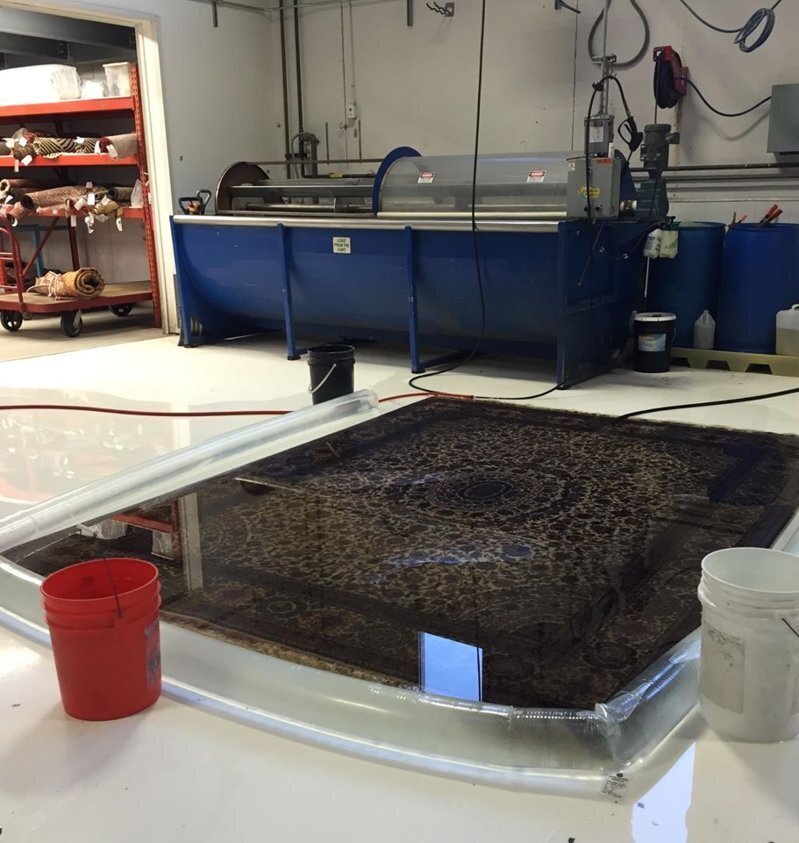

You can also fill the smaller diameter tubes with water to make quick soaking enclosures on the wash floor. (Robert Mann's idea is inexpensive)
