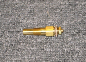

Mar 2, 2022 #2 Dolly Llama Number 5 Joined Oct 7, 2006 Messages 31,225 Location North East Ohio Name Larry Capitoni cub234 said: how do I stop a leak on my temp sensor Prochem Legend Click to expand... This thing? Sensor, Temperature Gauge Temperature gauge sensor. www.jondon.com ..L.T.A.

Mar 2, 2022 #3 Nomad74 Boy Sprout Joined Feb 4, 2016 Messages 24,051 Location Redding Try a bit of teflon tape around the threads.
Mar 3, 2022 #4 N Numero Uno Member Joined Oct 16, 2006 Messages 1,906 Location Ma Name Caesar Has to be a minor repair. Re insert correctly. Make sure threads are in correctly. Good luck. Not sure what torque would be a good snug should suffice
Mar 3, 2022 #5 K KevinD Member Joined Nov 23, 2006 Messages 2,464 Location Binghamton,New York Name Kevin Dumas Depends on where it is leaking. The only leak that is fixable is if it is leaking around the threads. Anywhere else it is toast.
Mar 3, 2022 #6 Doug Rice Supportive Member Joined Feb 28, 2011 Messages 425 Find out what temp and go to the auto parts store and get a new one if it doesn't stop after sealing the threads.
Mar 4, 2022 #7 sassyotto Member Joined Jun 7, 2013 Messages 1,205 Location Wisconsin Name Paul leaking Externally or Internally?

Mar 5, 2022 #10 cub234 Member Joined May 10, 2021 Messages 21 Location Willowbrook Illinois Name Steven D'Aquila thank you for all the replies! I unthreaded it and reinstalled and seemed to stop leaking Reactions: KevinD, Dolly Llama and Nomad74
