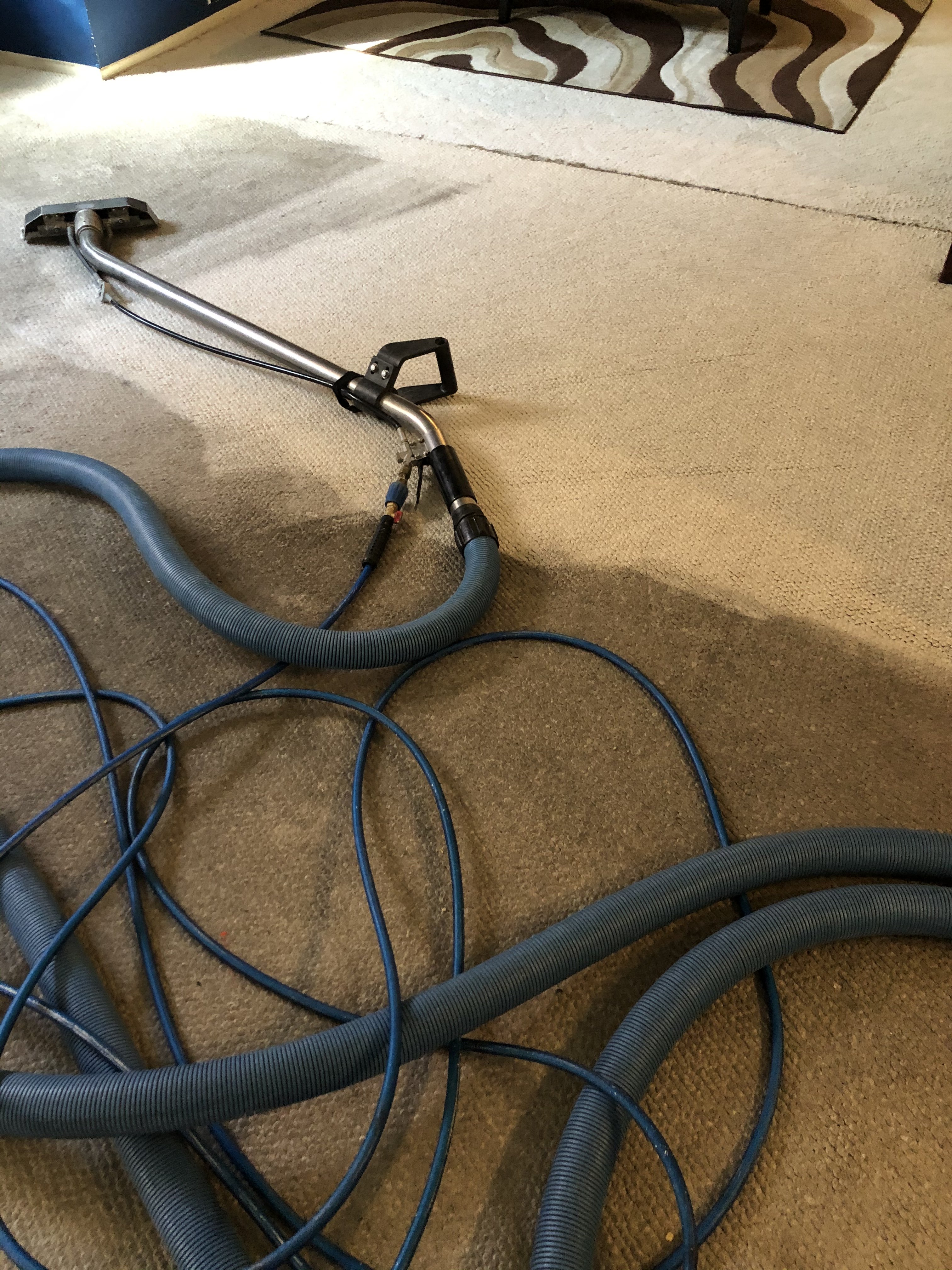

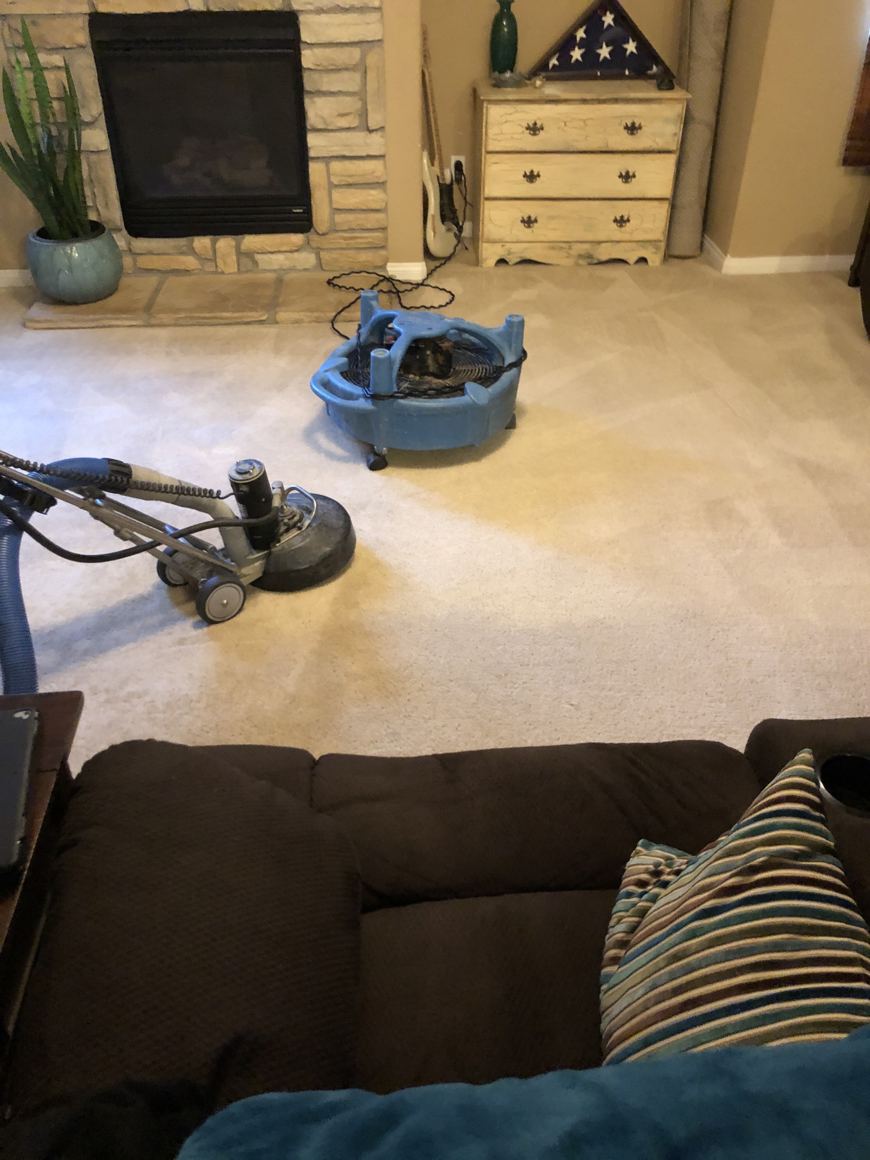

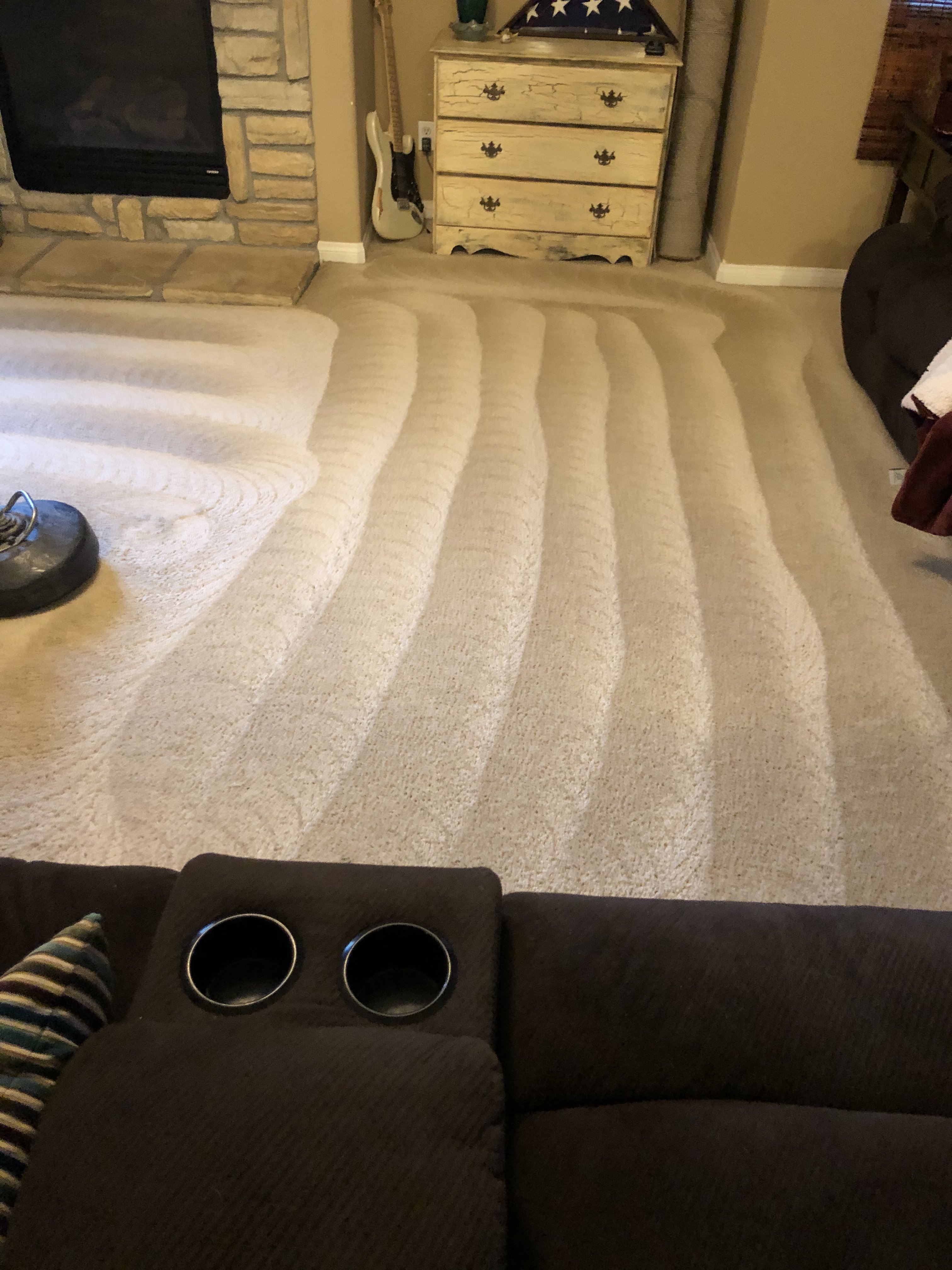

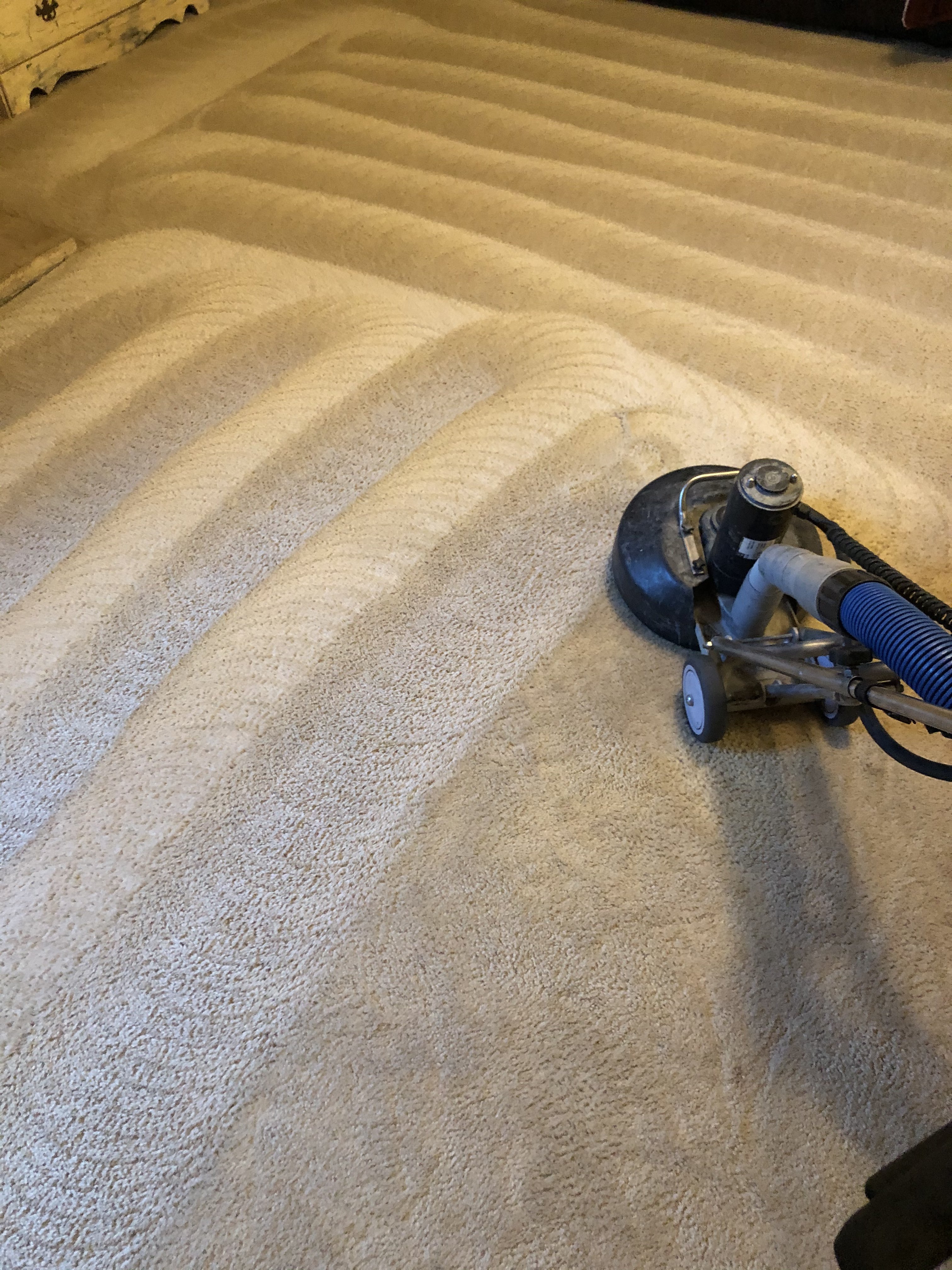

6 scoops ultrapac extreme, last step rinse. 10 inch crb black brushes or commercial brushes. Yeah that’s my 14 inch Dev with slot glides. And my dev filter got filled with stuff I shouldn’t have to see!
