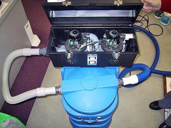

The hottest machine I ever used was a powrflite perfect heat, it used coils around the vac motors and then last step through an electric heater. The rest of the machine was crap. 5 gallons recovery going to a 15 gallon fresh tank, vacuums in series, a lot of other things that weren't right.
I ended up getting a kleenrite heatrite 2 with 3250 watts of heat and after changing out the 180 degree thermostats for 220, my heat was pretty good. The only downside was 2 separate circuits. My machines always took 2 circuits, so Mr. AMPS was a concern. You get to accept the limitations of electric powered equipment.
Again, look at the mytee website and consider the machine with the General pump. It maxes out at 1000 psi so that would give you more than enough pressure for hard surface cleaning. The posted vacuum numbers are good for a balanced electrical machine. I'll see if I can find some pics of my vac boosting days.

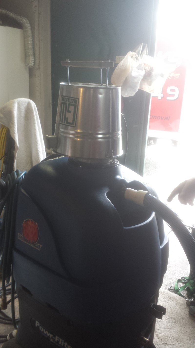

so i found the extractor my boss lost- it was in the building next door to one im currently working in this whole time. anyway, its a powrflight pe200. im actually liking it a whole lot. also a 2 circuit siuation, so i see what you're saying. seems like very reliable piece of gear
