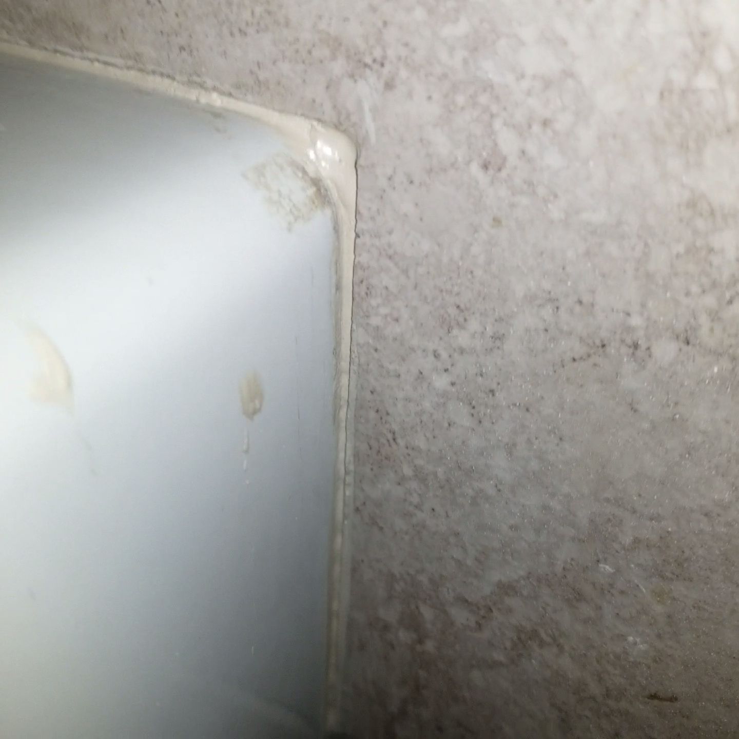

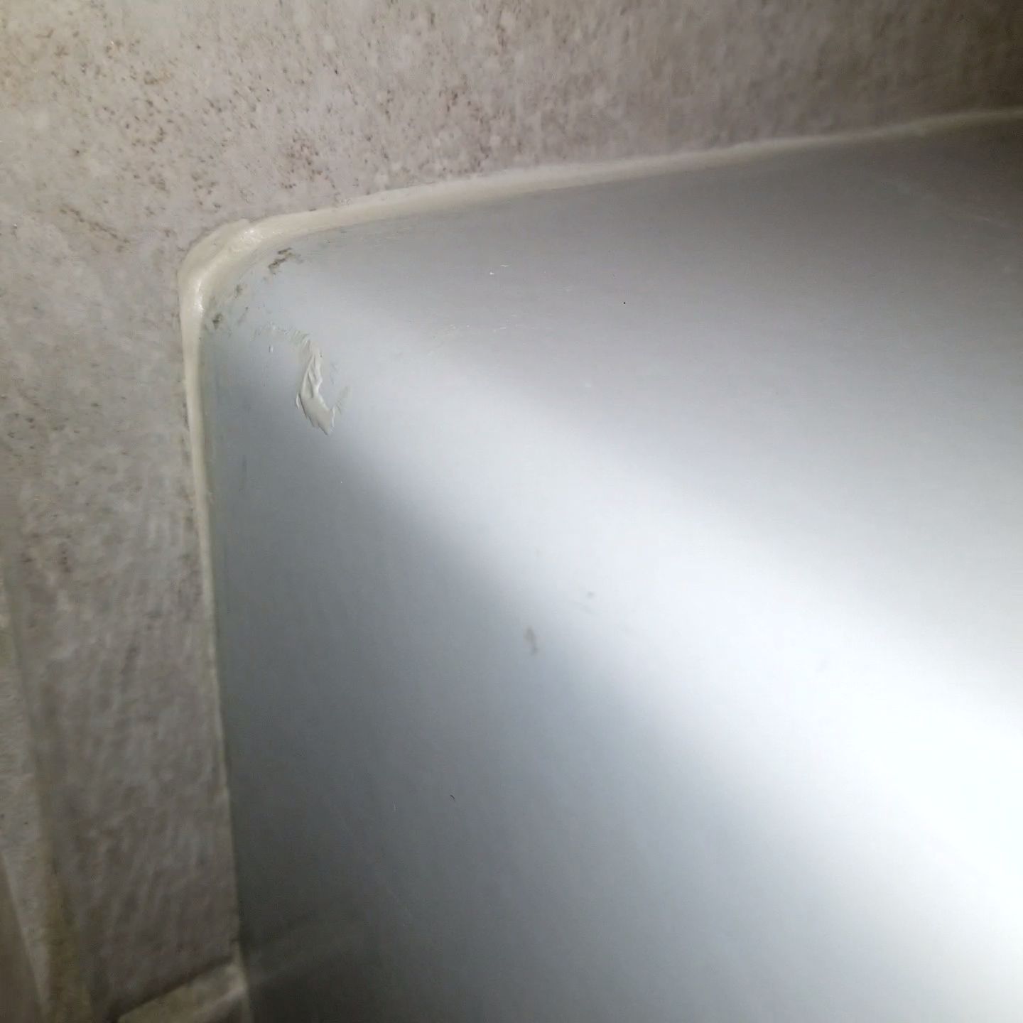

Those are the after shots?
I would have picked a different color...
Yeah, Brandi realized that. She was trying to match grout color. I kept saying that it needs to be darker. Standing from doorway, it doesn't look that bad of color..

Keep in mind due to the A component of the mix being white, most of the colors end up drying considerably darker
We had used albaster non sanded. How long does it need dry to get the best after pictures? 2 days? I can go back there tomorrow to take the photo. The homeowner says i can.

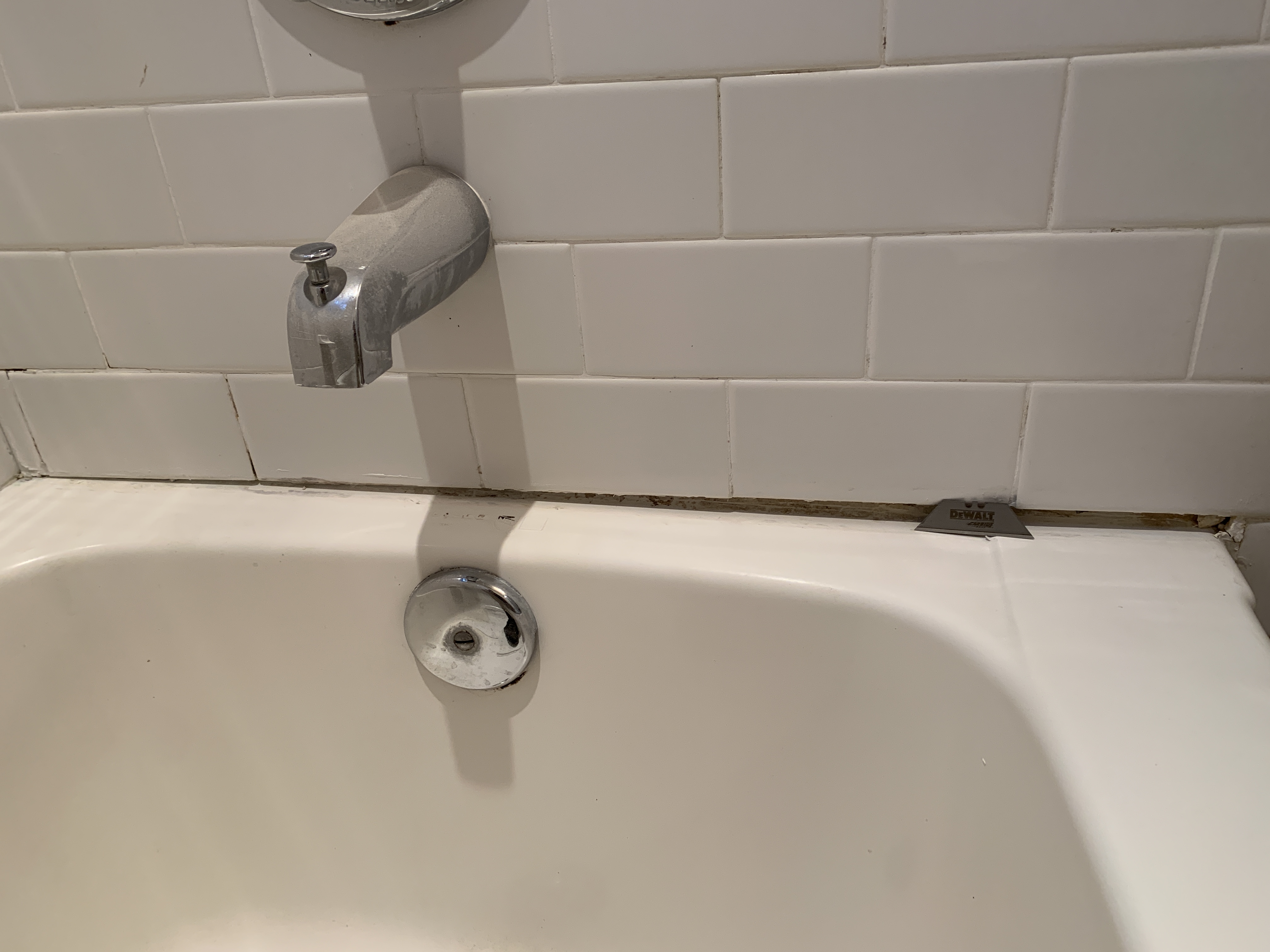

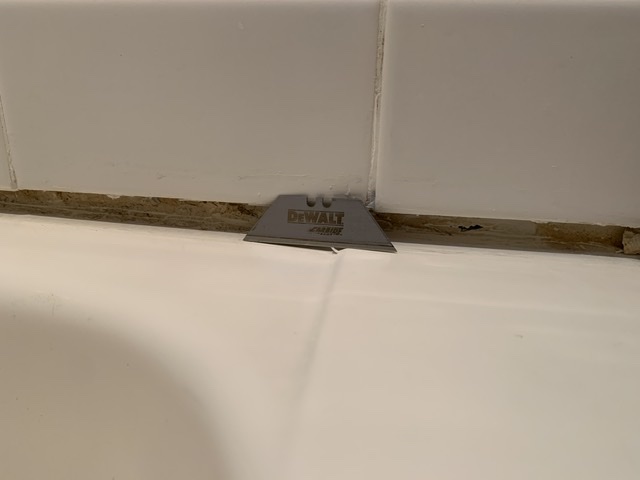

Is heat effective for removing epoxy grout such SGA? Heat gun or solder iron equivalent?
Close to end of video. I wonder if heat gun will assist in wall joint such countertop or sink to make easier use of razor.
116,029
Dont confuse epoxy grout with Super Grout additive

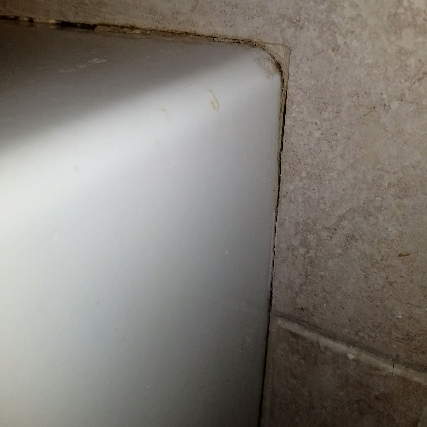

Looks good overall and owner is super happy with. But you are right about color. 1 or 2 shade darker would be better. It looks brighter from standing viewpoint. Up close, it match with the unaffected grout up top of wall. Brightness is because of how shiny it is. Be nice if it was more matte.
