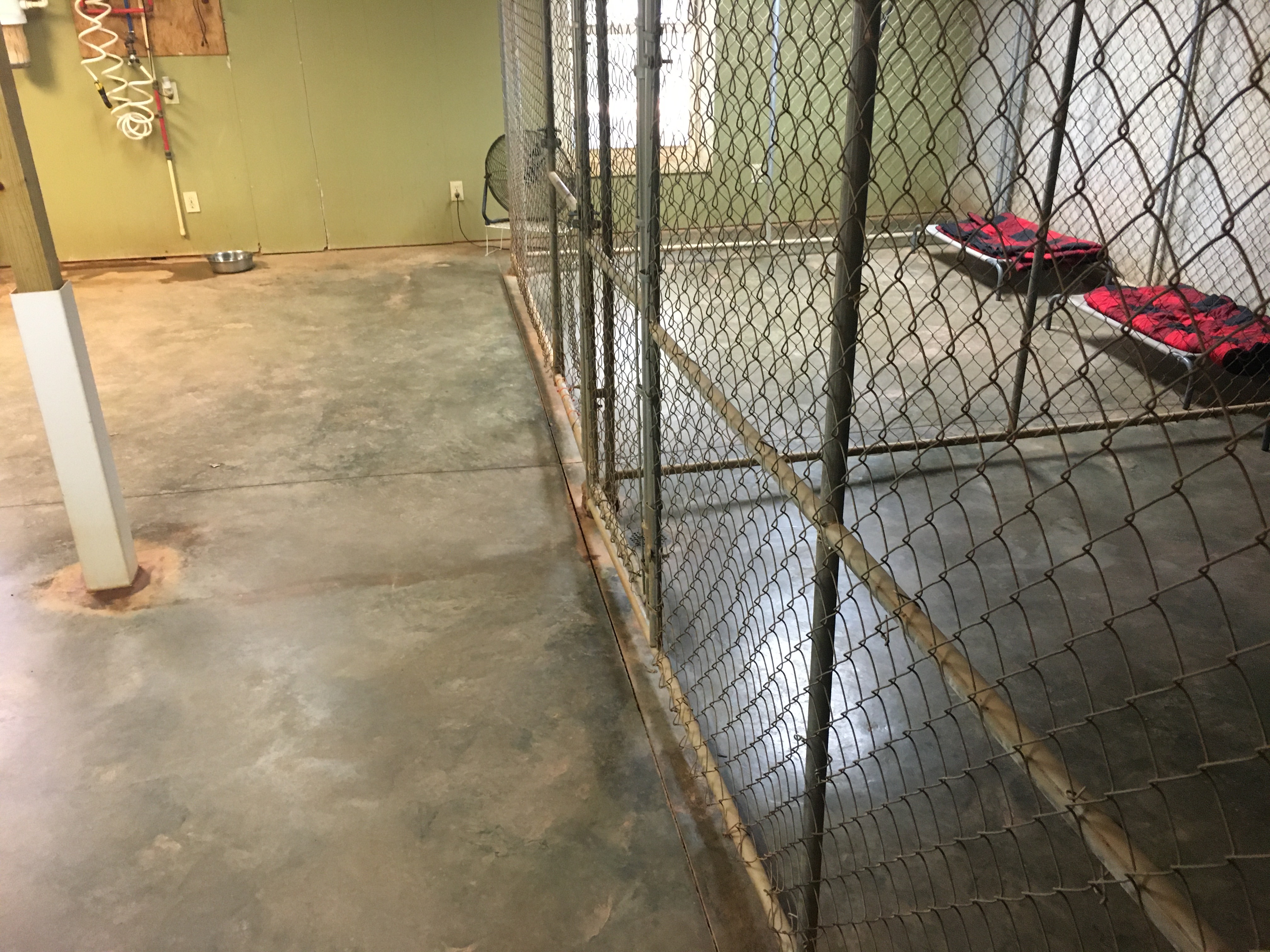

I know it'll be impossible and the homeowner knows it to. She's running some dog business out her home and this is in her basement. The room I was standing in was the other half of the basement which is a normal living area with a living room and bedroom. I'm thinking she's just wanting to get the smell under control. So they won't smell it in the living area
Is there a chance I could damage the surface of the polished concrete with etching it if I treat it with an acid rinse or an acid tile cleaner?

I’d strip it like VCT, rinse with a truckmount after vacuuming the slurry, then mop down Odorcide or a similar product.
That dog oil is going to be more like a wax, less like an oil, from time, pressure from foot traffic, and being cold on the floor. The smell is going to be in the pores of the concrete at this point so it could take two visits.
