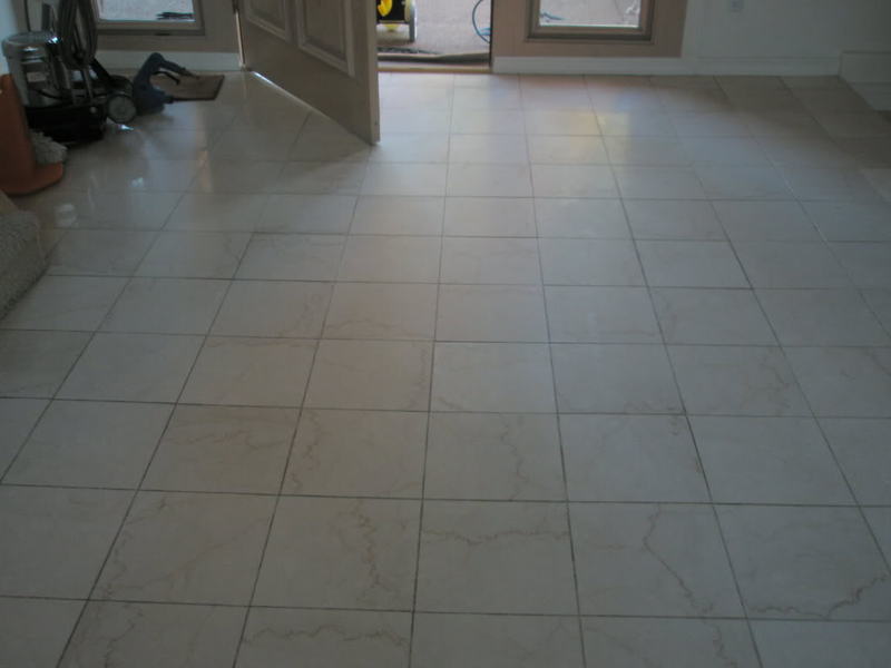

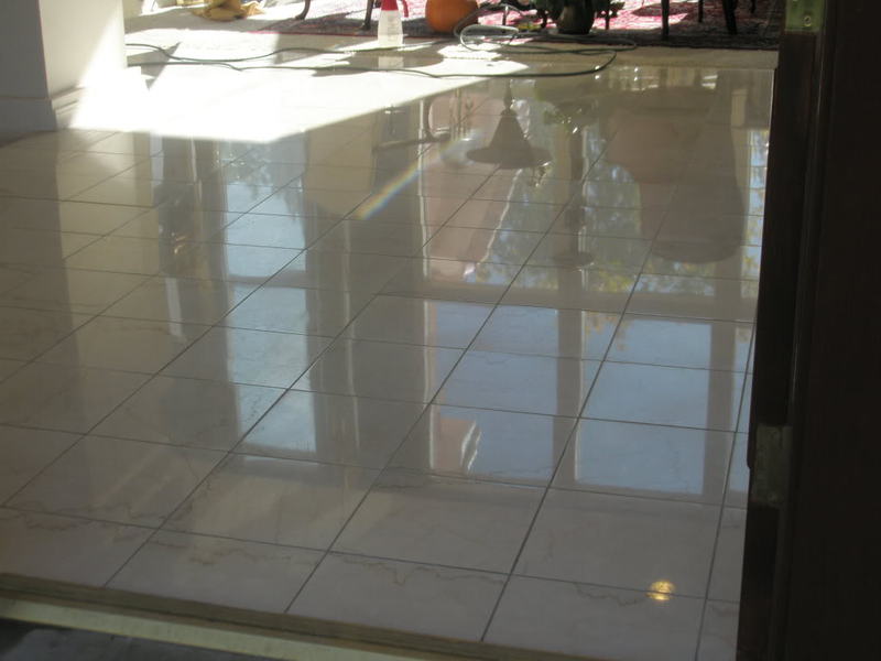

now wait just a minute. I have been using these pads for a year now a have had great results. I explain that it will not take care of lippage but it will make the floor super shinny, and thats what they want. To tell me they dont work is bs, you stone premadonas just kill me.
Get this IT IS ALL ABOUT THE ALL MIGHTY $$$$$$$$$$$$$$$$$$$$$$$$$$$$$$$$$$$$$$$$$$$$$$$$$$$$$$$$$$$$$$$$$$$$$$$$$$$$$$$$$$$$$$$$$$$$$$$$$$$$$$$$$$$$$$$$$$$$$$$$$$$$$$$$$$$$$$$$$$$$$$$$$$$$$$$$$$$$.

I wish there was enough rock around here to justify thousands in training and thousands in diamonds. Some day I might invest in that old school way of thinking, but probally not.

sorry Ron but I'm not impressed, you could have done better if you were doing it the right way. Go to my website and look at the home page, look at the clarity on that travertine, that was done the correct way -RESIN DIAMOND PADS.

have you ever used resin diamond pads or powders? I can tell it's all about the $$$$$$$$$$$$$$$$$$$$$$$$$$$$$$$$$$$$$$$$$$ by looking at some of yer pictures
