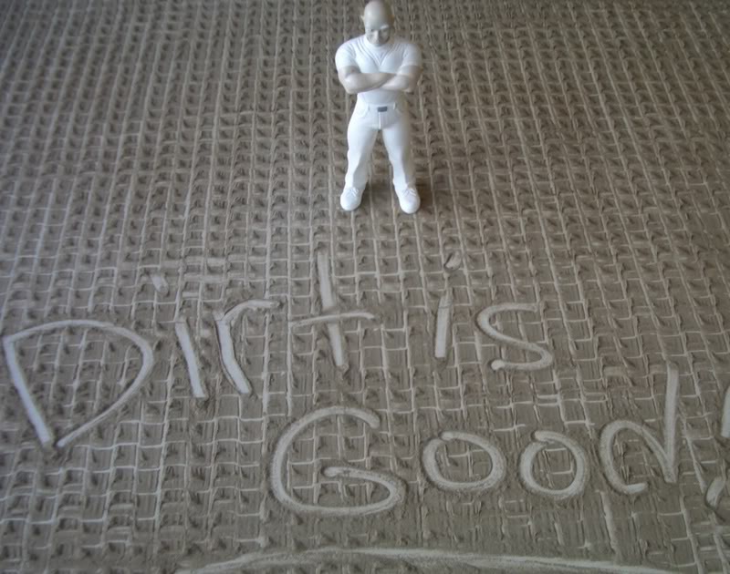

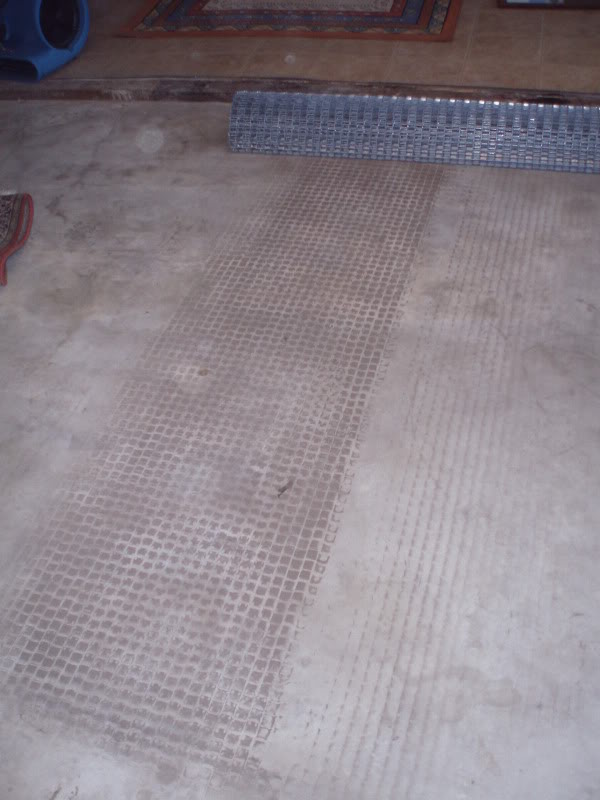

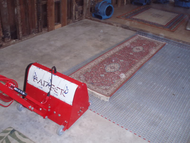

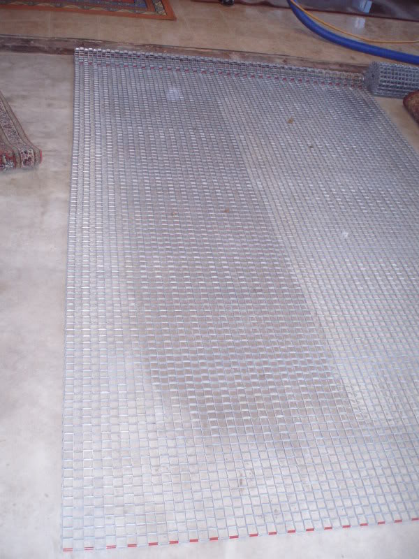

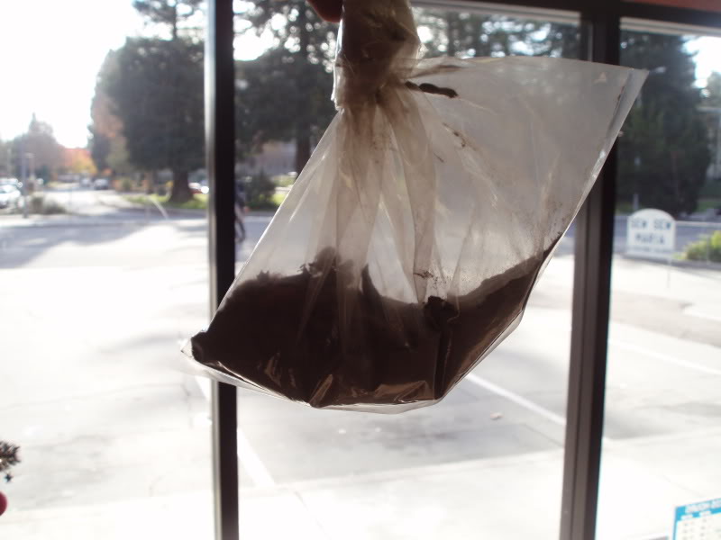

I used mine for the first time yesterday.
2 by 7 wool runner. Didn't really look that soiled at all.
We Sanitaired it front and back then ran the Rug Badger over it for about 3 minutes.
So much dry soil came out the first time that I swept it up and did it again...
In the end this came out of a "clean rug"..

Yea it's pretty amazing.
When we first got our we pulled a few rugs off the clean rack and hit them with the badger and showed the guys how despite being cleaned by us there was still soil trapped in the rug.
Love the badger!
G
I have used and yes it always gets more out than extraction can. Guess that is why they call nonwater-soluble contamination. Better than a vacum on the back of the rug or hitting w/stick.
