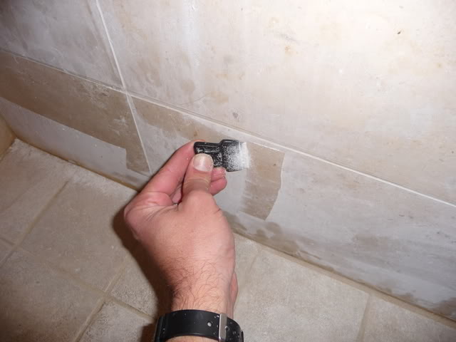

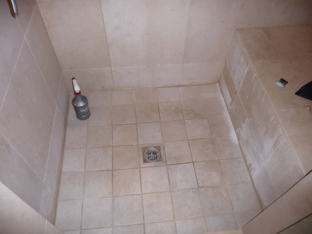

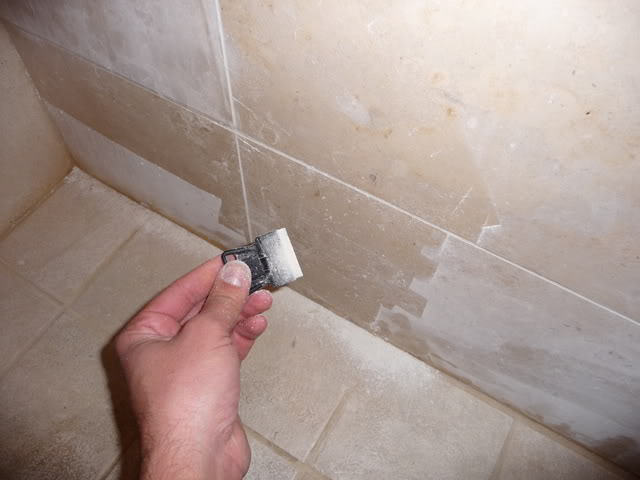

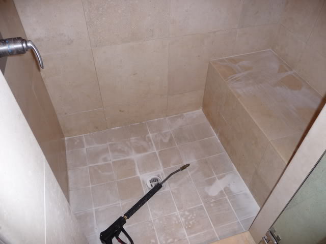

Get up the nerve to look in their shower and al0ng with a razor, some Magic Al's Non Acid Soap Scum Remover and a HF gun you too can be a hero.

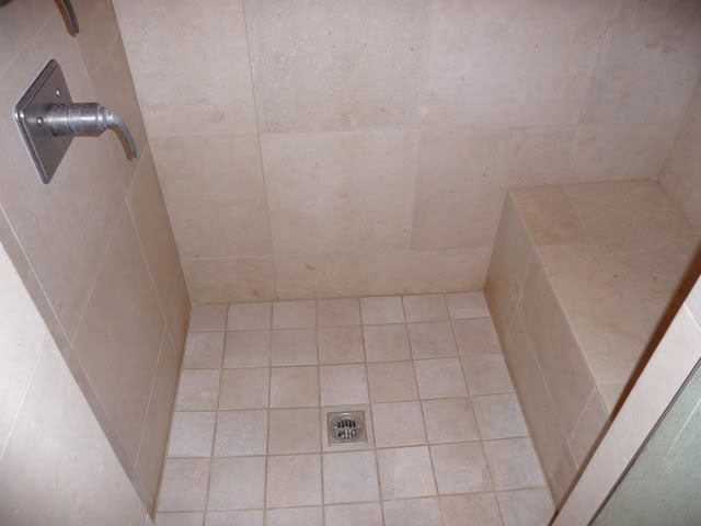

I charged $175 to just clean this one. Hubby will seal it. took under an hour.
The Shampoo bottle are is always the worse.
Some of the scum comes off in sheets it's so thick.
Some Peroxide based cleaner to get to the mold
and there you are.
Still a bit wet in the corners..

Looks good!
What about the stainless fixtures?
A little polish and some 0000 steel wool and those would shine up nicely. Charge an extra 25+
