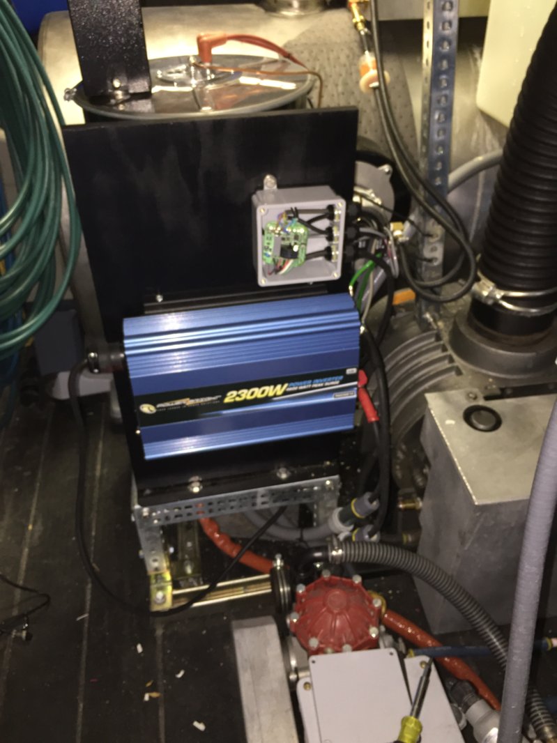

I have the inverter running off the Isuzu diesel running the Aerotech.
Yes Ron, that was what I was saying. I think most vehicle alternators have significantly more available electrical power than most slide in motors. Your setup I am sure is smokin hot when you turn up the heat....

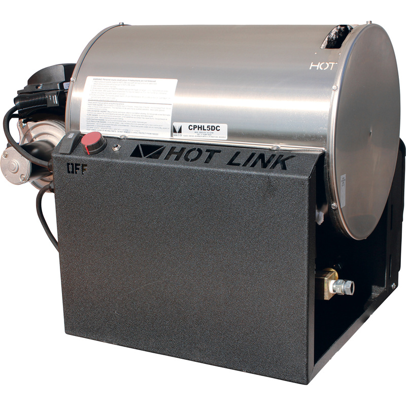

I have a hydrotek inline diesel heat. I actually wanted to use this with my Prochem legend for bigger areas and larger tools 12+flow.
Would you know if I can simply hook up to water from Prochem? Or would I have to dial down thermostat to prevent incoming overheat? I believe the guy at Nilfisk said inlet water temp should not exceed 180F

The 180f is for the flow switch. You can mount that before the pump and run longer wires to the burner. If you dump into a fresh water tank dont worry about it and keep the prochem around 150f. If you dump into the waste tank I would move the flow switch, it will last longer too with cold water.

So I'll turn off heat completely to Prochem and inlet temp to Hydro Tek will probably be 140 (that's what it measured with heat turned off)
To offset the water dump into waste tank(no freshwater tank) I guess I could hookup inline@ 50' Mytee AirHog with 3.5gpm pumpout on.
I do have the lowflow switch on hydrotek can get steam @4flow with porty 1.5gpm pump. But when I run 12+ flow hydrotek really works and I believe it would be a definite upgrade with Prochem on larger tile/neglected carpets.
The issue with incoming 140f water to hydrotek is that I'll blow the relief valve?

The relief valve is downstream. No problem running up to 170 or so into the fire breather. The hotter it is going in the less the prochem will dump. With high flow tools it may not dump at all or very little. I bypassed the heat exchangers on both my trucks, cds and slide in, and just run from the pump to the burner.
