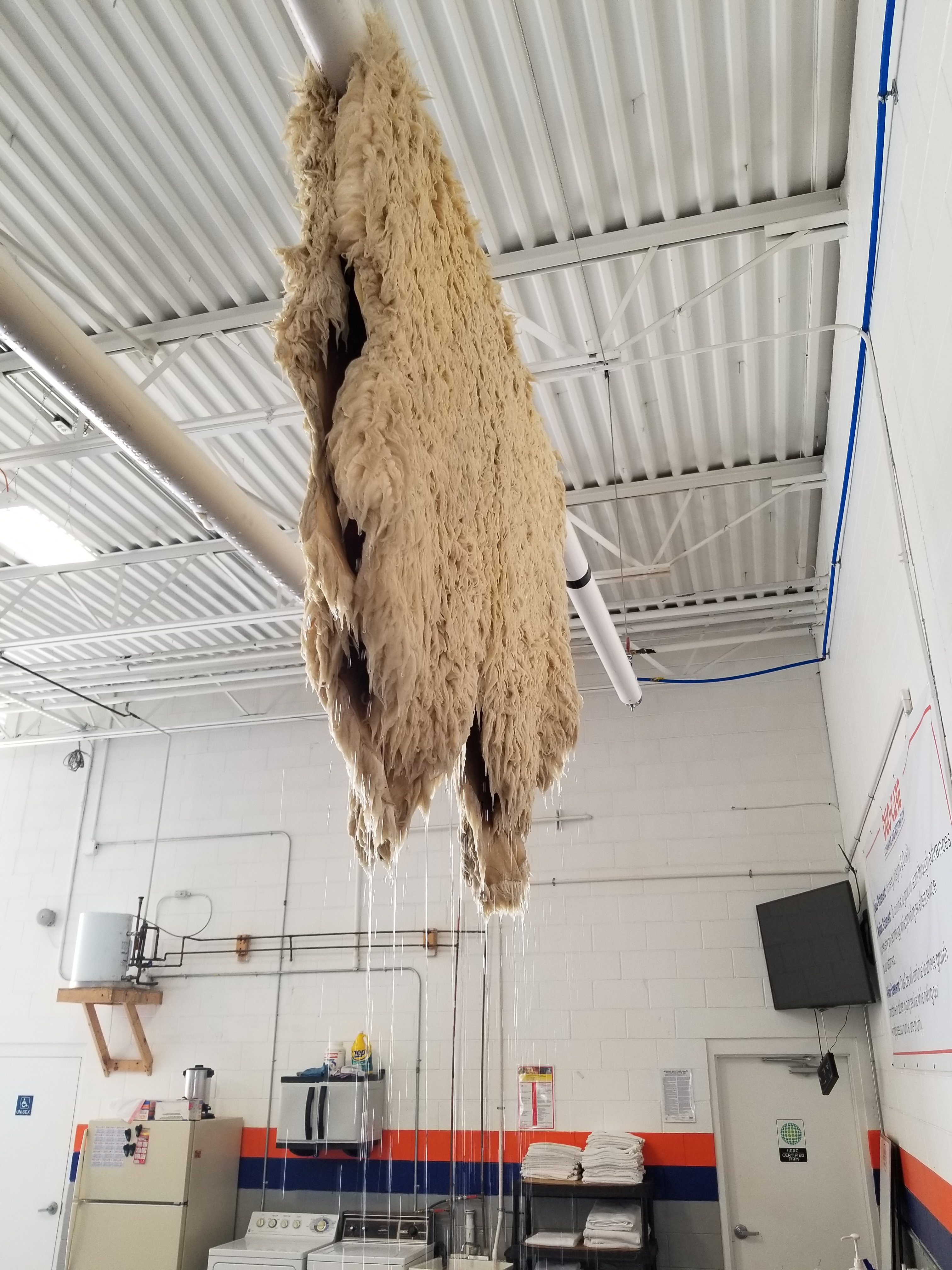

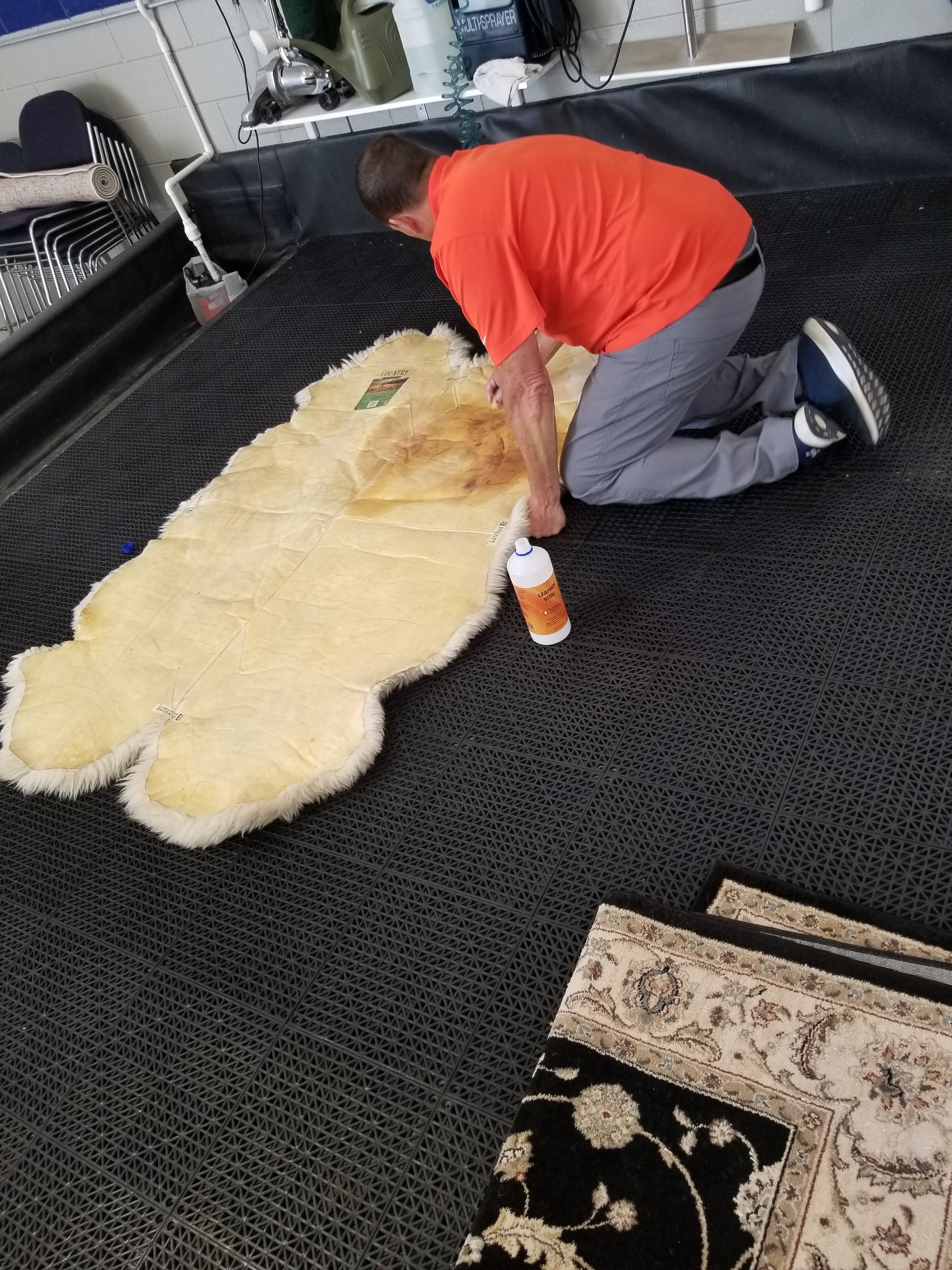

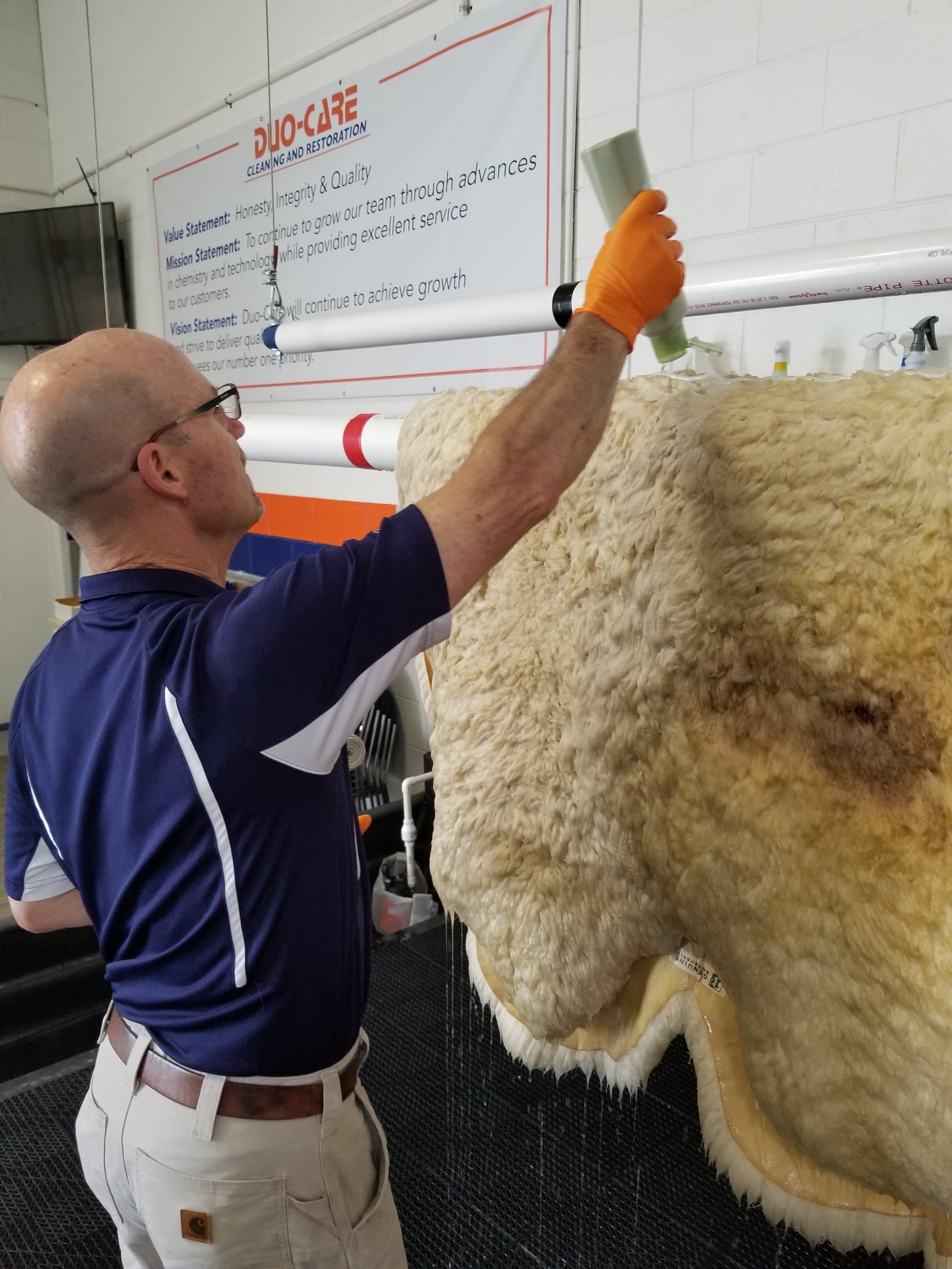

Sheepskin cleaning made simple.
T Monahan
Sep 9, 2012
1,673
Ann Arbor, MI
Tom Monahan
Reactions: Hack Attack
27,866
I brush and vacuum first, then prespray using a fine fabric prespray, extract using an upholstery tool, removing all excess moisture, then dry on a rack. Then examine the Hyde and condition as needed with leather condition agents.

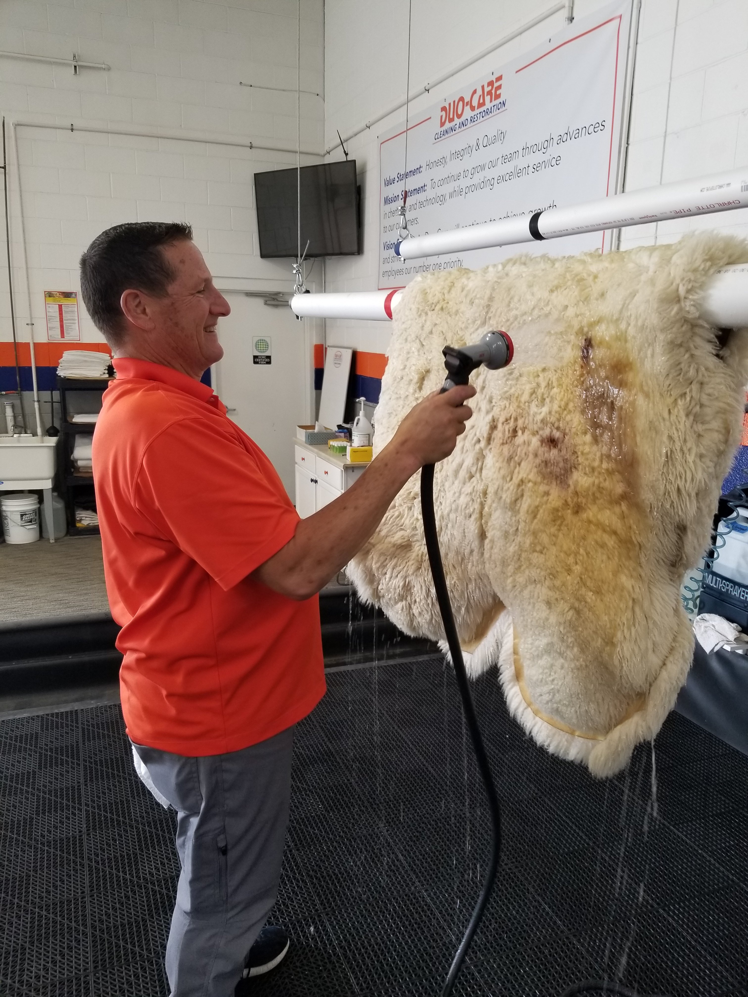

Top cleaning with a rinse and vacuum tool will not deep clean a soiled sheepskin. It needs a full wash. It's simple as described above. Brushing will most likely distort the natural lay of the natural yarn and make it wispy. This could be most undesirable.
27,866
We massage our products in by hand. I just feel an extraction process is better than letting it drip dry.

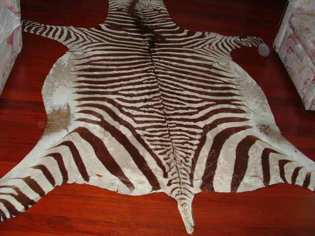

Tom, how would you go about cleaning this.
It had several fabric patches sewn onto the rear where it had parted. 🤔
I restored this one probably 15 years ago.
Thanks.

I got asked to do 2 like that from a taxidermist while I was doing his carpet
the seam/repair underneth had left a green stain on the carpet, I declined cleaning the skins

What caused the yellow in the first place?
A good wash and rinse, followed by working in a hair conditioner and rinse, would not cause a ph issue or yellowing.
